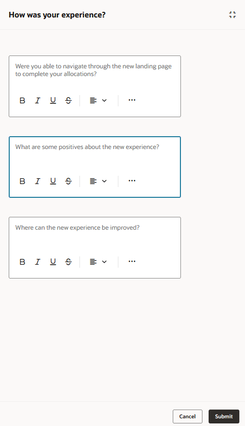

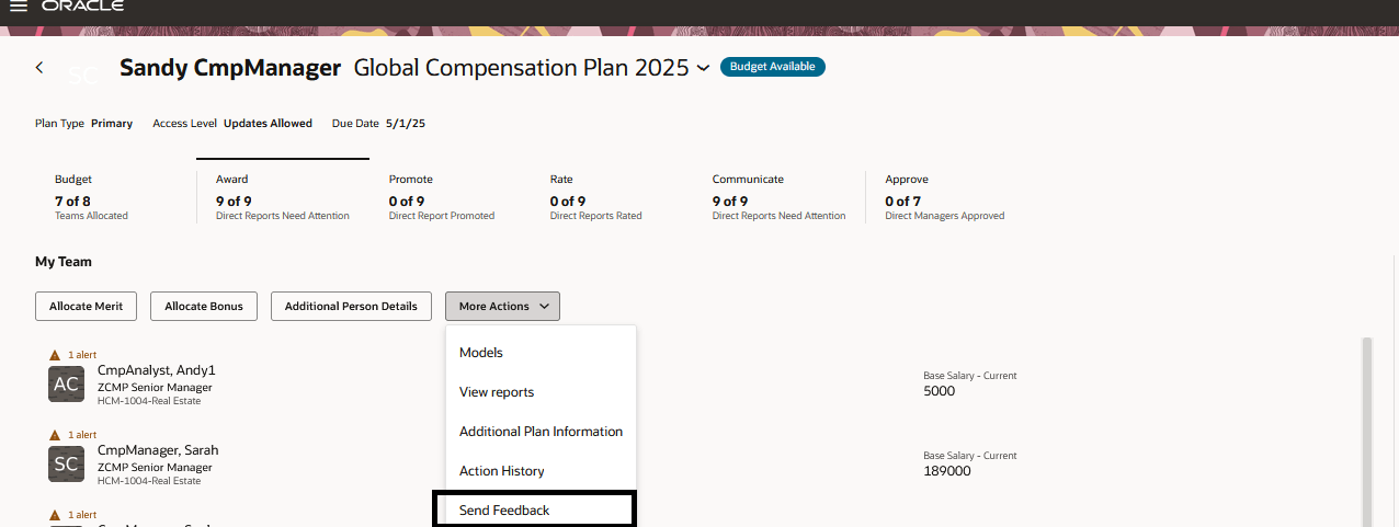

You can now let line managers use the Feedback Survey pages re-created with the Redwood toolkit, when you enable the Redwood experience. The Feedback Survey is now available for all plan configurations, not just those that use the submit feature.
Feedback Survey Location
Feedback Survey
Feedback Survey
With this change, managers can provide feedback about the compensation cycle even if plans are not configured to be submitted for approval.
