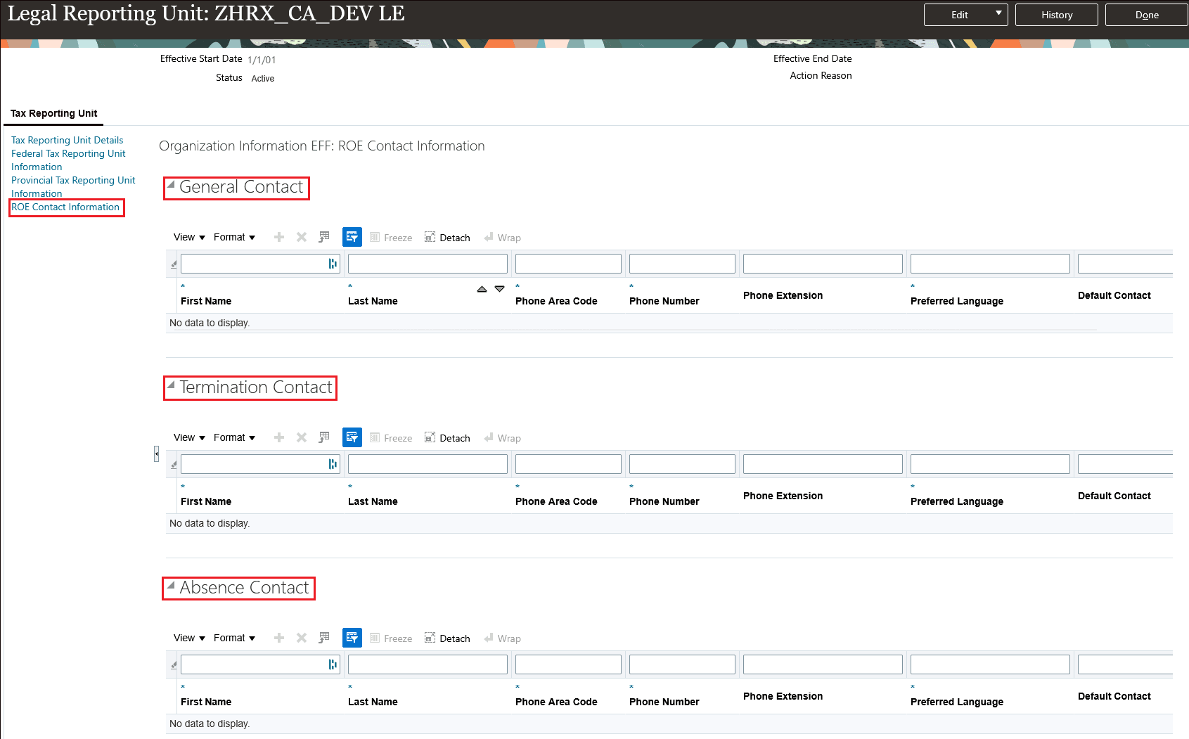

Configuring ROE Contacts at the LRU
Previously, the ROE contact was configured at the LRU using the Manage Contacts page by attaching the legal role of Record of employment contact.
Instead, you can now configure all ROE contact types directly on a new page dedicated to ROE contacts at the LRU level. Access this through the Manage Legal Reporting Unit HCM Information task. On this page, you can:
  • Create and manage all ROE contacts for the LRU
  • Designate a default contact for each type
  • Set the preferred language for each contact
You must create all ROE contacts at the LRU level, with one designated as the default, for each contact type.
This image illustrates the ROE Contact Information page to configure the new types of ROE contacts.

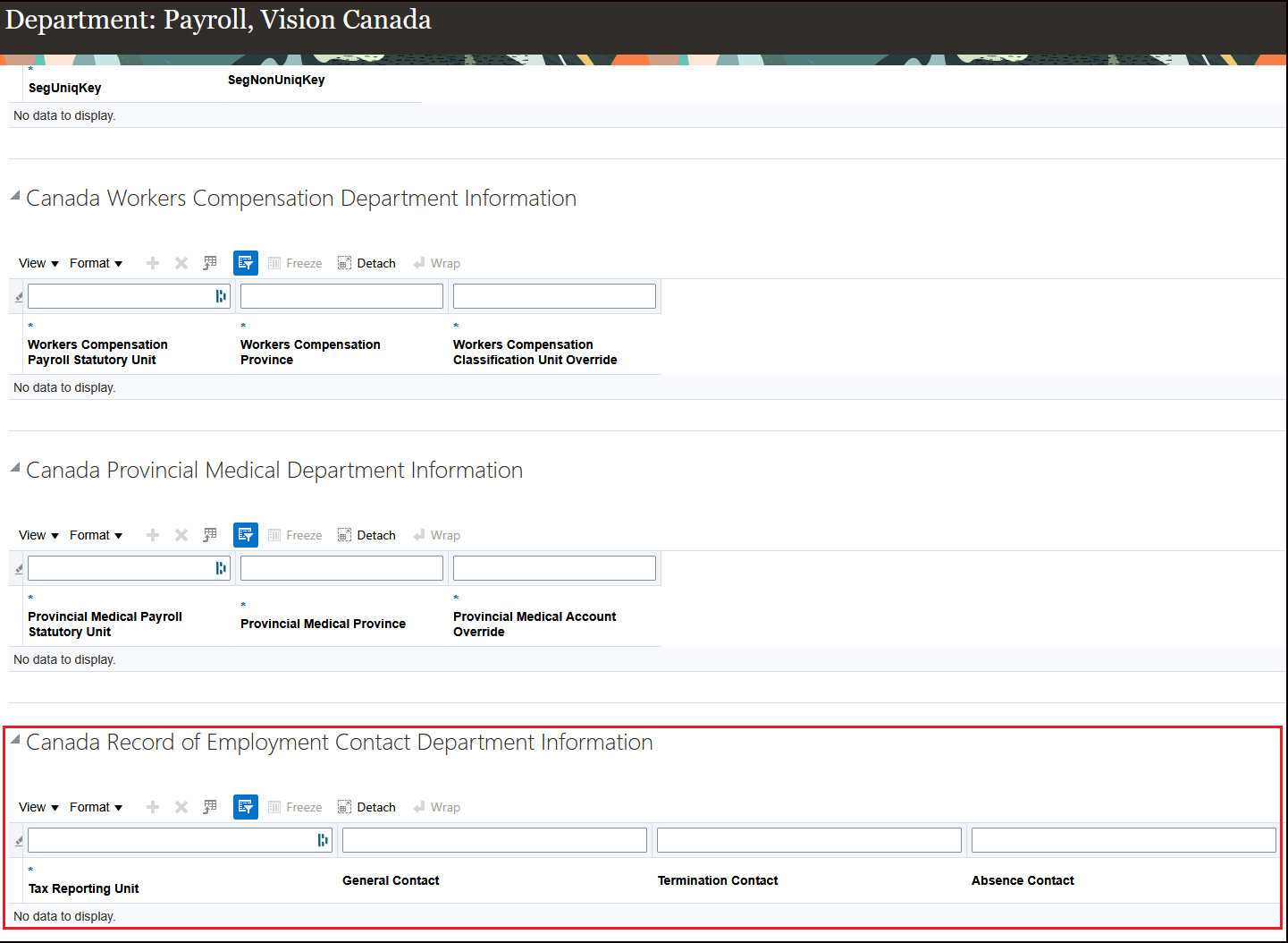

Configuring ROE Contact Overrides for Departments
To provide even more flexibility, you can now override LRU defaults by setting department-level ROE contacts. Only ROE contacts previously created at the LRU level are available for selection as overrides at the department level.

Use the Manage Departments task and complete the Canada Record of Employment Contact Information section for each department as needed.
This image illustrates the new Canada Record of Employment Contact Information section used to override the default ROE contacts.

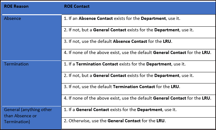

ROE Contact Hierarchy
The rules below determine which ROE contact is used, based on the type of ROE processed and the configuration at both the LRU and department levels.

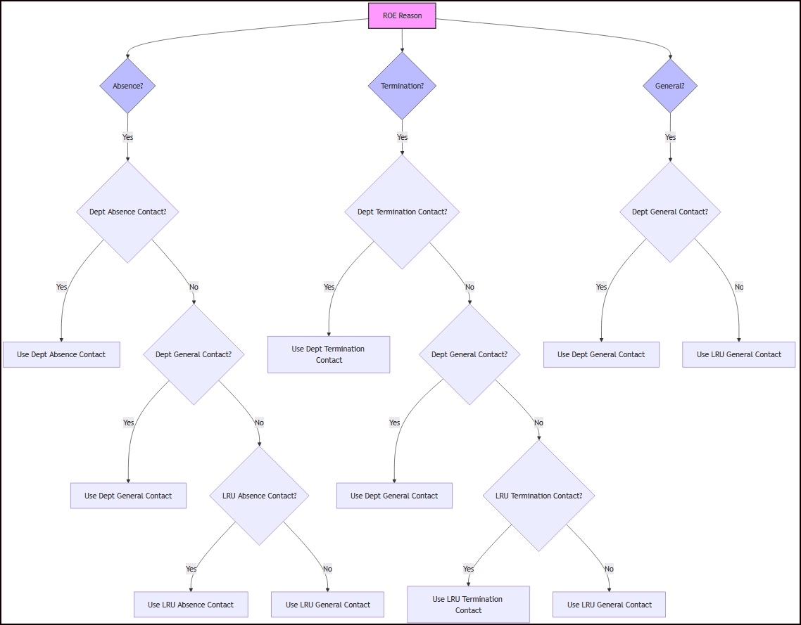

The image below is a graphical representation of the same information in the table to help illustrate the hierarchy.
ROE Contact Hierarchy Condition Diagram

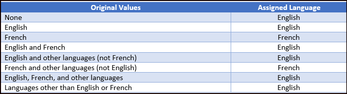

  • For Preferred Language, see the following table for the values assigned to the new record.
Preferred Language
