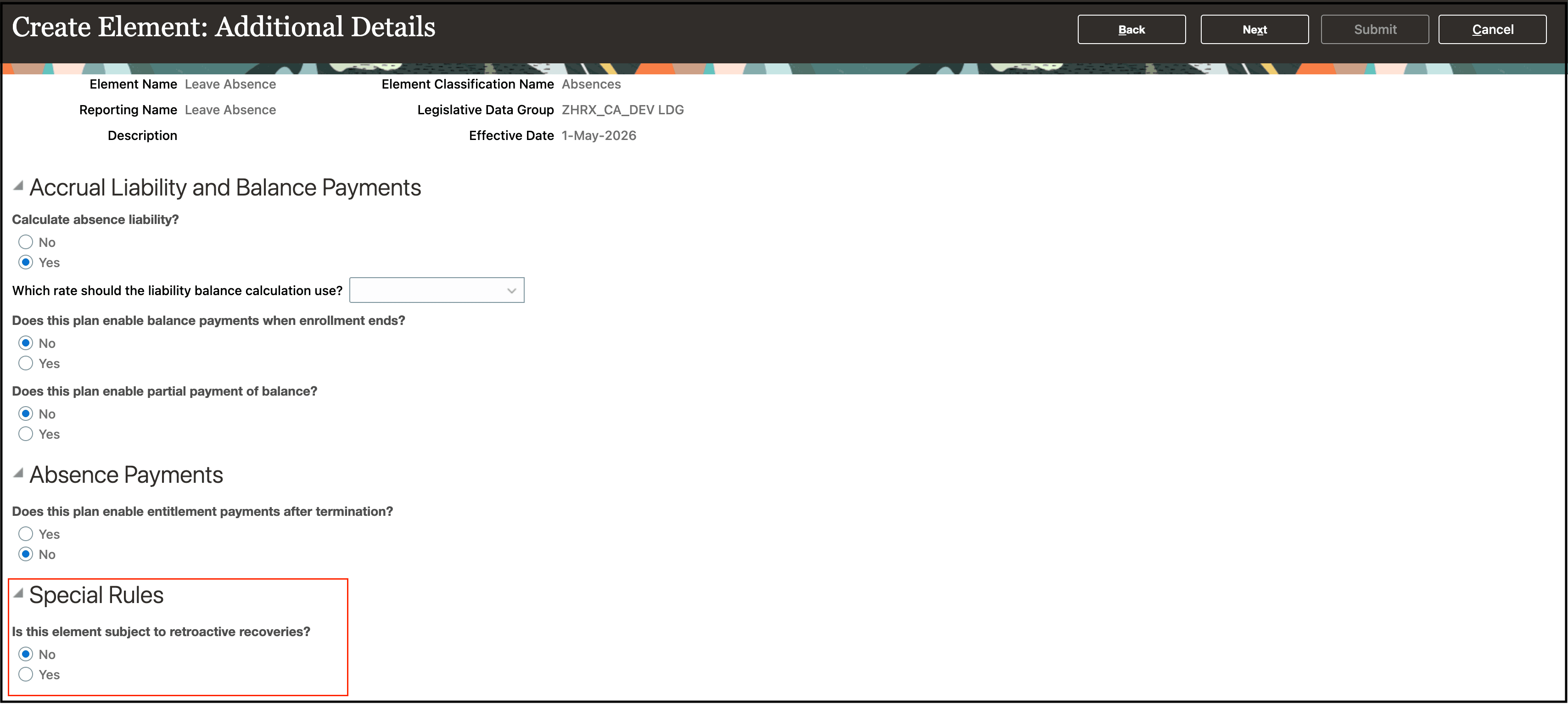

This image illustrates the Element creation page showing the new template question.
Element Template question: Is this element subject to retroactive recoveries?
