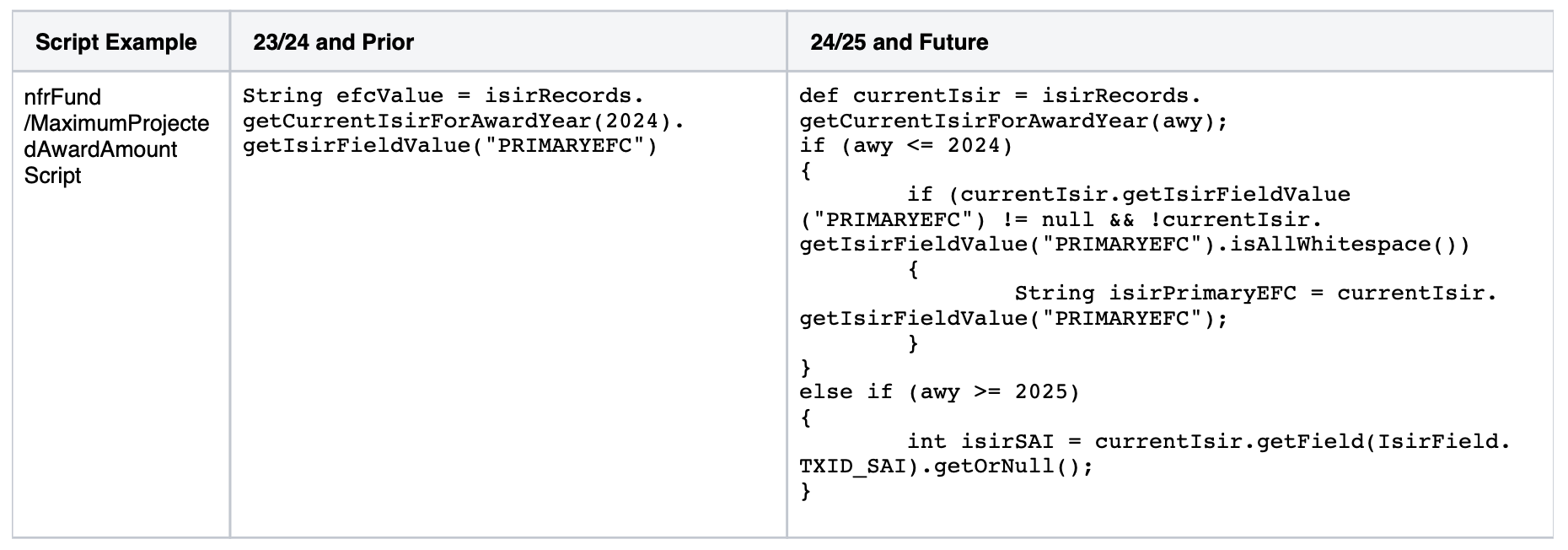

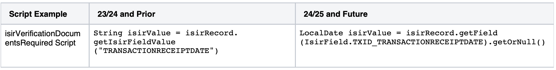

Configuration that has direct access to the ISIR record:
When a script is being used and the ISIR award year is unknown (ie a 24/25 COA or NFF fund is being projected but the student may only have 23/24 ISIR):

- Example: using isirRecord.getField(IsirField.STUDENTFTIM_ADJUSTEDGROSSINCOME_FTI).getOrNull() will return the value as an integer without CUI labelling
- In groovy scripts that need to access both 23/24 and 24/25 ISIR fields such as those used within packaging, you will need to identify the ISIR award year you are accessing within the script and conditionally use different methods to access the desired data.
