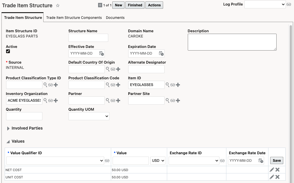

Before you can assign a trade item structure to a trade transaction line, you must have trade item structures configured in GTM. The trade item structure should contain an item, quantities, values and components. Each of the trade item structure components should contain an item, quantities and values. In this example, you have a trade item structure called 'EYEGLASS PARTS' containing 3 components: EYEGLASS LENS FRAME, EYEGLASS TEMPLE STICK, and EYEGLASS LENS. For EYEGLASS PARTS, note the quantity and value. If the Quantity and Quantity UOM are left blank, GTM assumes the quantity = 1 EA.
Example, trade item structure called 'EYEGLASS PARTS'

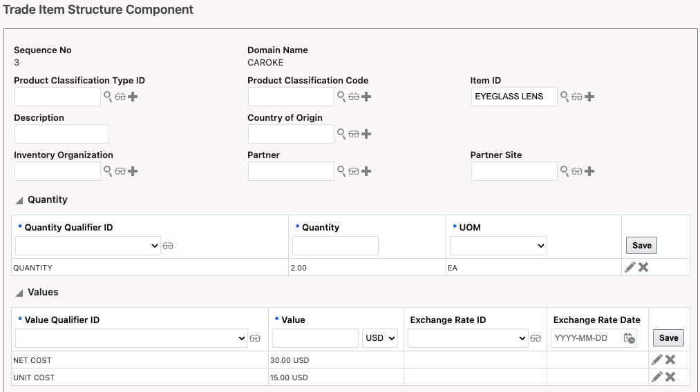

In this example, one of the components is EYEGLASS LENS. Note the Quantity and Values for the component.
Example, trade item structure components  EYEGLASS LENS

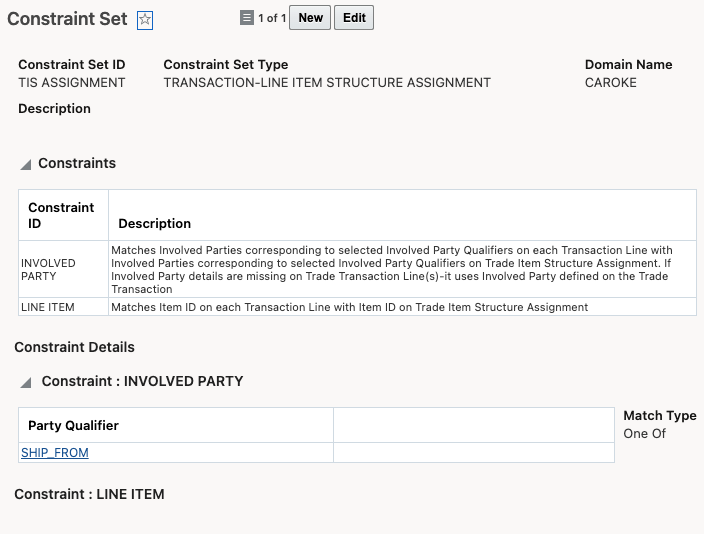

A constraint set is used to match a trade item structure to a trade transaction line during assignment. When creating a constraint set, the Constraint Set Type = TRANSACTION-LINE ITEM STRUCTURE ASSIGNMENT. Once created, you can assign the constraint set to the compliance rule. In this example, the constraint set is matching based on involved party and item information.
Example constraint set used to match a trade item structure to a trade transaction line

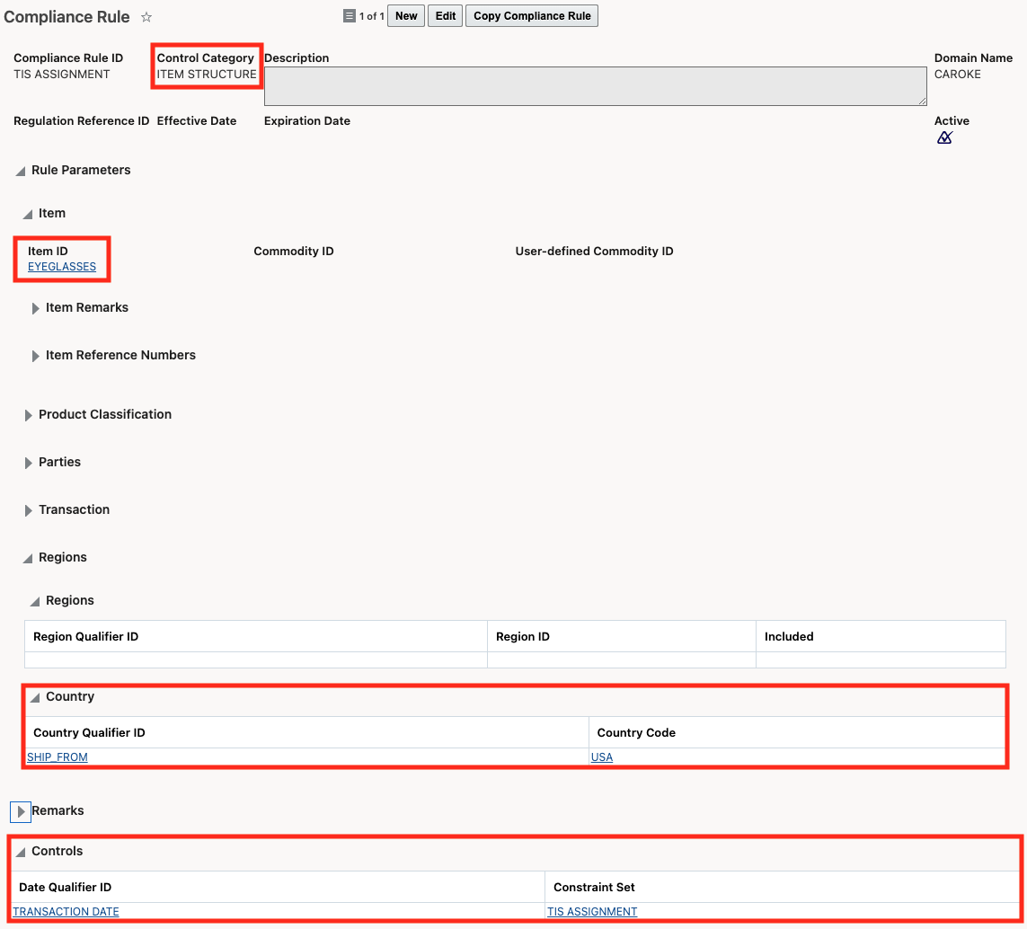

Compliance Rule Data
You can assign a trade item structure to a transaction line using compliance rules. When creating the compliance rule, the Control Category = ITEM STRUCTURE. On the Compliance Rule tab, enter the criteria you want to use to match the compliance rule to the transaction line. On the Controls tab, enter the Date Qualifier to be matched to the transaction/transaction line and the constraint set you created. In this example, the criteria to match the compliance rule is Item ID and Ship From Country. In the Controls, the Date Qualifier being used is TRANSACTION DATE and the constraint set is the one you previously created.
Example - Compliance Rule to assign a trade item structure to a transaction line using compliance rules
Once the compliance rule is created, you need to add it to a Compliance Rule Set. Then, add the compliance rule set to a Compliance Rule Set Group.

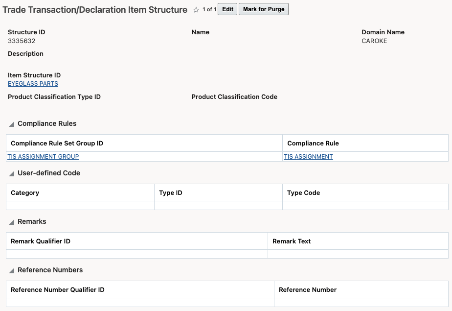

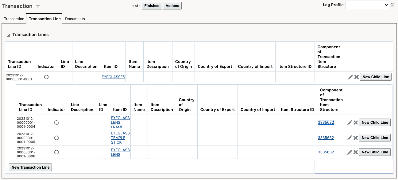

Once you assign a trade item structure to a transaction line, GTM assigns child lines to the parent line based on the components in the trade item structure. In this example, notice that the Item ID of EYEGLASSES in the parent transaction line is the same Item ID as on the trade item structure. The child transaction lines contain the same items as the trade item structure components.
Example - child transaction lines contain the same items as the trade item structure components
Notice that the Item Structure ID field on the parent transaction line is not populated with the trade item structure that is assigned. Instead, a Transaction Item Structure is created and each of the child lines point to it. Within the Transaction Item Structure, you can see the Compliance Rule Set Group and Compliance Rule used for assignment.
Example - Transaction Item Structure is created with child lines pointing to it, within Transaction Item Structure,  Compliance Rule Set Group and Compliance Rule are assignment
