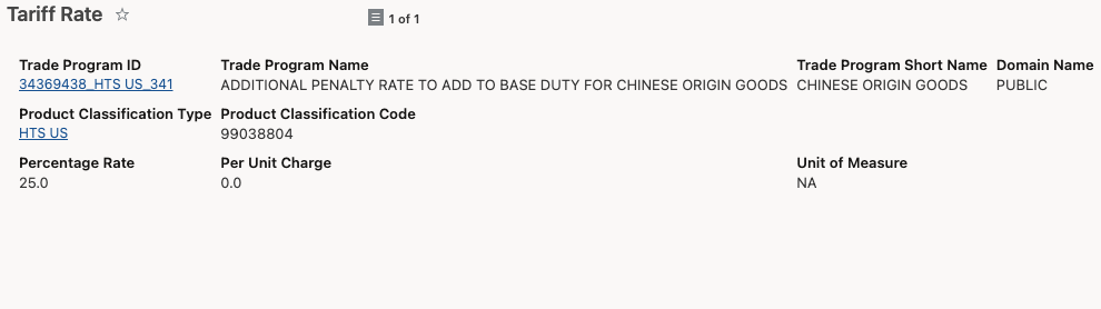

A new Trade Program Type of PEN+ has been added to indicate where an additional duty is added to an existing duty. Trade Programs have also been updated to support this Trade Program Type. On the Trade Program, you can see that this is an additional penalty duty rate added to the general duty rate when importing from China (CHN).
Penalty Tariff Rates
Tariff Rates have been updated to clearly identify where an additional penalty rate applies and the percentage rate.

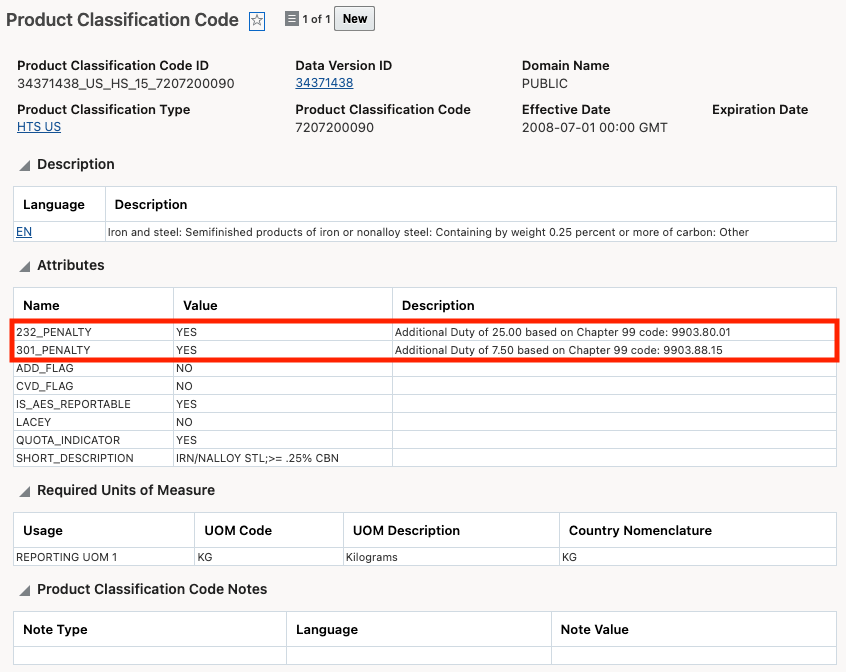

New Penalty Attributes on Product Classification Code
On HS product classification codes, two new attributes have been added to identify if a 232 Penalty or 301 Penalty apply. The description provides more details about the duty and the corresponding classification code. If you subscribe to classification data where the tariff supports these penalties, these can be modeled by your third party content provider and downloaded into GTM. The new attributes are:
- 232_PENALTY with Values of YES or NO
- 301_PENALTY with Values of YES or NO

- As with other attributes on your product classification code, you can create a compliance rule with the following configured:
- Populate the Product Classification Code Attribute section with the details of these penalties
- Populate the Country Qualifier and Country Code with the importing (SHIP FROM) country
- When the compliance rule is triggered, GTM can hold a transaction line if it contains this information, enabling you to hold a transaction line and review it prior to shipment.
