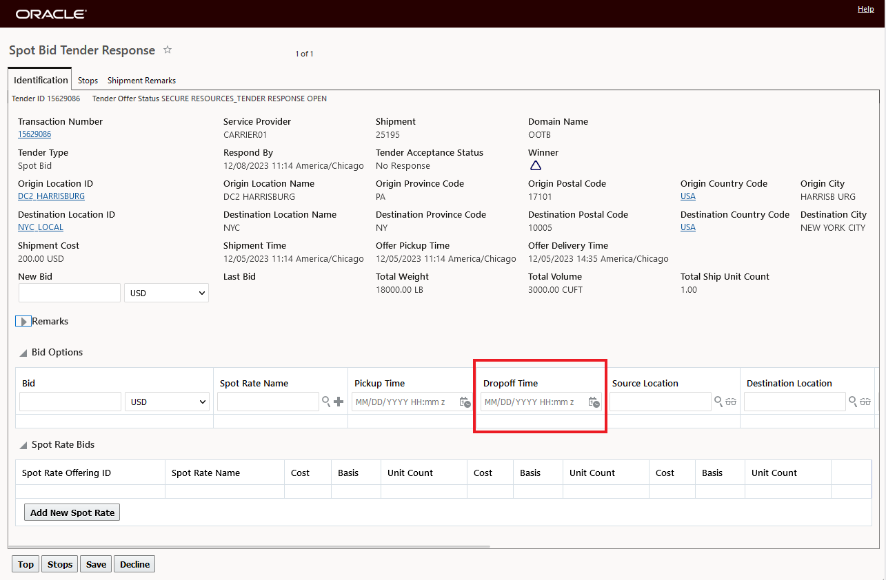

The Dropoff Time field has been added to the Bid Options grid on the Spot Bid Tender Response screen as shown below.
The Dropoff Time time zone is determined by the time zone of the Destination Location on the shipment. Note, the Dropoff Time field is only provided for two stop shipments - one Pickup and one Delivery..

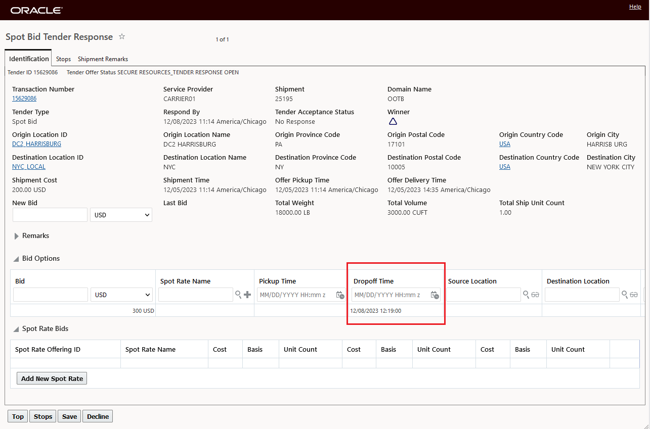

In the example below, the Dropoff Time has been entered for December 8th at 12:19:00, which is several days after the Offer Delivery Time of December 5th at 14:35.
Dropoff Time Entry

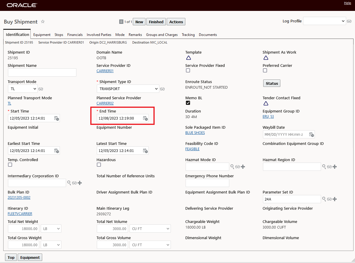

With the property - glog.server.workflow.tender.redriveOnPickupChange - set to true, the default, once the Optional Bid is accepted, the Shipment End Time is updated to the entered Dropoff Time, as shown below.
Shipment End time Updated

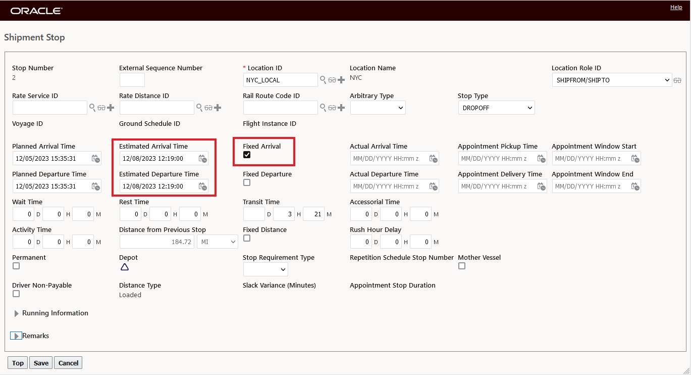

The Estimated Stop Times are also updated on the Destination Location Stop to the Dropoff Time as shown below, and Fixed Arrival flag is also checked.
Destination Stop Times

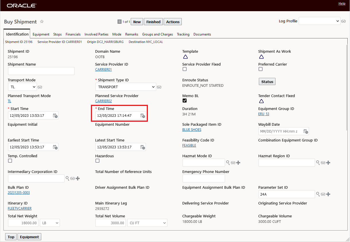

With the property - glog.server.workflow.tender.redriveOnPickupChange - set to false, once the Optional Bid is accepted, the Shipment End Time will not be updated - as shown below.
Property Set to False - Shipment End Time Not Updated with False

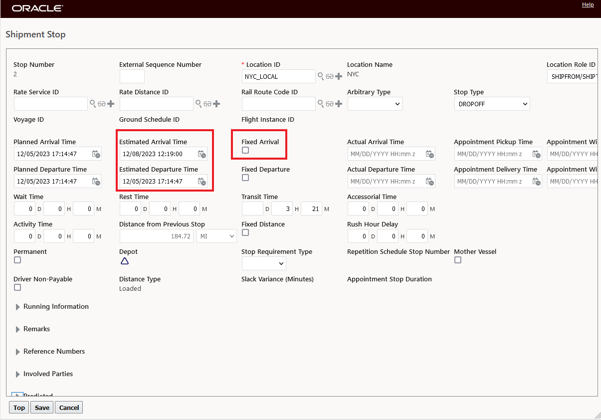

The Estimated Arrive Time is updated to the Dropoff Time, but the Estimated Departure Time is not updated and the Fixed Arrival flag is no longer checked.
Property Set to False - Stop Updates
