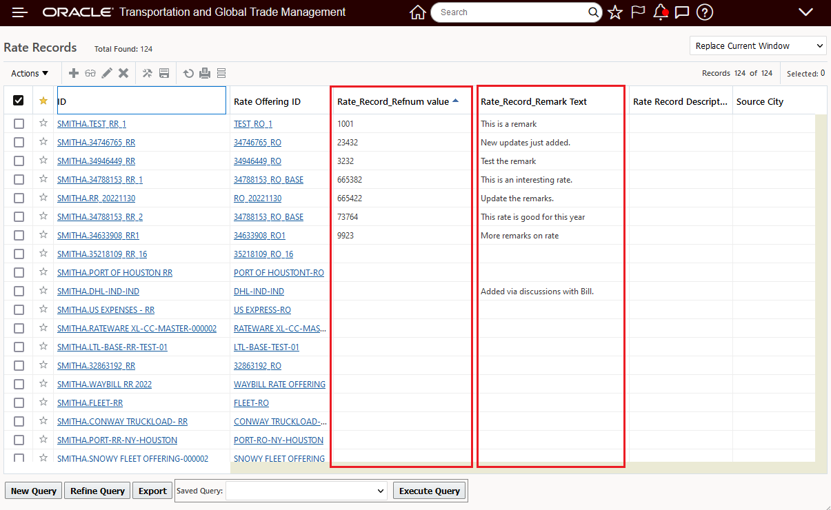

In the example below, both the Reference Number and Remark Fields have been grid flattened and added to the Screen Set.
Rate Record Finder Result Grid Flattened Fields Reference Number and Remark

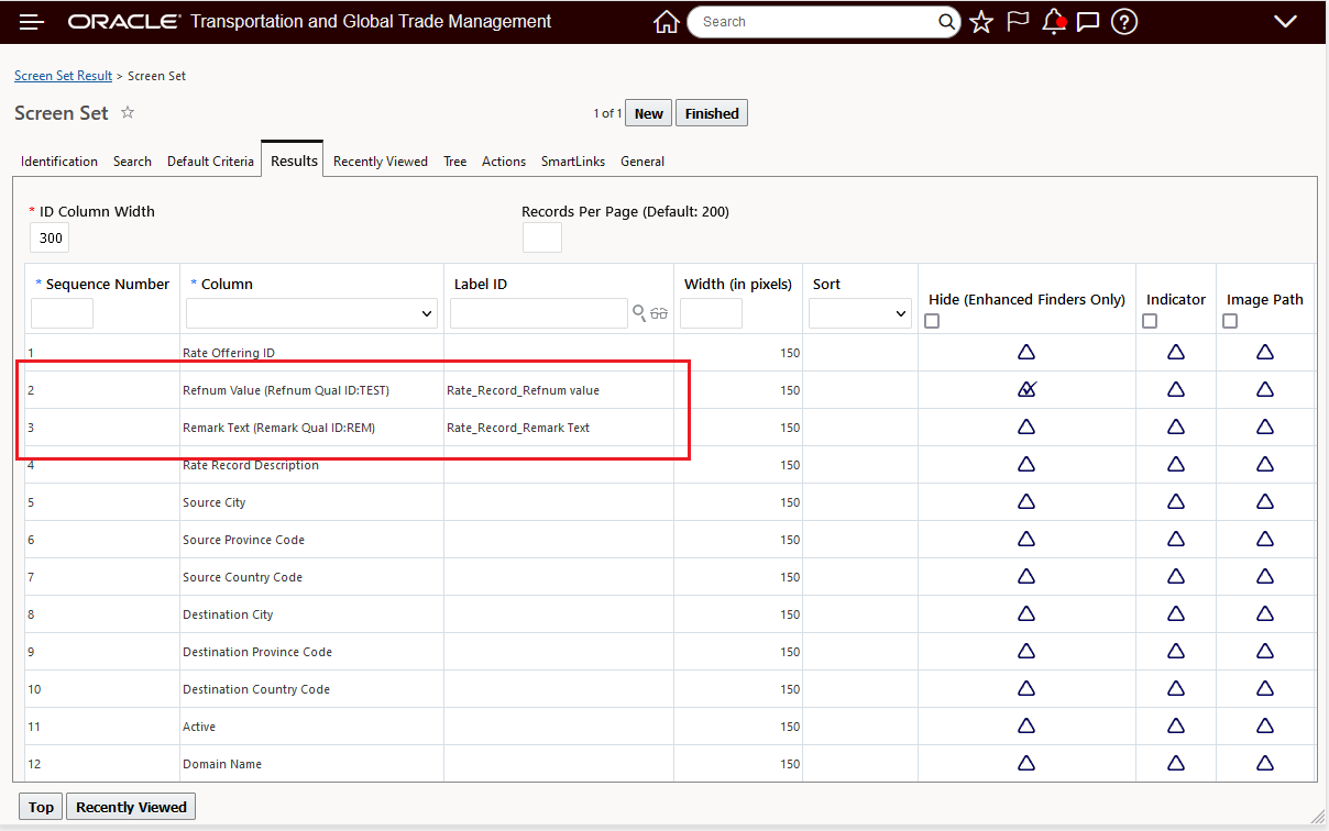

Below is the Screen Set used in the example above.
Screen Set Setup

To take advantage of this feature, you will need to modify and/or create a new screen set where the newly available pseudo fields are configured.
