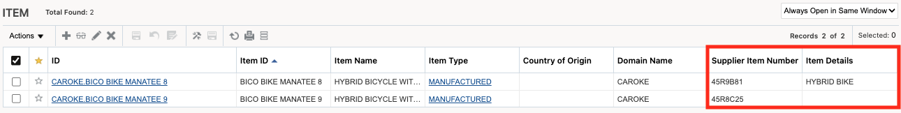

To take advantage of this enhancement, you need to add reference numbers and/or remarks on your finder results. The easiest way is to copy the public screen set and create a new one. On the new screen set, you can add your reference numbers and remarks to the Results tab. For example, you can add a Reference Number = Supplier Item Number and a Remark = Item Details to an item screen set.
Item Finder Results with Reference Numbers and Remarks
