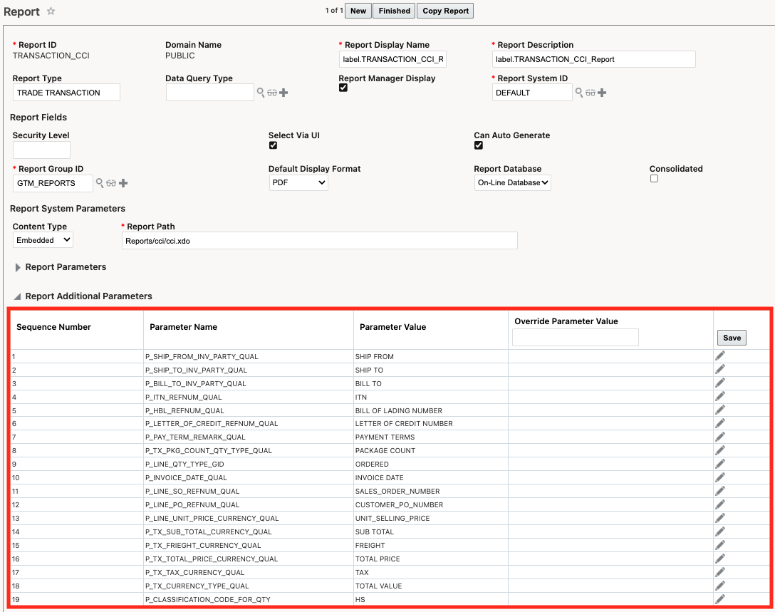

This optional feature, when enabled, allows you to configure report details using additional parameters on the AES report and Customs Commercial Invoice (CCI) report. You can easier add parameters specific to your business such as the qualifiers you are using for certain data. GTM may ship with certain parameters out of the box but you have the ability to override those parameters. In this example, you are editing the TRANSACTION_CCI report to add Override Parameter Values.
Report Additional Parameters Within CCI Report

- Set the Optional Feature called 'Use Report Additional Parameters' to TRUE/enabled.
- The Optional Feature UI is only available to DBA.ADMIN.
- Navigate to Business Process Administration > Power Data > Document Generation > Reports.
- Use the finder to select the proper report and then configure the parameters in the Report Additional Parameters grid.
