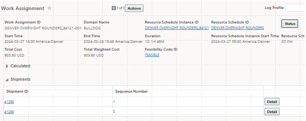

Work Assignment with two shipments.

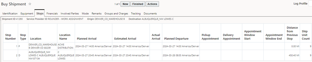

The shipment stops for the first shipment are as follows.

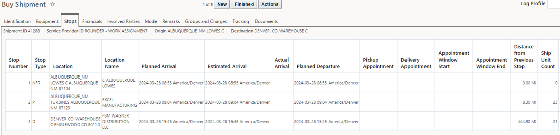

The shipment stops for the second shipment are as follows.   Notice the NFR stop.   It is 8.3 miles from the next shipment.

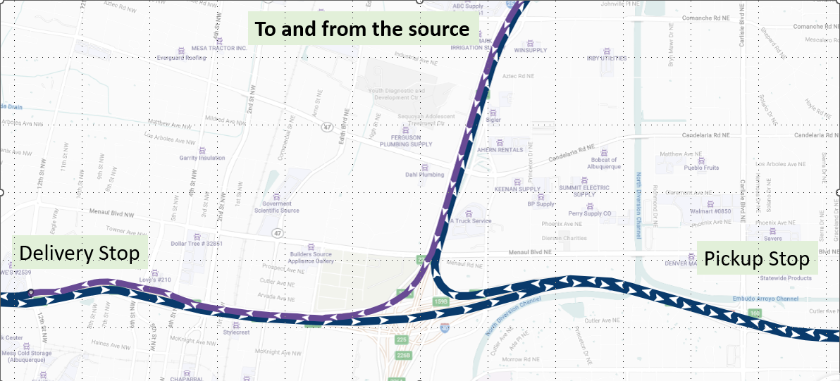

Map showing the link between shipments
