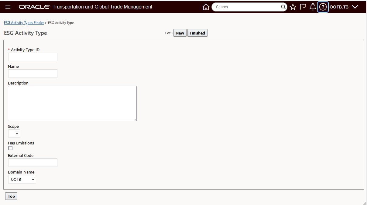

ESG Activity Type
The ESG Activity Type is used for classifying your ESG Activities. You can classify your defined Activity Types following the standard Scope 1, 2, and 3 Scope values used by both the Global Logistics Emissions Council (GLEC) and Greenhouse Gas Protocol’s for emissions accounting.
Within the GLEC and Greenhouse Gas Protocol’s, Scope 1 covers direct emissions, Scope 2 covers indirect emissions from purchased electricity and Scope 3 covers other indirect emissions in the value chain.
ESG activity type
ESG Activity Type

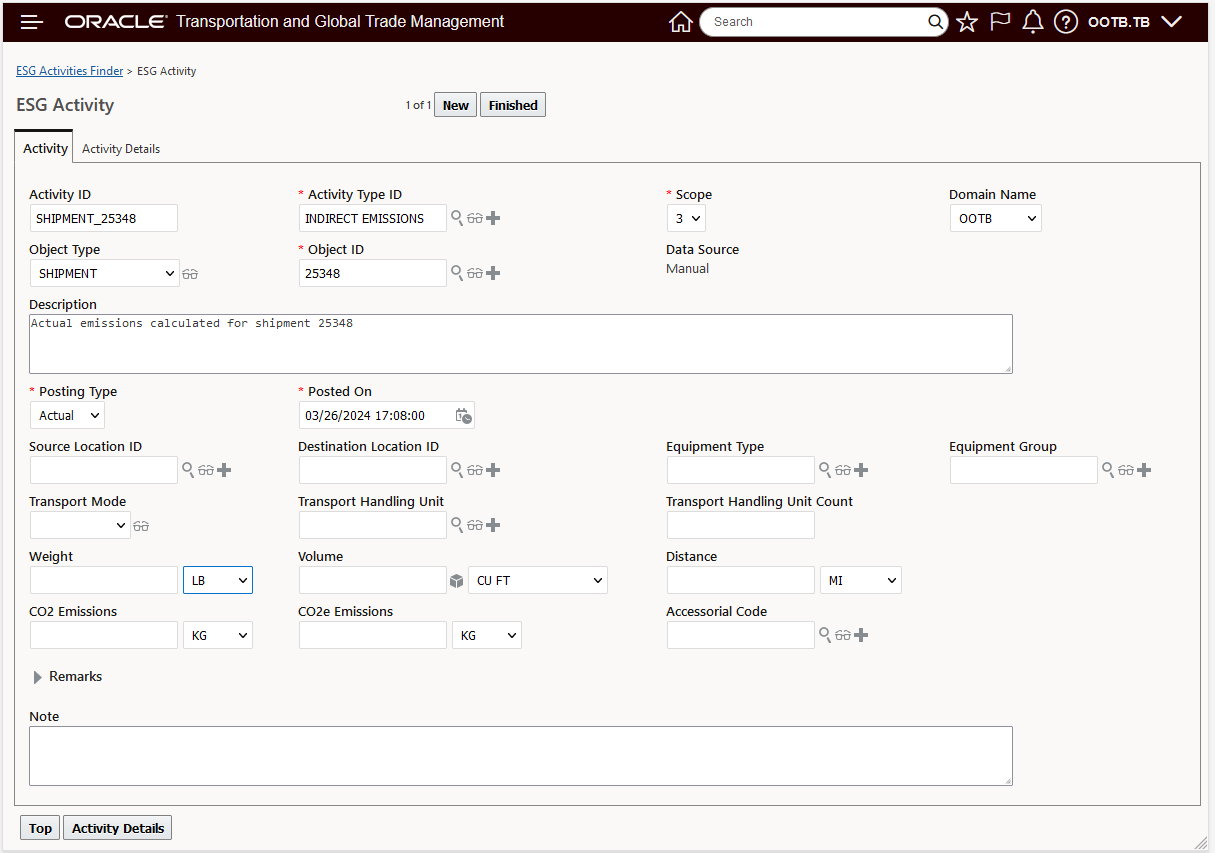

Note that both the Activity Type and Scope are required.  The ESG Activity UI will default to the Scope value of the Activity Type assigned to the ESG Activity record, it can be overridden if necessary.
ESG activity
ESG Activity

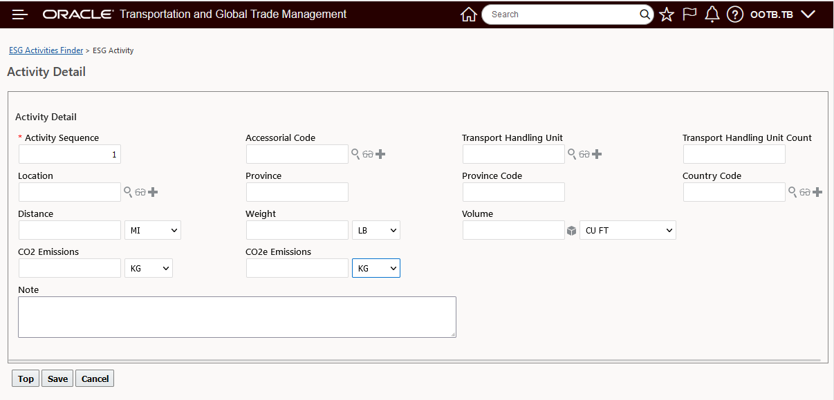

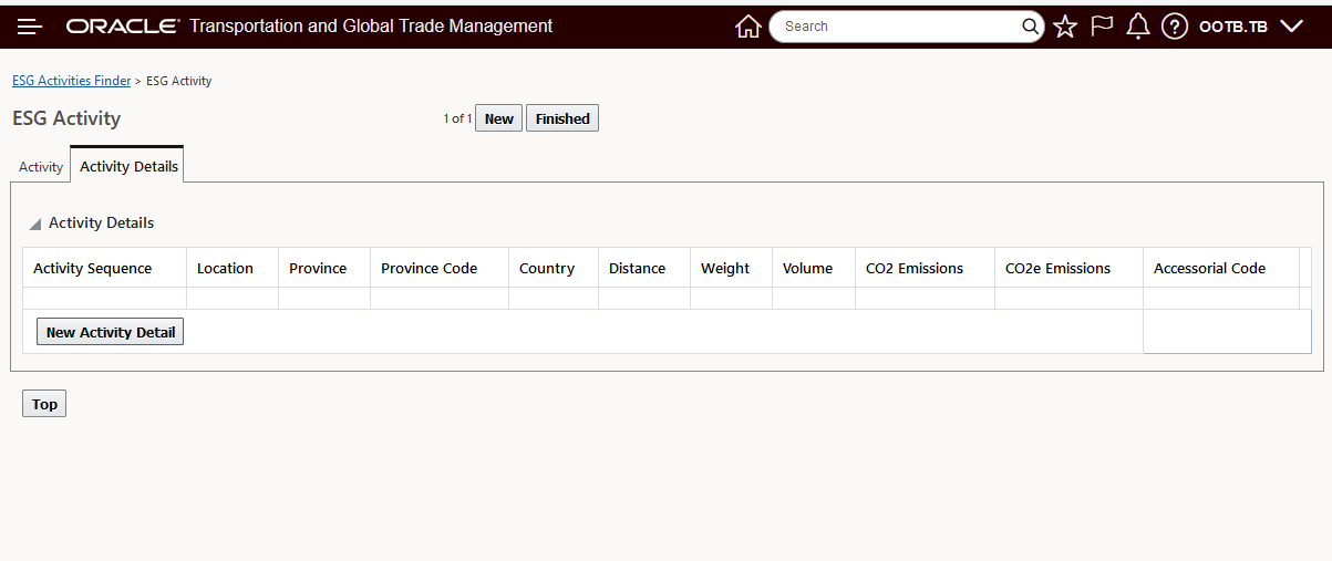

The ESG Activity screen above, can be used to capture the required information for your shipments at a summary level, the ESG Activity Detail screen, below, supports the collection of ESG activities at a lower/more detailed level.  For example, with a multi-stop shipment capturing  the distance and carried weight and volume of a shipment from stop to stop.
ESG activity detail
ESG Activity Detail
Below is the Activity Detail entry screen.
Activity detail entry screen
Activity Detail Entry Screen
In the example below, the Activity Screen captures the reported emissions for Shipment 25348.  In this example the reported emissions for CO2 and CO2e represent the actual calculated emissions provided by Service Provider..
Activity screen example, provided CO2 information actual information
Activity Screen Example, Provided CO2 information Actual Information

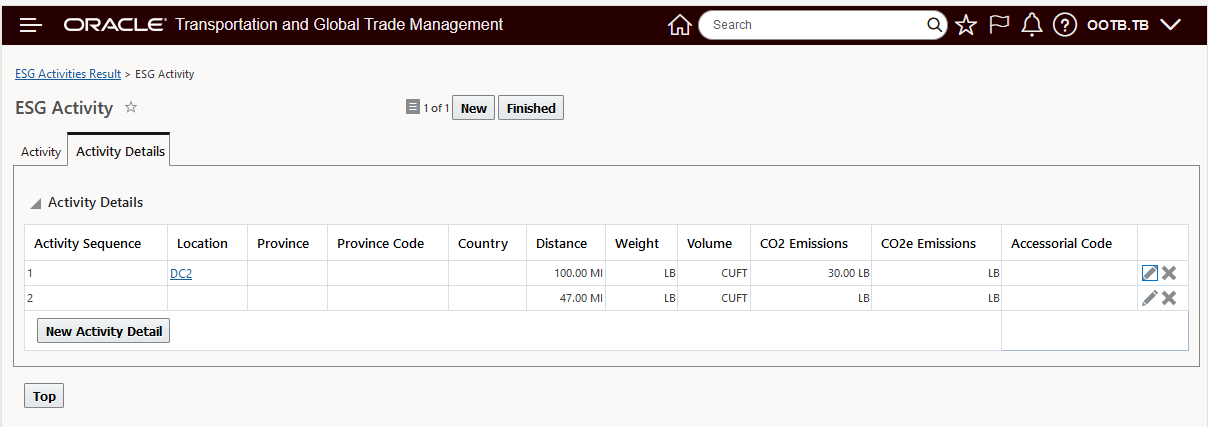

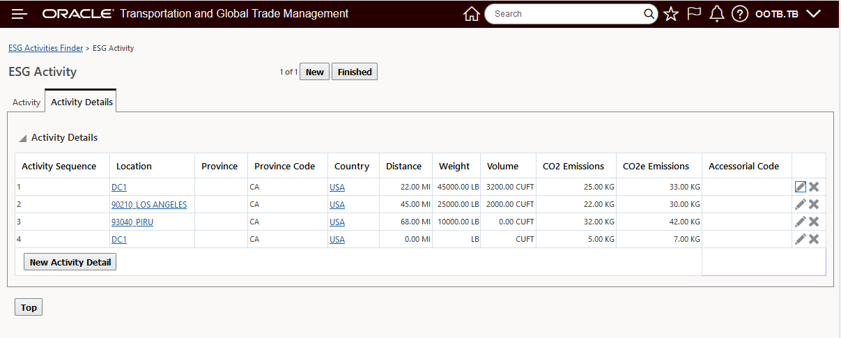

In the example below, the detailed activities for a multi-stop shipment are provided to more fully describe how the emissions for the shipment were realized.  In this case, the shipment starts at DC1 and makes two delivery stops, the weight and volume in the trailer is reduced after each stop - for the last segment of the trip, the trailer is deadheaded back to DC1.
Activity detail reporting example - multi-stop shipment
Activity Detail Reporting Example - Multi-Stop Shipment

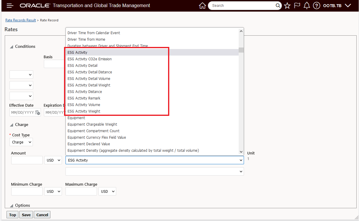

ESG Rate Basis Items
A set of ESG Rate Basis (RBI) Items are available to provide a weighted or actual cost for the ESG Activities or ESG Activity Details reported against a Shipment.
ESG related RBIs
ESG Related RBIs

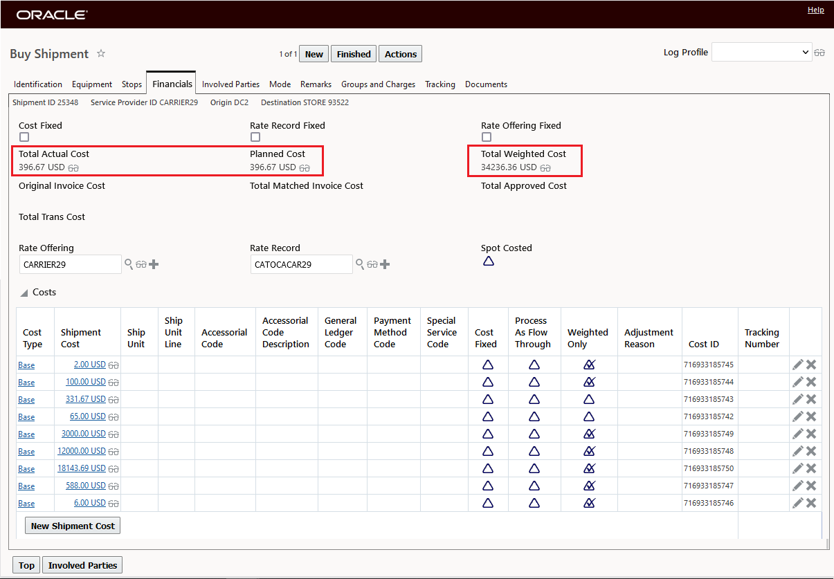

In the example below, the transportation Actual and Planned cost are calculated without including the ESG RBIs and cost, in this example, the ESG  RBIs and cost are captured as weighted cost  of 34236.36 USD.
ESG related RBIs shipment rated example
ESG Related RBIs Shipment Rated Example

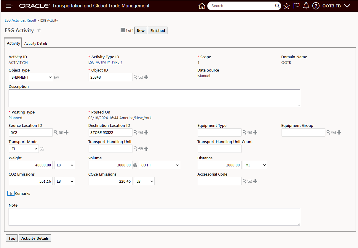

The related Activity and Activity Detail records for this shipment in the example above are provided below..
Activity record related to rating example
Activity Record Related to Rating Example
Activity detail record related to rating example
Activity Detail Record Related to Rating Example

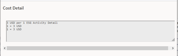

In this example, a per Activity Detail entry of 3.00 USD is calculated.  The total of 6.00 USD is added to the shipment for the two Activity Detail entries.
Cost Detail Examples - Per ESG Activity Detail Record Charge

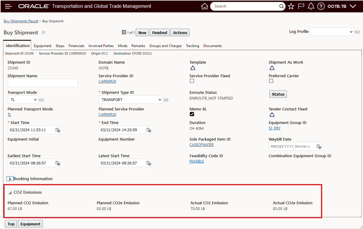

Shipment CO2 Emissions
The Shipment's CO2 Emissions, recorded by the Shipment's ESG Activity records for both Planned CO2 Emission, Planned CO2e Emission, and Actual CO2 Emission, and Actual CO2e Emission are visible on the Shipment in the CO2 Emissions section, shown below.
Shipment Recorded CO2 Emissions

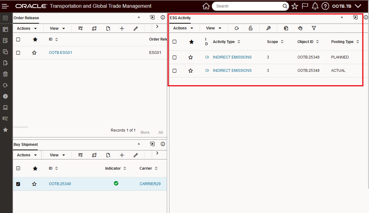

Enhanced Workbench  - ESG Activity Screen Set
The ESG Activity Screen Set, and Public saved query, will allows you to create or modify an Enhanced Workbench to provide visibility to your Shipment's related ESG Activity records,
Sample Enhanced Workbench With ESG Activity Screen Set Added

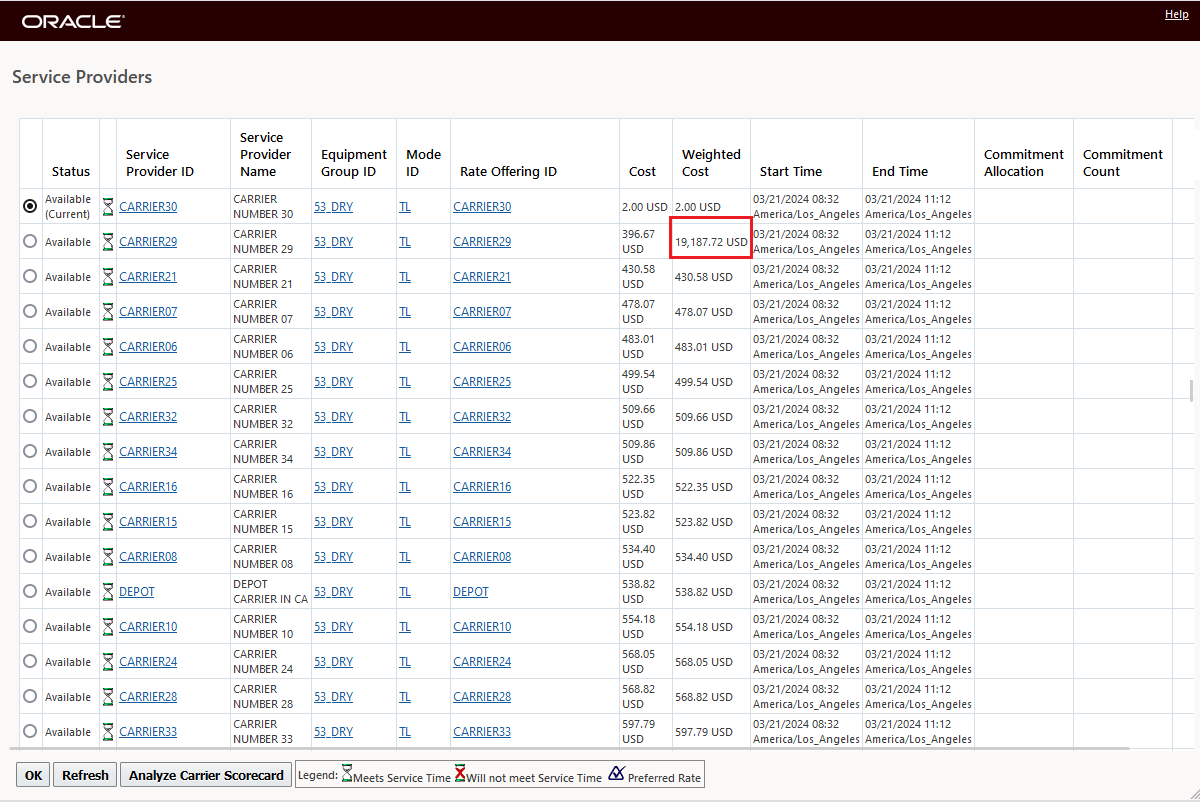

ESG Activity Decision Support
As you would expect, the ESG Activities recorded for a shipment and the cost calculations related to that ESG Activities are included in your decision support actions.  In the example below - Change Service Provider - Carrier29's Weighed cost and include the calculated Weighted Cost and are based on the ESG RBIs included in Carrier29's rate record (above) and the ESG Activities reported for this shipment.
Change Service Provider Decision Support and Weighted Cost for ESG Activities Reported
This feature provides the necessary framework to begin the process of measuring, monitoring and considering the cost of ESG related activities in your transportation planning decision making processes.
