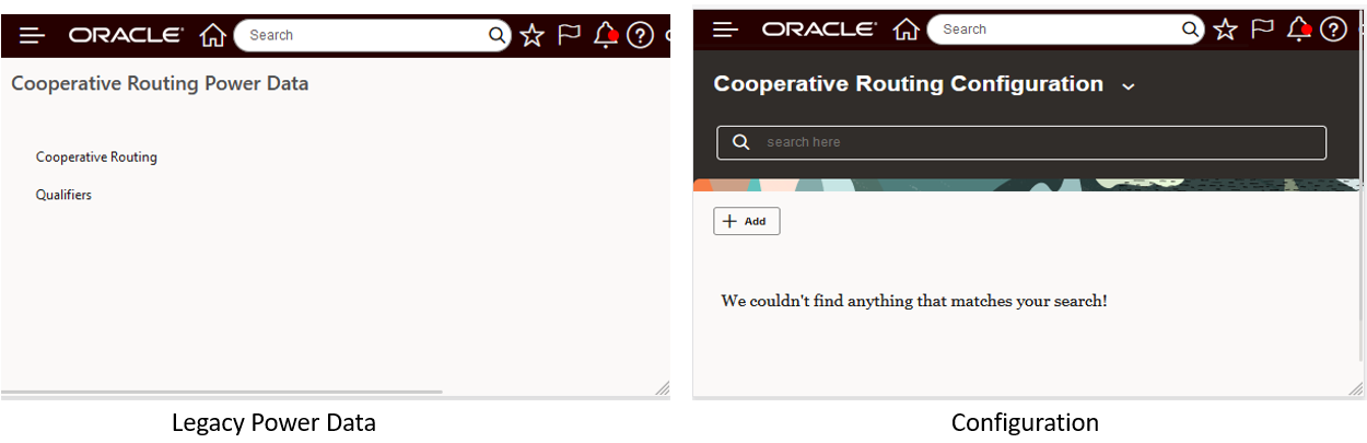

When you navigate to the new Configuration UI - Cooperative Routing > Configuration - you will immediately notice the difference between the legacy Power Data UIs and the new more modern UI.
Comparison of Legacy Power Data Screen to New Configuration UI

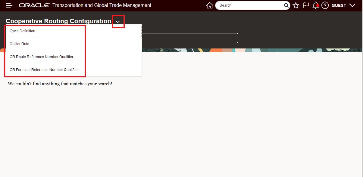

The new UI has a number of features that simplify the management of the configuration data. At the top of the screen you have access, via the drop down, to all of the configuration data for the object being configured, in this case, Cooperative Routing. For Cooperative Routing there are four configuration data items available, the legacy Power Data screens has these items grouped into two intermediate groupings (Cooperative Routing and Qualifiers), while the Configuration UIs provides direct visibility and access all the configuration items.
Cooperative Routing Configuration - Drop Down List

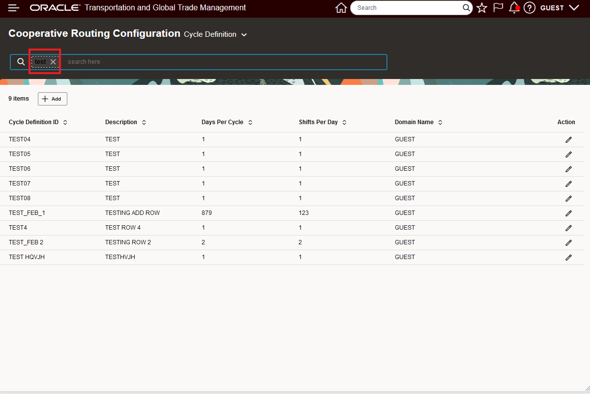

At the top of the screen the "search here" allows you to easily filter the results provided in the list. In this example, the list is filtered to show all the records with the letters "test".
Filter Example for "test"

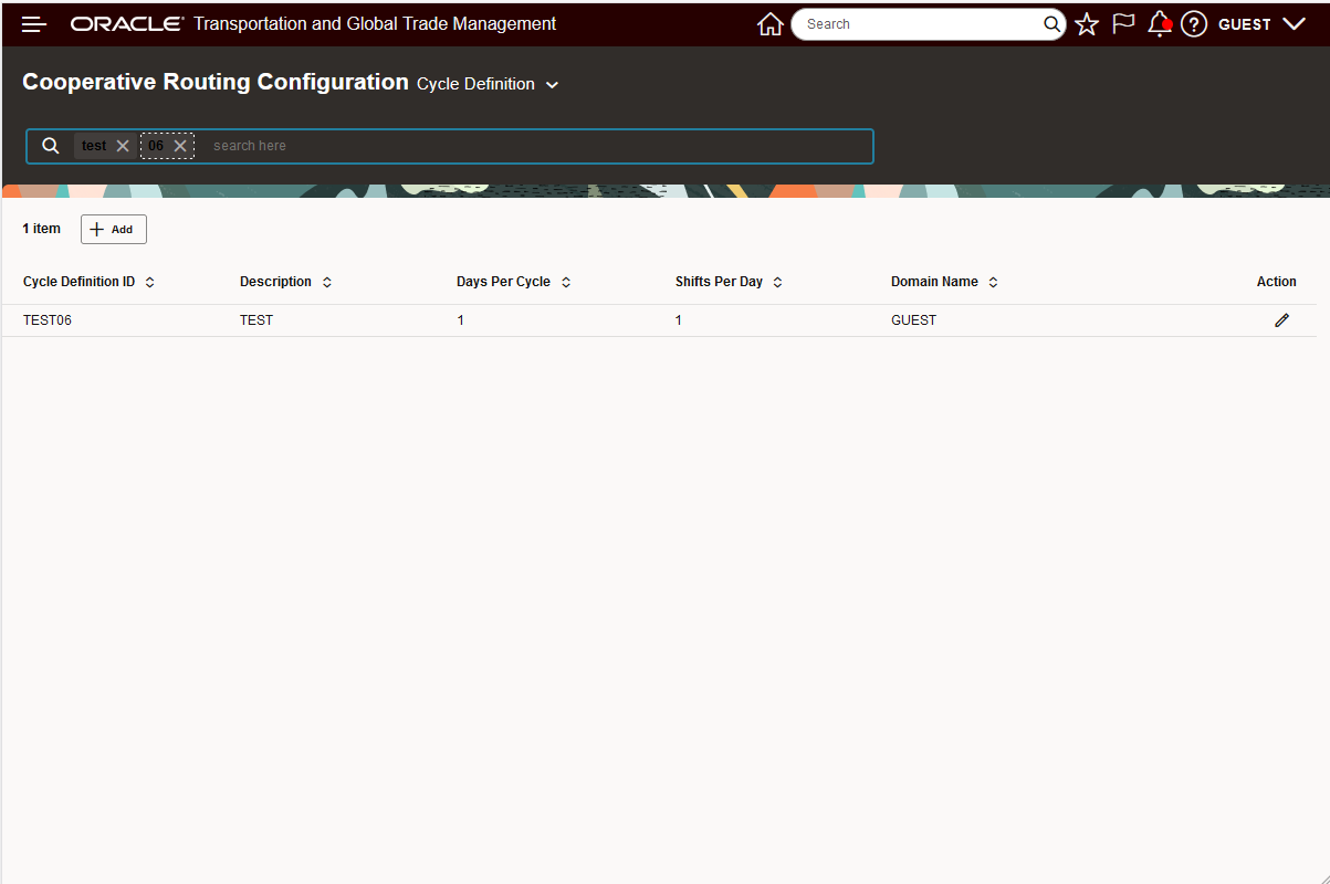

You can further refine the filter by adding additional criteria, in the example below the addition filter criteria of "06" was added, limiting the result to just 1 row.
Filter Criteria for "test" and "06"

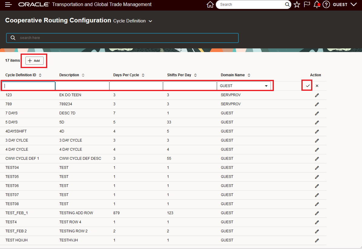

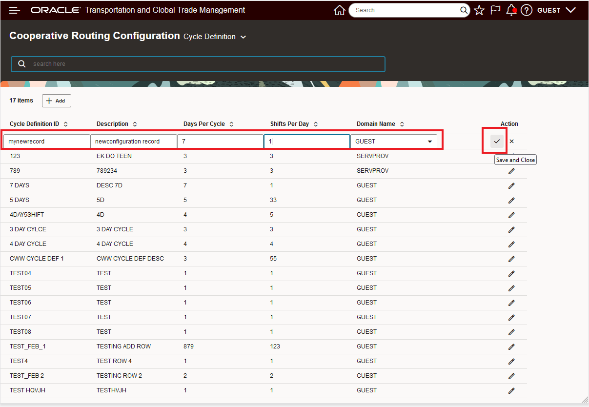

In the example below, the +Add option is used to insert a new entry - note that this option handles the add in a row entry fashion vs opening a new dialog box. To add a new record you select +Add, enter the data in the row and then select the check mark when done.
Add Example Row Based Record Addition

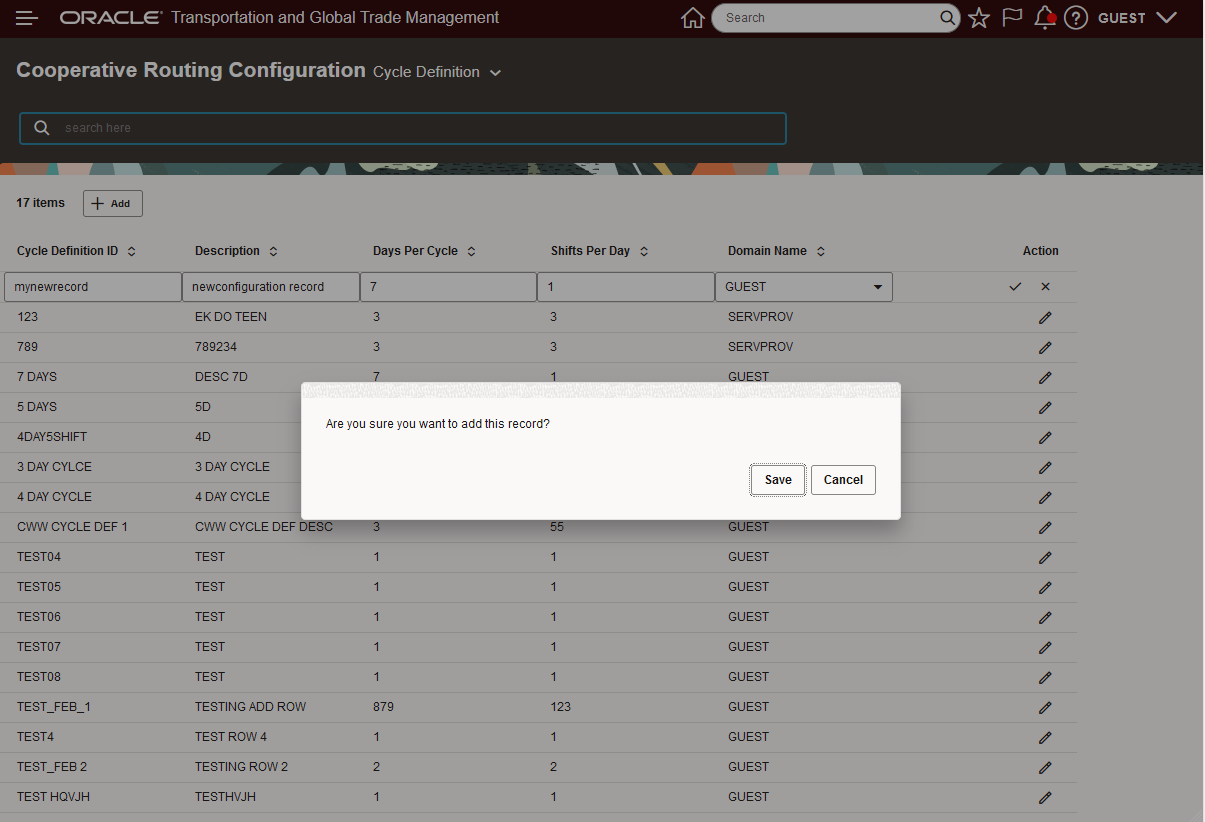

Below is an example of a new record being entered.
Data Entered for New Record - Ready to Save and Close
When Save and Close is selected you are asked to confirm the add - as shown below.
Confirm the Save and Close for Add

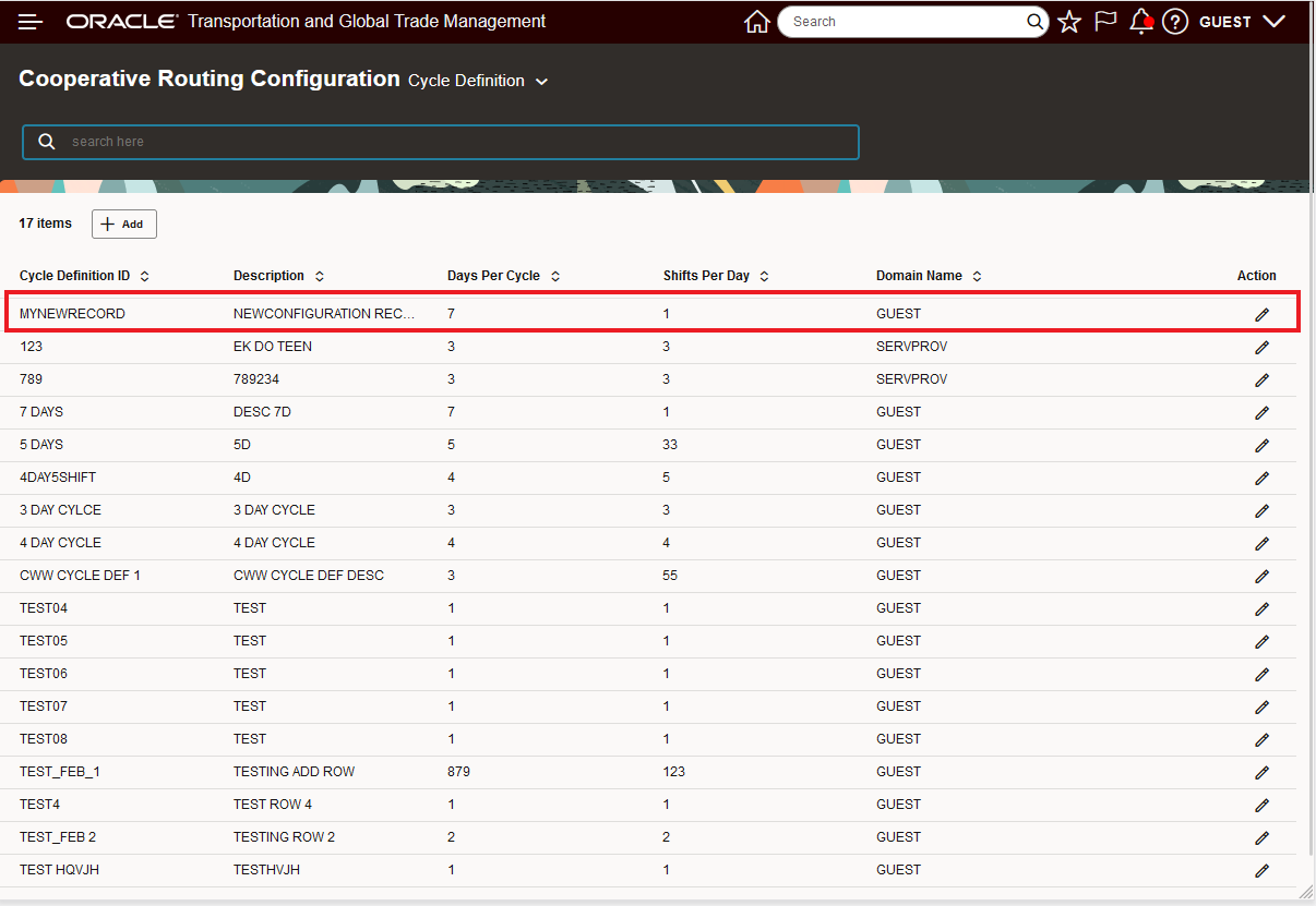

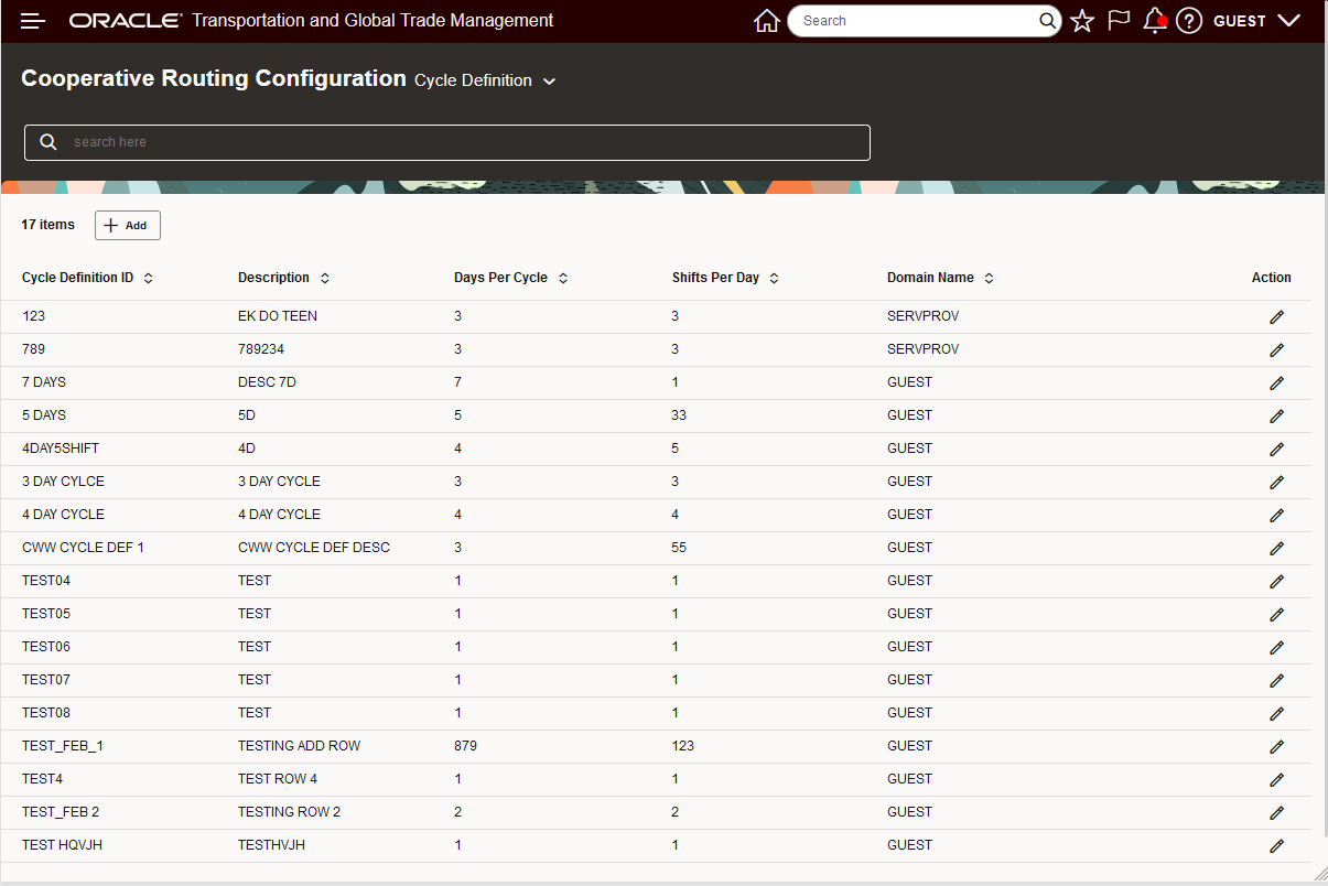

Below is the newly added record.
Added Record Result

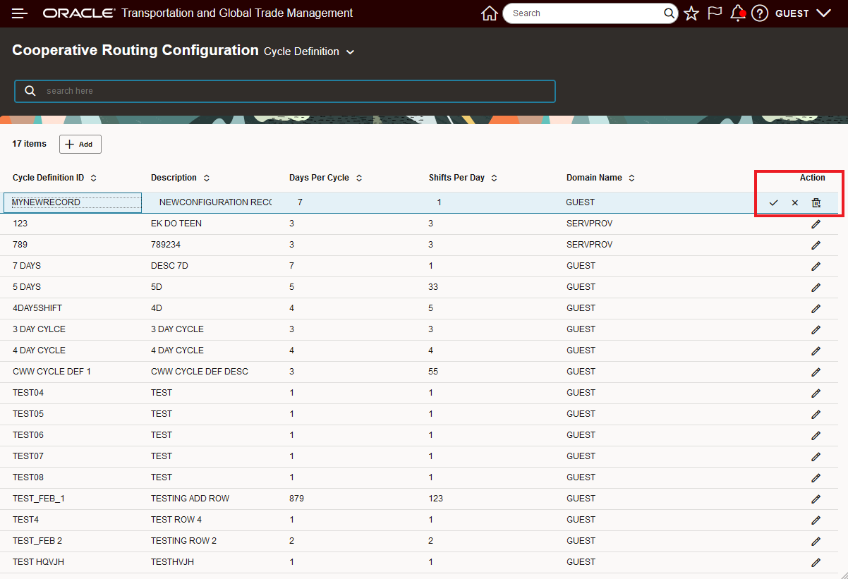

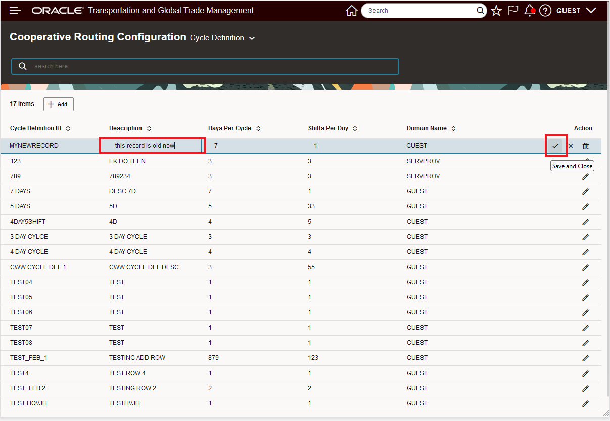

The last item to highlight is the Action item. You initiate the actions (and edit) for a row by selecting the pencil icon. Available actions include save your edits (check icon), cancel (X) and delete the row (trash can).
Action Options - Edit, Cancel, Delete

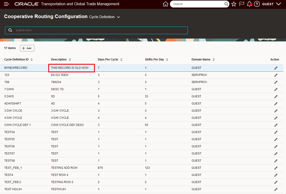

Below is an example of how you can easily update any of the fields for one of the rows. In this case the Description field has been updated. The process starts by selecting the pencil. Then going to field to be updated an updating the data. Once all the edits are complete the changes will be saved by selecting the check icon which will Save and Close.
Edit the Field(s) in This Example the Description Field is Modified
Below is the saved result from the edit above.
Saved Result from the Edit of the Description Field

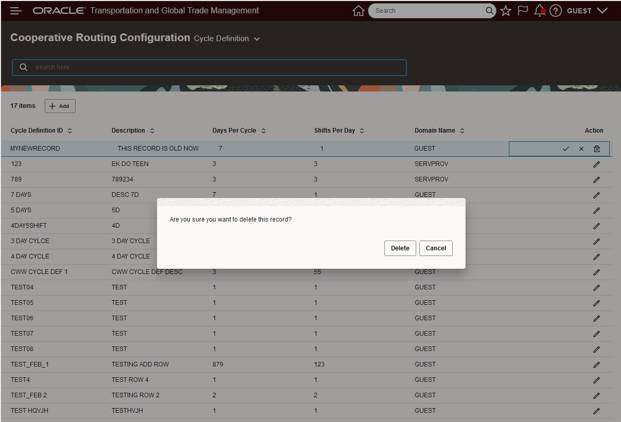

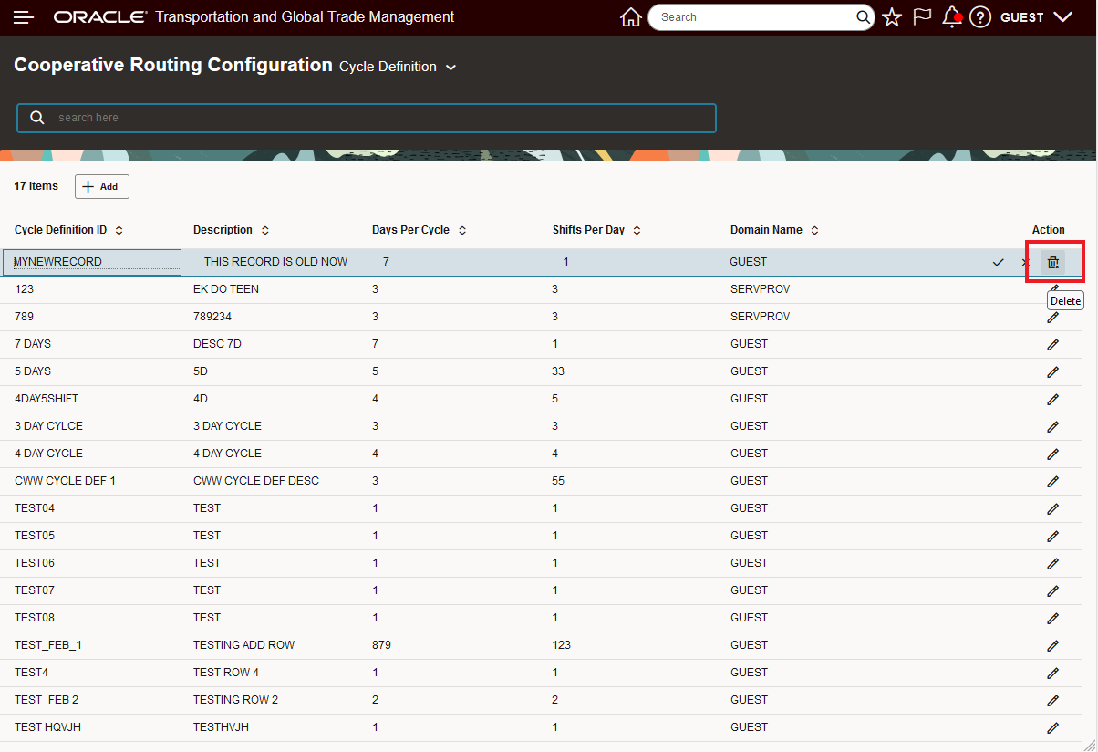

In the series of screen shots below, the delete action is run against the record added and modified above.
Initiate Delete by Selecting the Trashcan Icon
After the delete is initiated, there is a confirmation step shown below.
Confirm Delete
The result of the delete is below.
Record Deleted

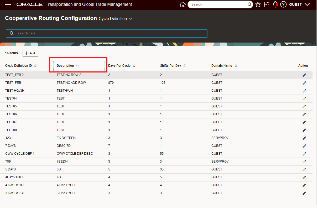

One final item to point out, you can sort the results provided by the column headings. In the example below the results have been sorted by the description field.
Sorted Results
