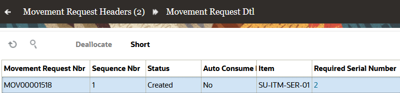

From the Movement Request -> Details UI, you can add and associate required serial numbers for corresponding order lines (when using a serialized item with end to end tracking) using the new Required Serial Number column and hyperlink.
Required Serial Number Column
- The Required Serial Number hyperlink is enabled only if:
- the underlying company tracks serials end to end.
- the selected movement request detail item has required serial number tracking enabled.
- The application displays an error message when you add new serial numbers or edit the serial number for corresponding movement request detail.
NOTE: The add/edit/delete action buttons on the Movement Request Detail page are permission controlled.
