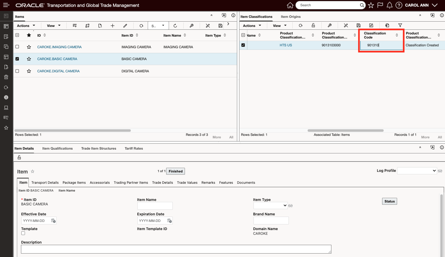

Item Manager and Item Classification Manager
The Item Classification manager and the Item > Item Classification are updated to support the enhanced classification code column. If the classification code column is NULL, GTM derives the classification code from the Product Classification Code GID. When an item classification record is saved, GTM populates the classification code column if the data is not present. In addition, the integration has been updated to support the enhanced classification code column.
On the view and edit pages, you’ll continue to see one Product Classification Code field.

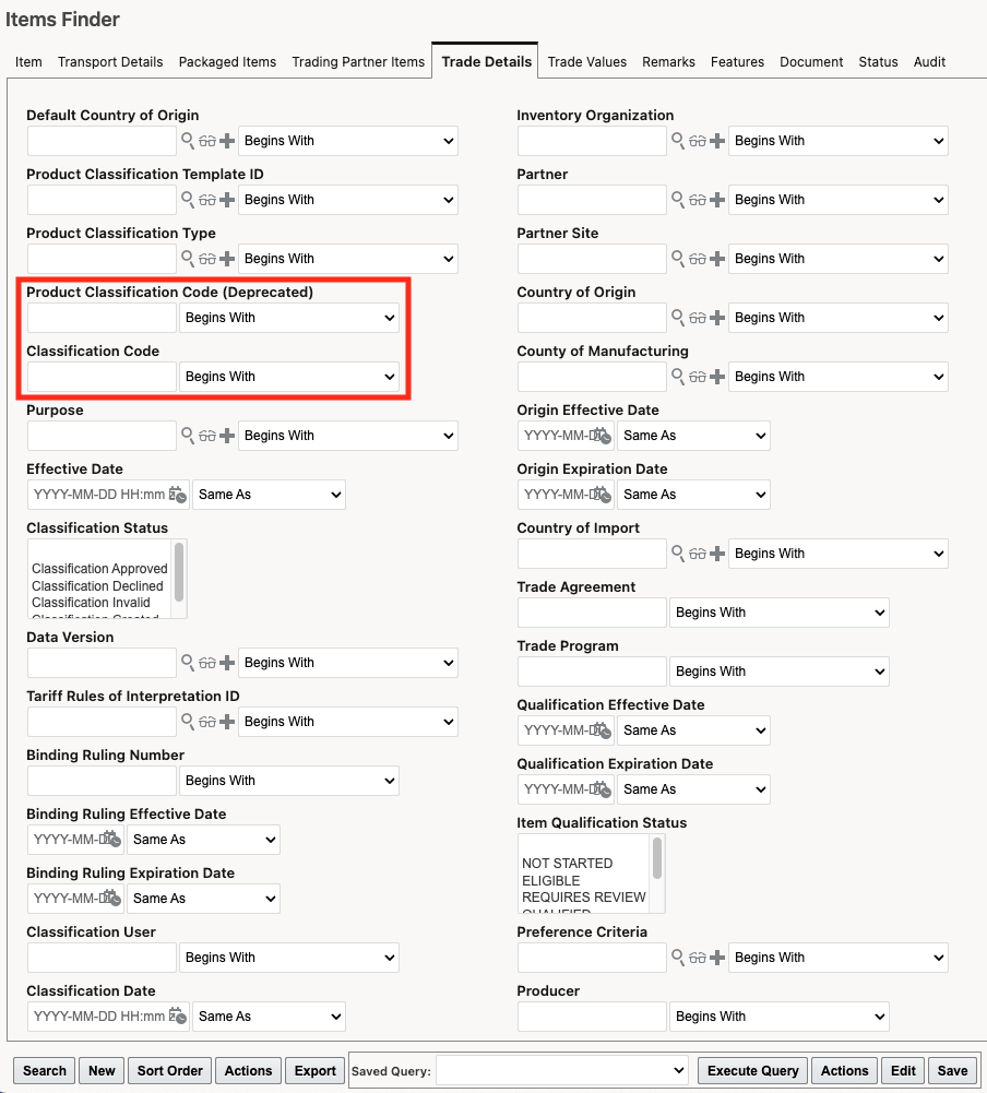

When searching for classification data via the Item finder or Item Classification finder, a new field is added called ‘Classification Code’. This field is in addition to the existing product classification code field. Note that the label for the existing field is changed to ‘Product Classification Code (Deprecated)’ to clearly identify this field will be removed in a future release.
Item Finder - Classification Code
On the Item Classification finder results, a new field is added called ‘Classification Code’. This field is in addition to the existing product classification code field. Note that the label for the existing field is changed to ‘Product Classification Code (Deprecated)’ to clearly identify this field will be removed in a future release. In addition, inline edit and mass update of the enhanced Classification Code is available. To take advantage of inline edit and mass update, make the Classification Code editable in your custom screenset.
Item Workbench - Classification Code Inline Edit and Mass Update

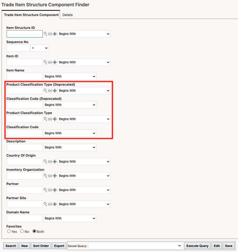

Trade Item Structure Component Manager
The Trade Item Structure Component manager is updated to support the enhanced classification code column. If the classification code column is NULL, GTM derives the classification code from the Product Classification Code GID. When a trade item structure component record is saved, GTM populates the classification code column if the data is not present. In addition, the integration has been updated to support the enhanced classification code column.
On the Trade Item Structure Component finder and finder results results, new fields are added called ‘Product Classification Type’ and ‘Classification Code’. These fields are in addition to the existing product classification type and product classification code fields. Note that the label for the existing fields are changed to ‘Product Classification Type (Deprecated)’ and ‘Product Classification Code (Deprecated)’ to clearly identify these fields will be removed in a future release.
Trade Item Structure Component Finder - Classification Code

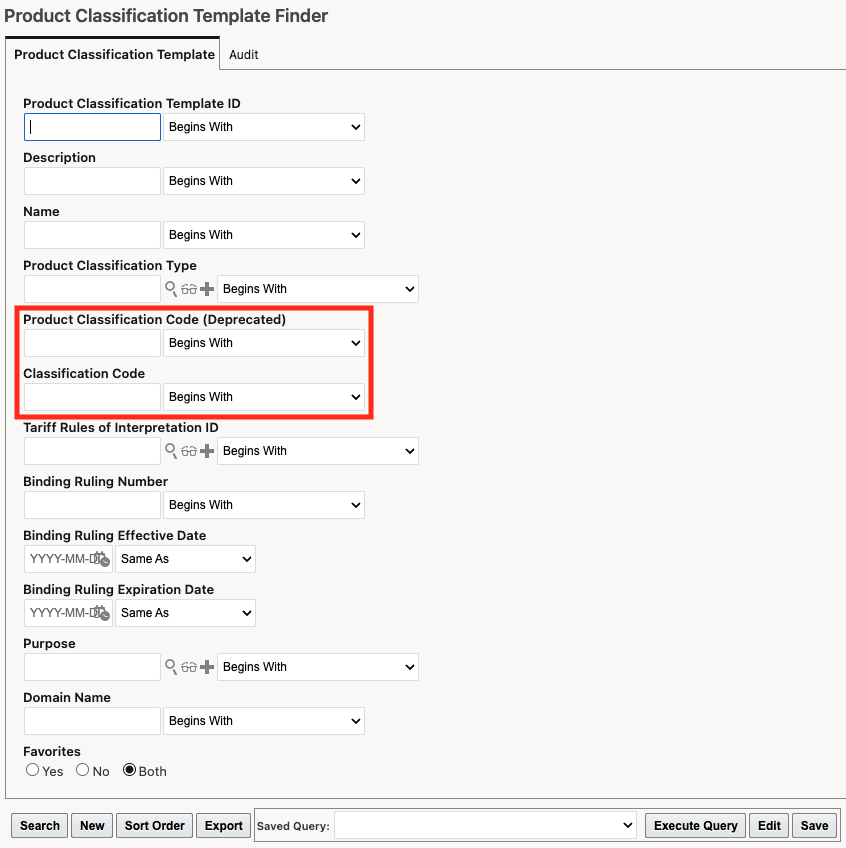

Product Classification Template
The Product Classification Template manager is updated to support the enhanced classification code column. If the classification code column is NULL, GTM derives the classification code from the Product Classification Code GID. When a product classification template record is saved, GTM populates the classification code column if the data is not present.
When searching for classification data via the Product Classification Template finder, a new field is added called ‘Classification Code’. This field is in addition to the existing product classification code field. Note that the label for the existing field is changed to ‘Product Classification Code (Deprecated)’ to clearly identify this field will be removed in a future release.
Product Classification Template Finder - Classification Code

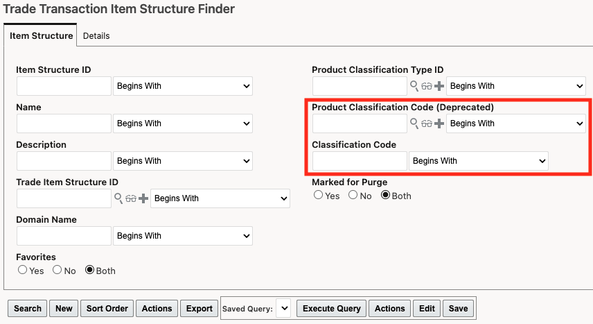

Trade Transaction Item Structure Manager
The Trade Transaction Item Structure manager is updated to support the enhanced classification code column. If the classification code column is NULL, GTM derives the classification code from the Product Classification Code GID. When a trade transaction item structure record is saved, GTM populates the classification code column if the data is not present.
On the Trade Transaction Line Structure finder and finder results, a new field is added called ‘Classification Code’. This field is in addition to the existing product classification code field. Note that the label for the existing field is changed to ‘Product Classification Code (Deprecated)’ to clearly identify this field will be removed in a future release.
Trade Transaction Item Structure Finder - Classification Code
