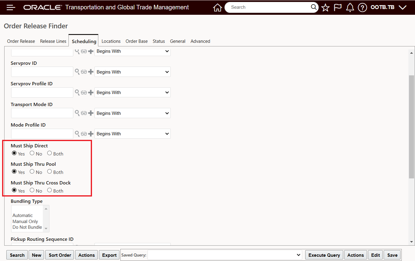

In the example below, the Order Release's Must Ship Direct Boolean values have all been set to a default value of Yes, from their original values of Both.
Must Ship Direct Boolean Value Search Default Set to Yes

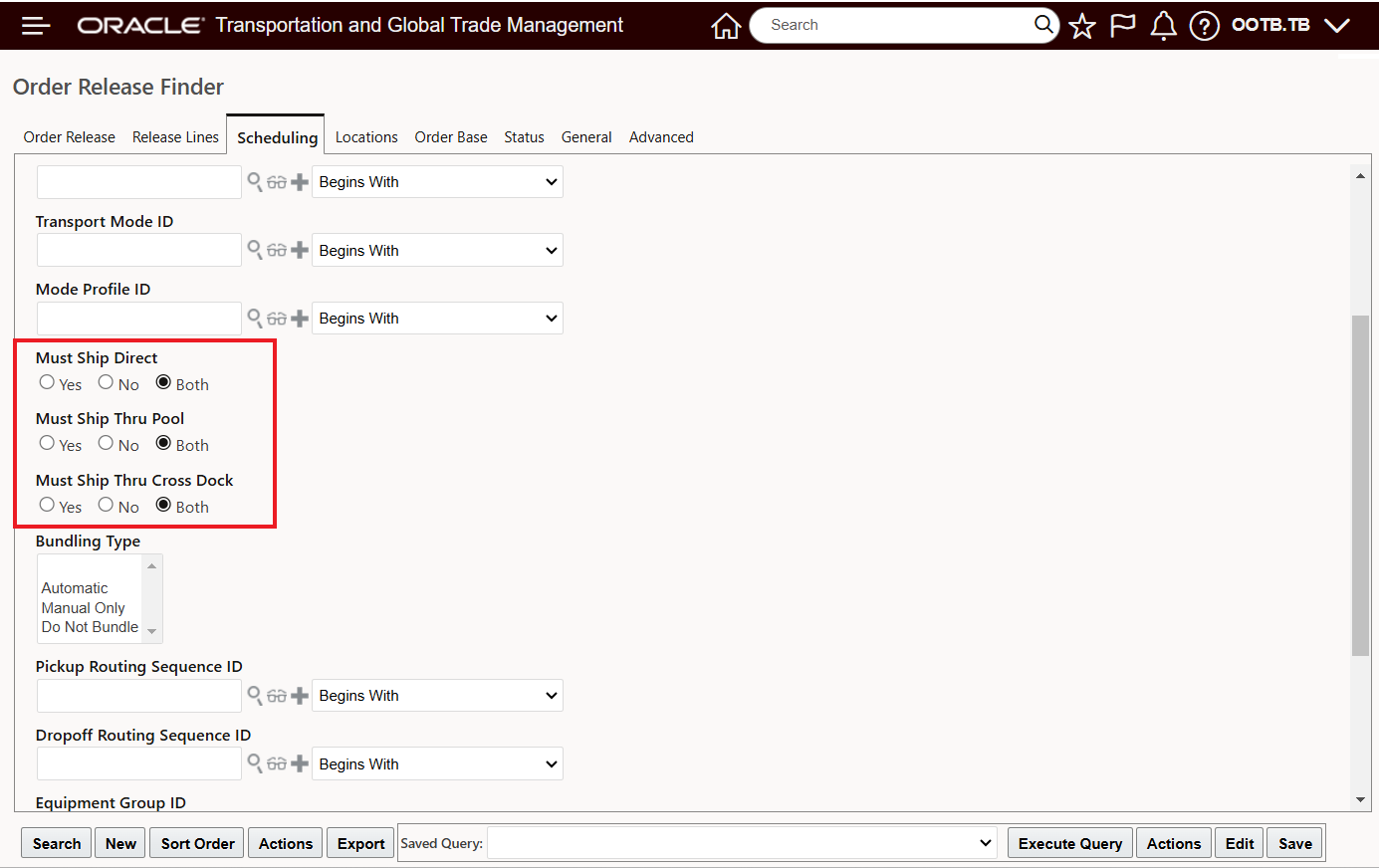

Previous Must Ship Direct Boolean Value Search - Non-Configurable
Below is the previously available default value of Both, which was not configurable.
This feature improves usability by eliminating unnecessary clicks required to set the search criteria related to Boolean fields.

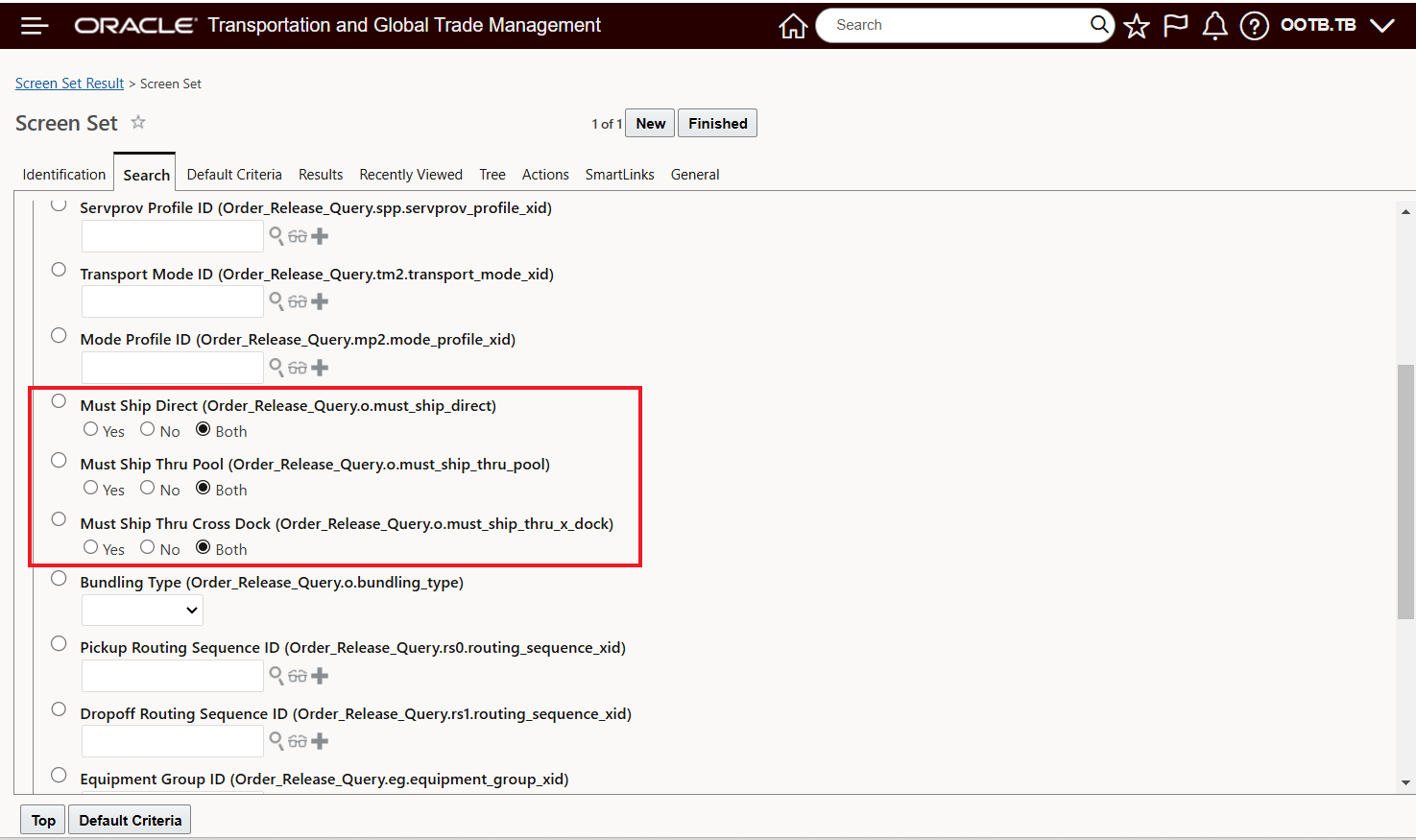

In the example below, the original Screen Set has all of the Must Ship Direct fields default search criteria set to Both.
Screen Set Default Must Ship Direct Boolean Field Search Criteria Both

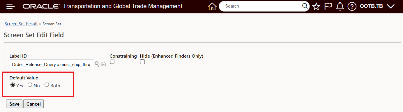

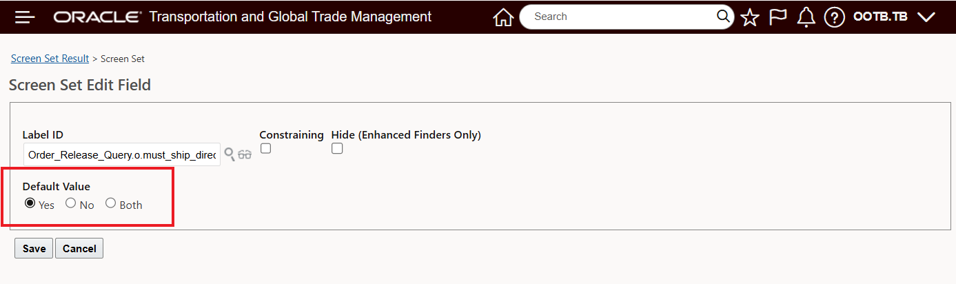

To change the default values for the Must Ship Direct fields, each field is edited on the Search tab and the Default Criteria is set as shown below.
Boolean Field Default Search Criteria Configuration

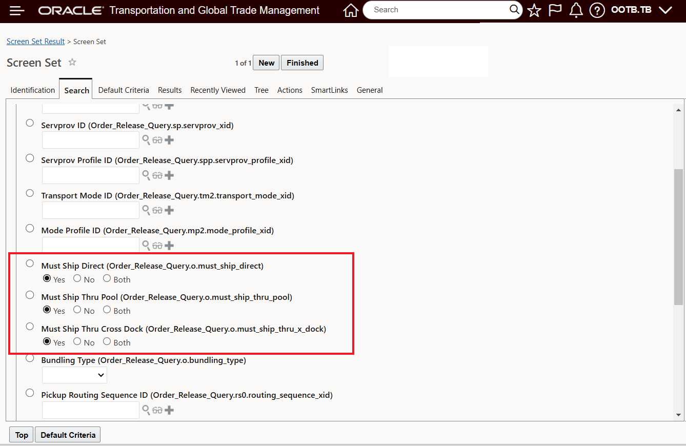

Once all of the fields have been configured, the Screen Set Search tab will reflect the new default values - as shown below.
Boolean Field Default Search Criteria Configuration - Set to Yes
