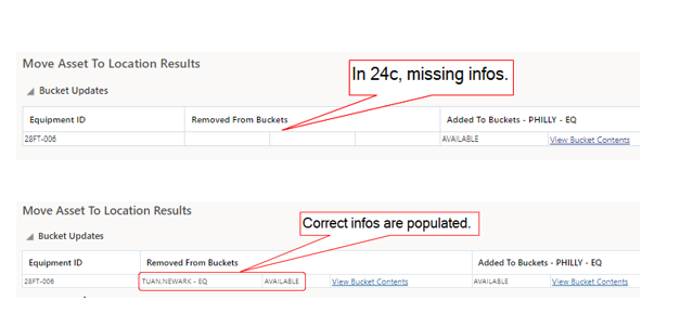

Missing Information is now visible.

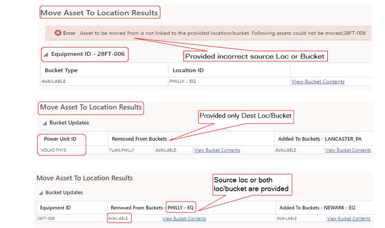

Error message when source location or source bucket are incorrect specified (Equipment on multiple loc/bucket)
Error Messages when incorrect location tried.

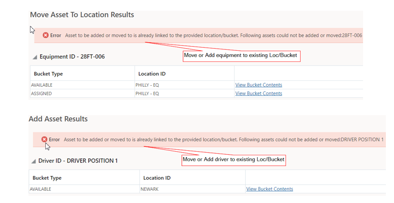

In 24c and prior releases, Add to exist loc/bucket was allowed and resulted in an incorrectly incremented bucket count.
Move to exist loc/bucket delinked the (fixed the delink issue).  In 25a, we’ll get an error message when either add or move to existing loc/bucket.
