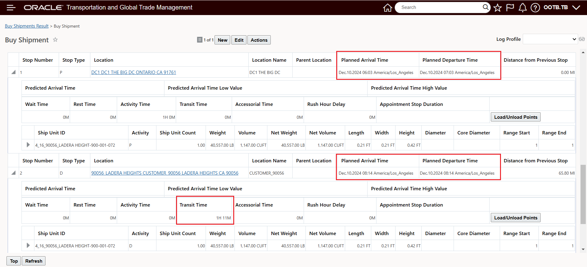

The example shipment goes from DC1 to the 90056 Customer Location, the transit time between these two location is 1 hour and 11 minutes.
Planned Stop Times and Transit Time

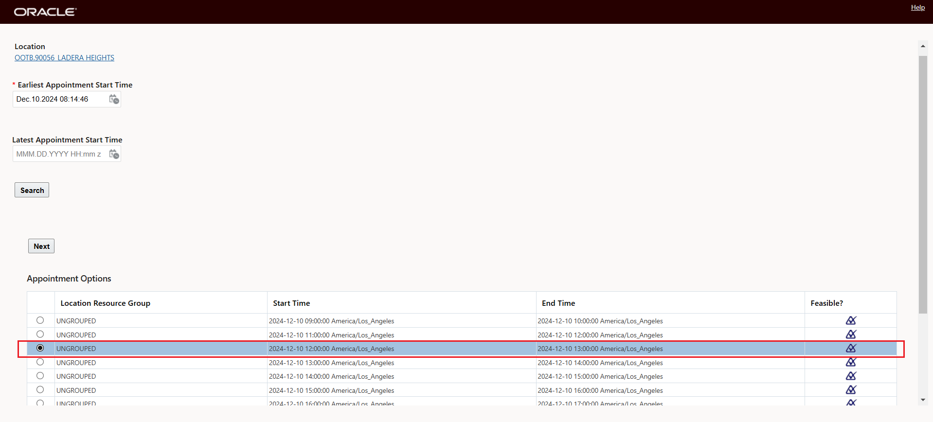

For the fist appointment scheduled, the delivery stop appointment, the noon/12:00 pm appointment will be selected as shown below.
Delivery Location Appointment Scheduled

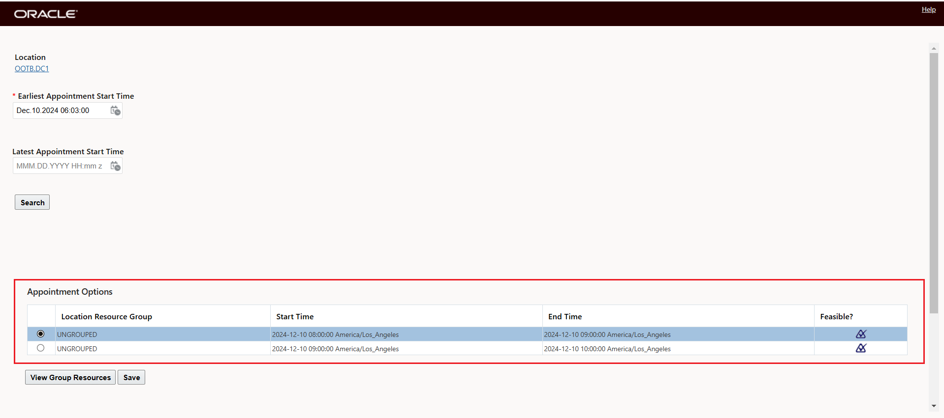

With the two properties set to true, when the DC1 pickup appointment is scheduled, the Feasible options provided are limited considering both the next appointment and the transit time. In this example, that limits the appointment options for the pickup appointment to just the two options shown below. In this next stop appointment case, the property glog.appointment.considerNextStopApptTime takes precedence.
Pickup Appointment Feasible Options with Next Stop Appointment

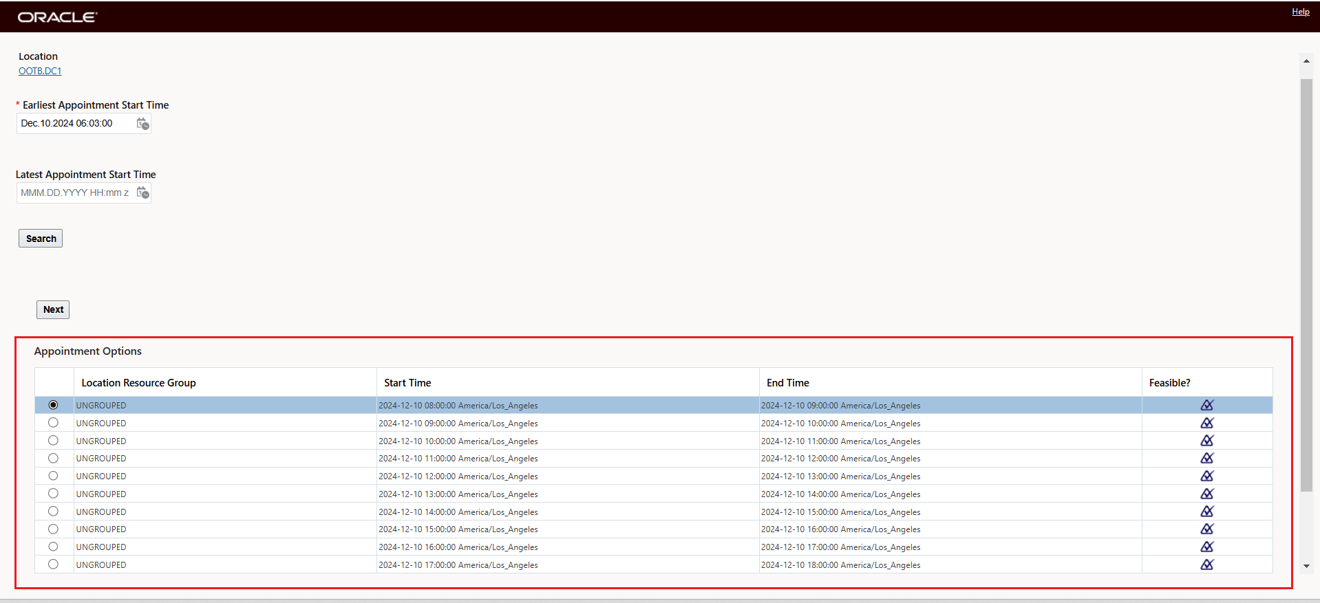

With the two properties set to false, the default/backward compatible behavior when scheduling the pickup appointment at DC1, with the Customer delivery appointment already set, a much longer "Feasible" list of options are provided as shown below. Clearly, many of the "Feasible" options are not feasible given the current delivery appointment of 12 pm noon at the customer location. The purpose of this feature is to remove these operationally infeasible options from the list when you schedule your appointments.
Properties set to false - Pickup Appointment "Feasible" Options

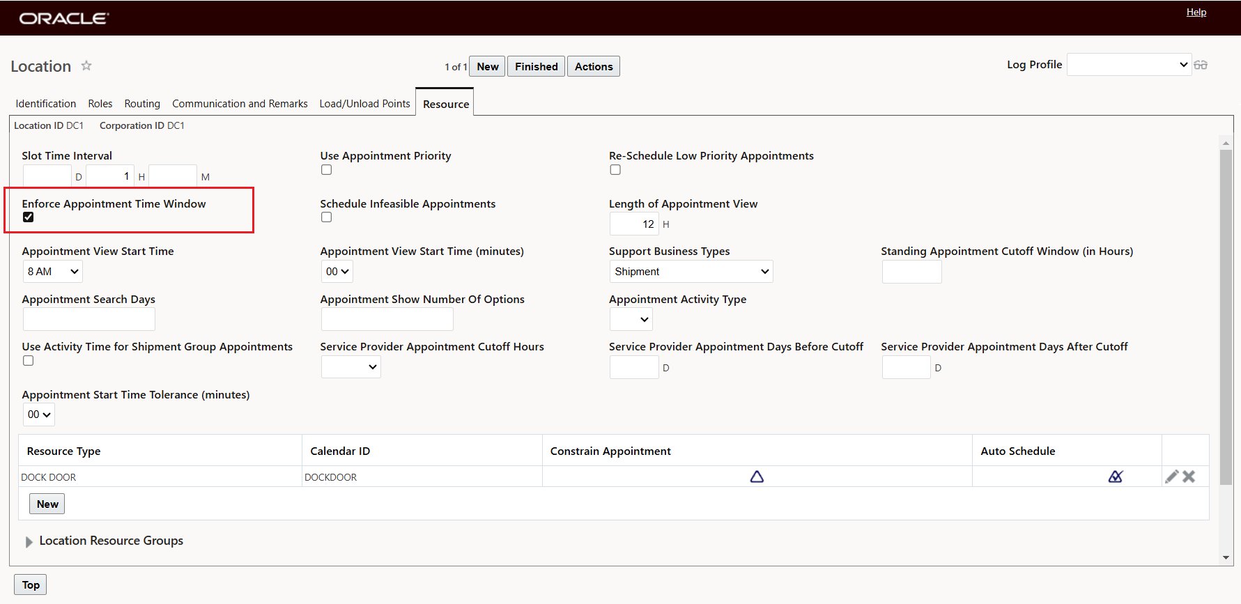

- The Enforce Appointment Time Window checkbox must be selected in the location resource as shown below for DC1.
