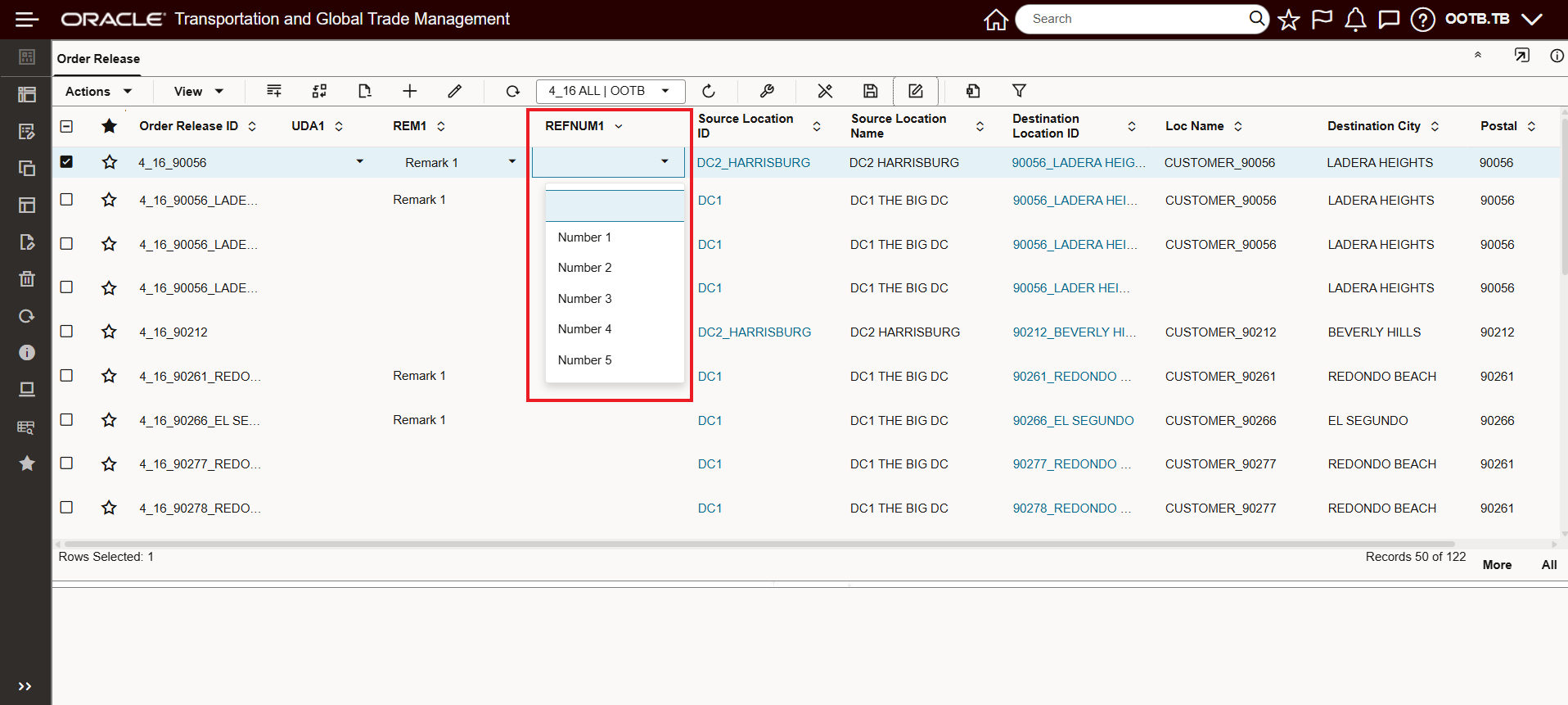

Below is the Inline Edit for the Reference Number field (REFNUM1).
Inline Edit for Reference Number (REFNUM1) with Fixed List of Values

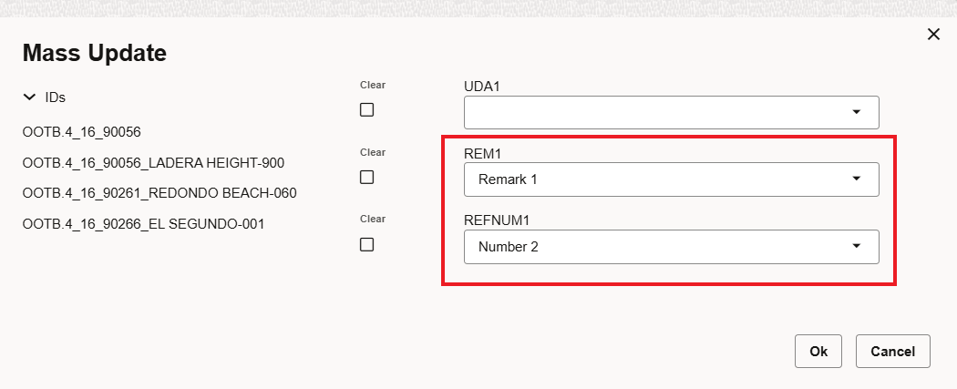

Below is a Mass Update example using the configure Fixed List of Values for the two configured Remark and Reference Number fields.
Mass Update with Fixed List of Values - Remark (REM1) and Reference Number (REFNUM1)

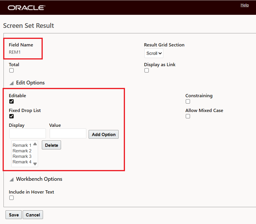

To us this feature you will need to configure your screen set to support a fixed list of values, as shown below.
For the example above, the REM1 fields was configured as shown below - Editable is selected and the Fixed Drop List of values are provided.
REM1 Fixed Drop List of Values Screen Set Configuration

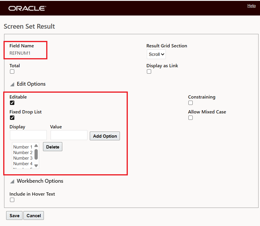

Again, for the example above, the REFNUM1 fields was configured as shown below - Editable is selected and the Fixed Drop List of values are provided.
REFNUM1 Fixed Drop List of Values Screen Set Configuration
