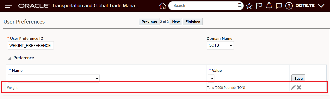

In the example below, the User Preference for Weight has been set to TONs - as shown below.
User Preference - TONs
The Finder Results for a shipment query returns the Gross Weight field as shown below - where the Weight UOM field is displayed using the User Preference - TON.
Finder Results - Using User Preference

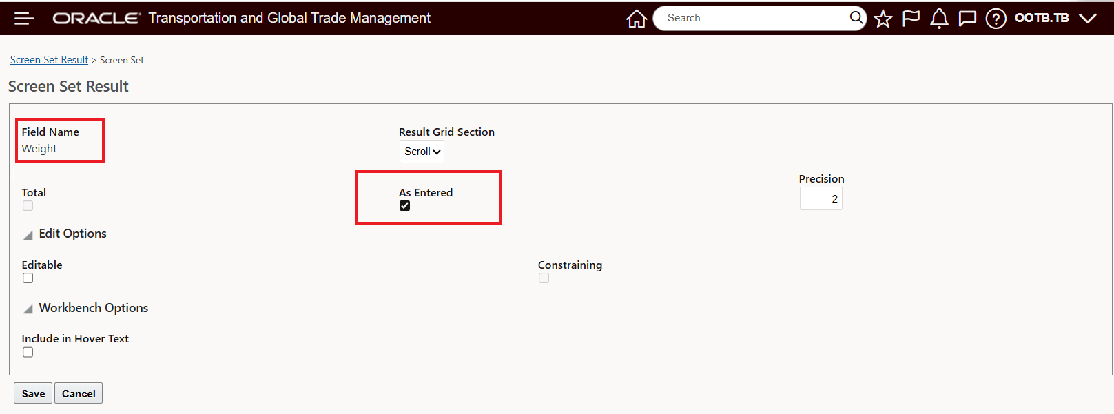

To take advantage of the new As Entered capabilities/configuration option, the Weight for the Screen Set above is configured to display the Weight value As Entered - this is done by selecting the As Entered check box as shown below.
As Entered Configuration
With the Screen Set configured as shown above, the Finder Results now display the Weight UOM values in the As Entered UOM of LB - as shown below.
Weight Displayed As Entered

To configure your UOM fields to display As Entered  - you will need to navigate to Configuration and Administration > User Configuration > Screen Set Manager. Create or edit a record and go to the Results tab. Click the More button on a row UOM row you want to configure.  Following the navigation path will bring up the field shown below.As Entered Option
As Entered Option

The As Entered option is not compatible with the Total option on the screen set, meaning this is an either or option - either you opt to provide Totals or you select As Entered, but both can not coexist.
