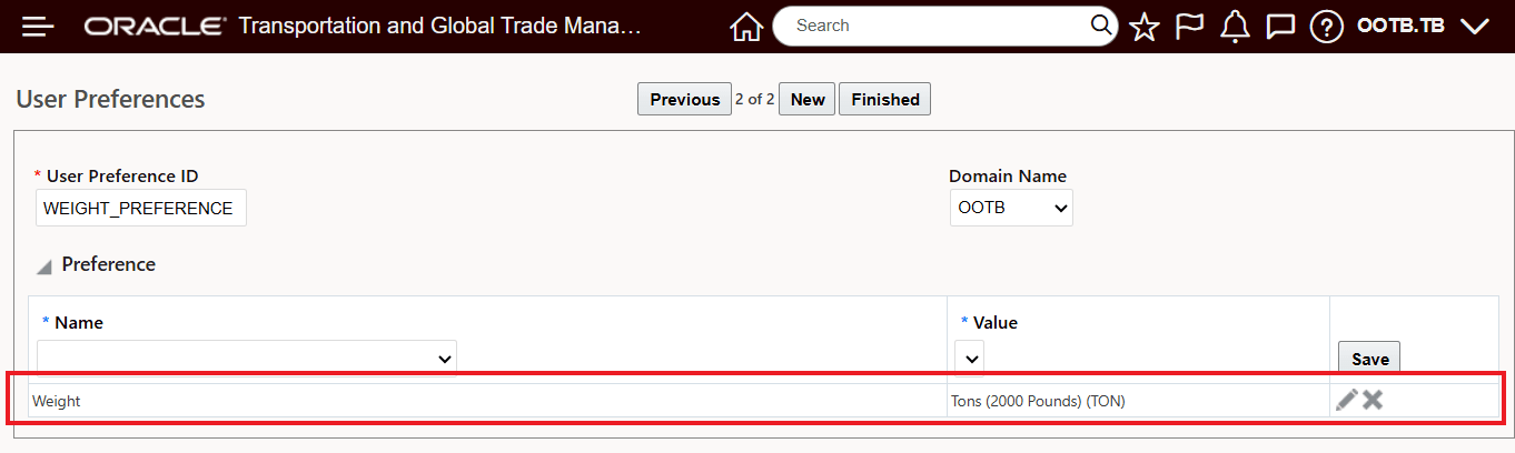

In the example below, the User Preference for Weight has been set to TONs - as shown below.
User Preference - TONs

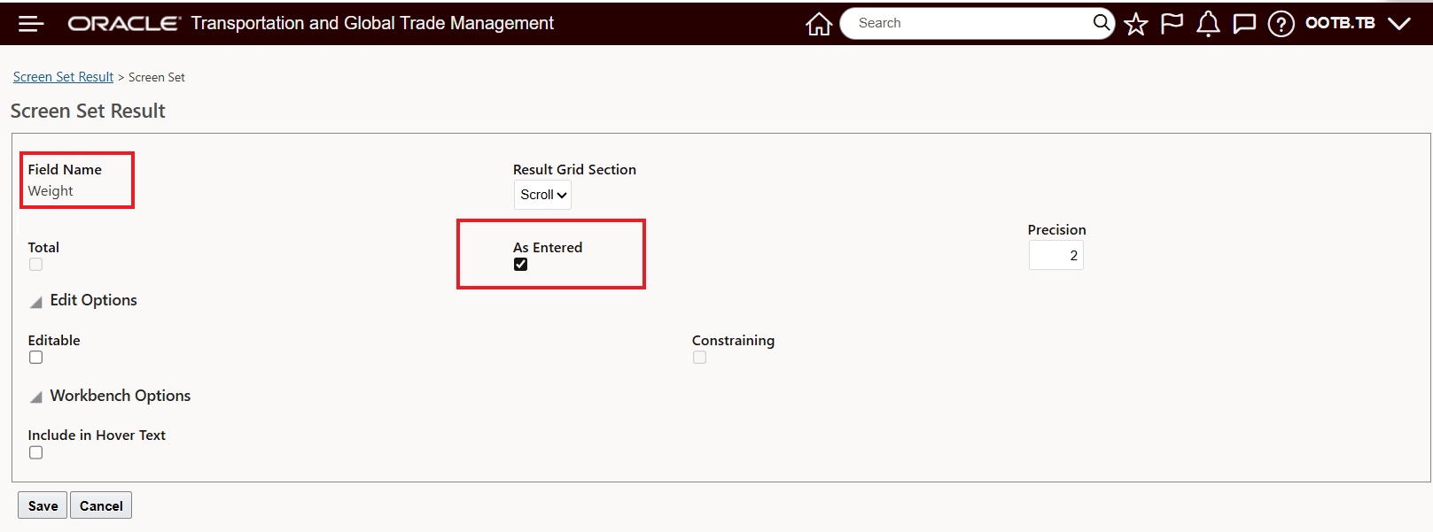

To take advantage of the new As Entered capabilities/configuration option, the Weight for the Screen Set above is configured to display the Weight value As Entered - this is done by selecting the As Entered check box as shown below.
As Entered Configuration
