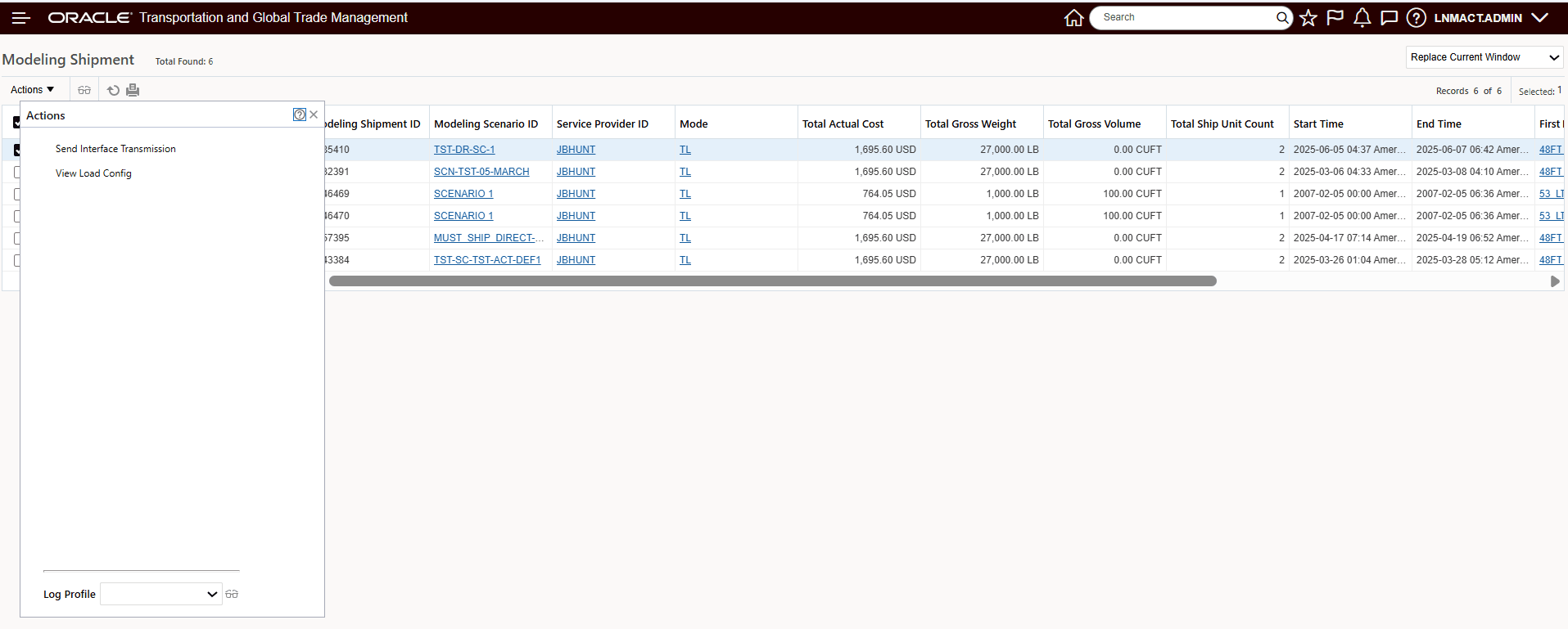

  • UI Action - Send "Send Interface Transmission" on Modelling shipment.
  • Process Management Action - Include Modelling Shipment object under 'Send Integration' action.
Added the action "Send Interface Transmission" on Modelling shipment.
Send interface transmission

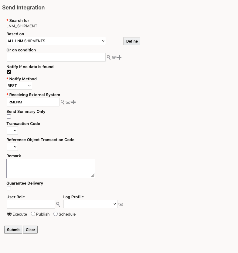

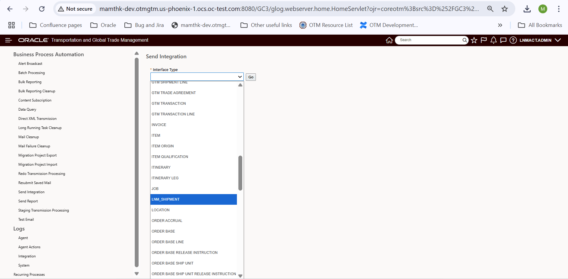

Under the Business Process Automation , the "Send Integration" action include the 'LNM_SHIPMENT' object.
send integration (business process automation -> process management)
only support REST notify method
