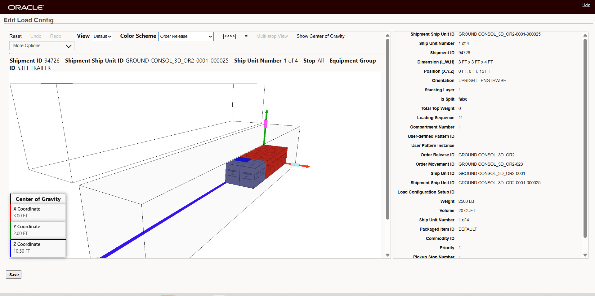

In the example below, A Ground Consol Shipment is used to demonstrate the capability.  In this scenario, the Ground Consol Shipment is originally planned with two order releases - with the planning parameter configured to use 3D Based Load Configuration.  The resulting load configuration is shown below.
Two Orders Planned With 3D Based Load Configuration

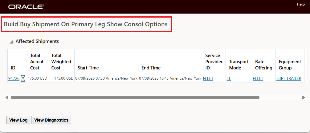

Now a third order is planned using the action Build Buy Shipment On Primary Leg Show Consol Options.

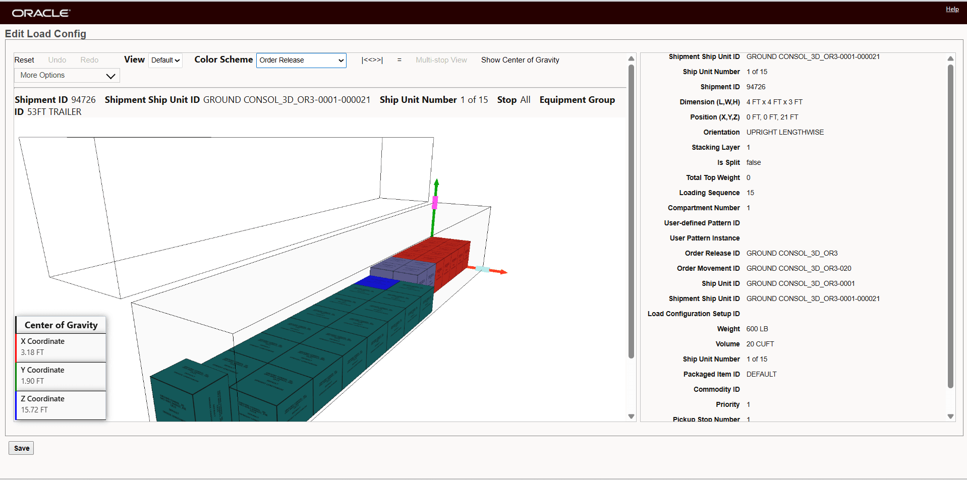

The result of adding the third order is shown below.  In this case the original two orders remain positioned as they were originally, and the additional ship units for the third order are placed into the available space, as shown below.
New Third Order Added To Previously Planned Ground Consol

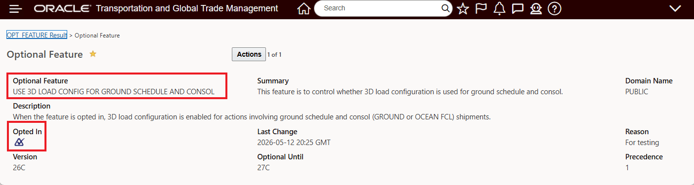

To take advantage of the new functionality - you will need to enable the Optional Feature USE 3D LOAD CONFIG FOR GROUND SCHEDULE AND CONSOL as shown below.
Enable Optional Feature
To change the Opt In state for this feature:
  • Go to the Optional Feature UI - Configuration and Administration > Property Management > Optional Features.
Your user must have the DBA.ADMIN user role to use this functionality.
  • Select the Use 3D Load Config For Ground Schedule And Consol feature.
  • Run the Opt In action.
