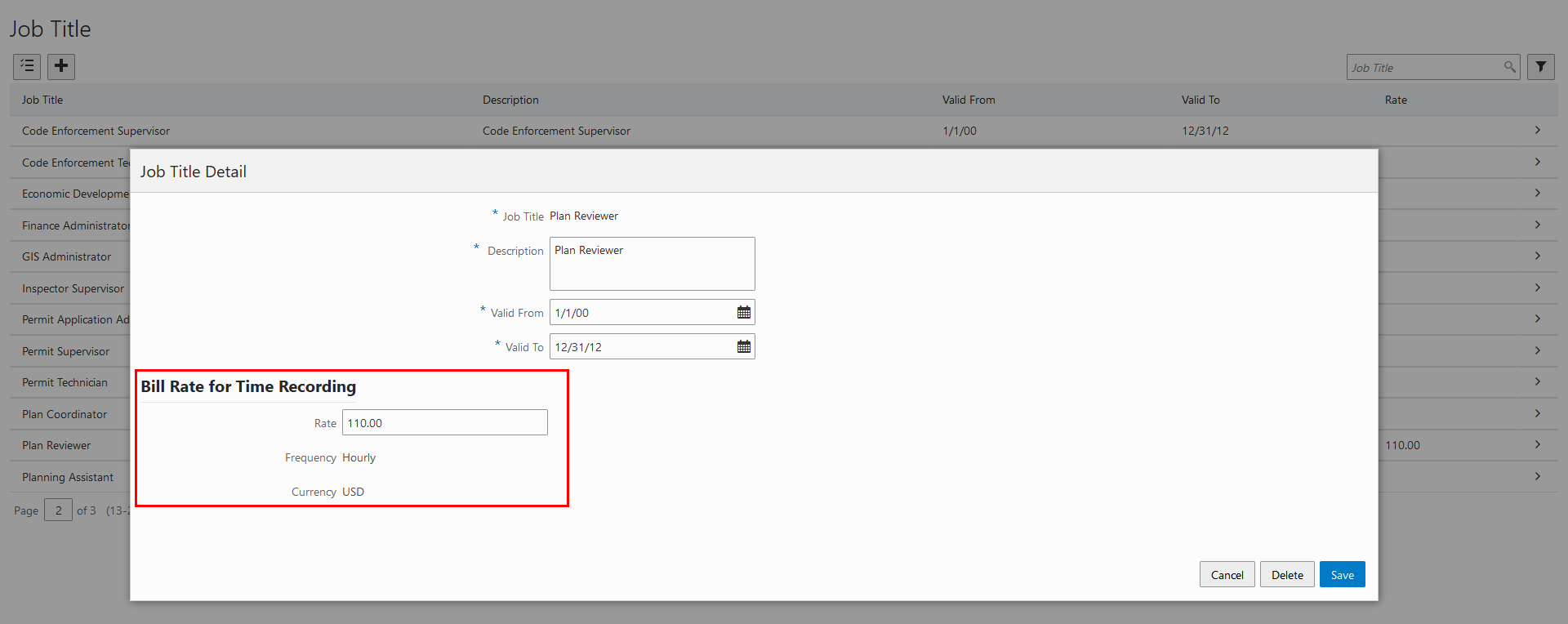

In the example below, a $110 per hour bill rate has been added for the Plan Reviewer job title. When an agency staff member with the Plan Reviewer job title records time in the system, the hourly rate will be used in fee calculations.
Job Title Detail Page - Bill Rate for Time Recording Setup

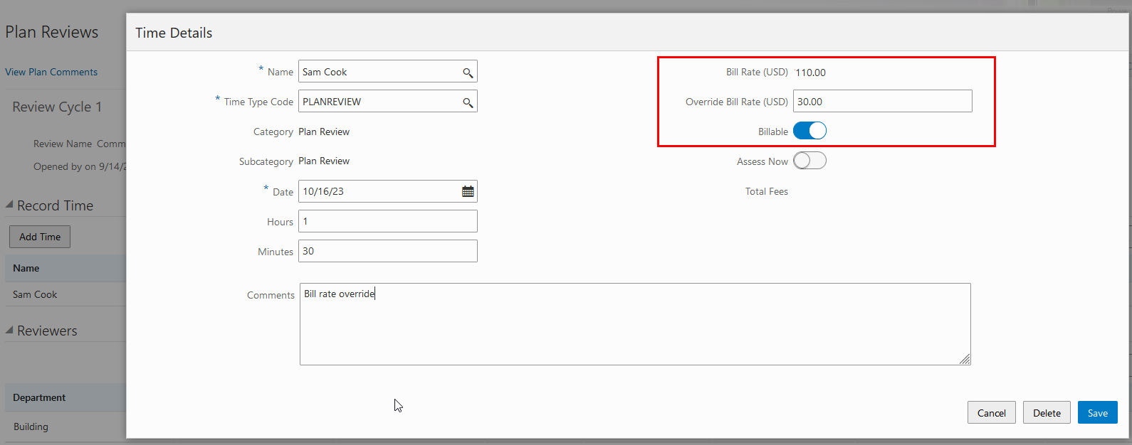

This example illustrates one of the pages used for recording time. In this example, the agency staff member also has been set up with permission to override the default bill rate for the Plan Reviewer job title.
Example of Time Details Page for Recording Time
