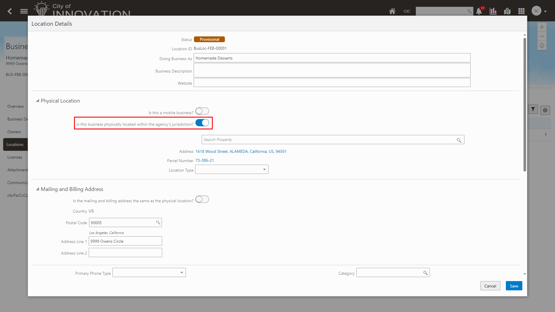

This example illustrates the switch that agency staff turns on to indicate that the physical business location is within the agency's jurisdiction. The switch is on the Location Details page in the business record details.
Location Details Page in the Business Details
Helps to control when inspections are created based on agency jurisdiction.

On the Physical Location section on the Location Details page in Business Details page, turn on the switch, Is this business physically located within the agency's jurisdiction? and select a parcel within the agency's jurisdiction for the pending inspections to be automatically created.
