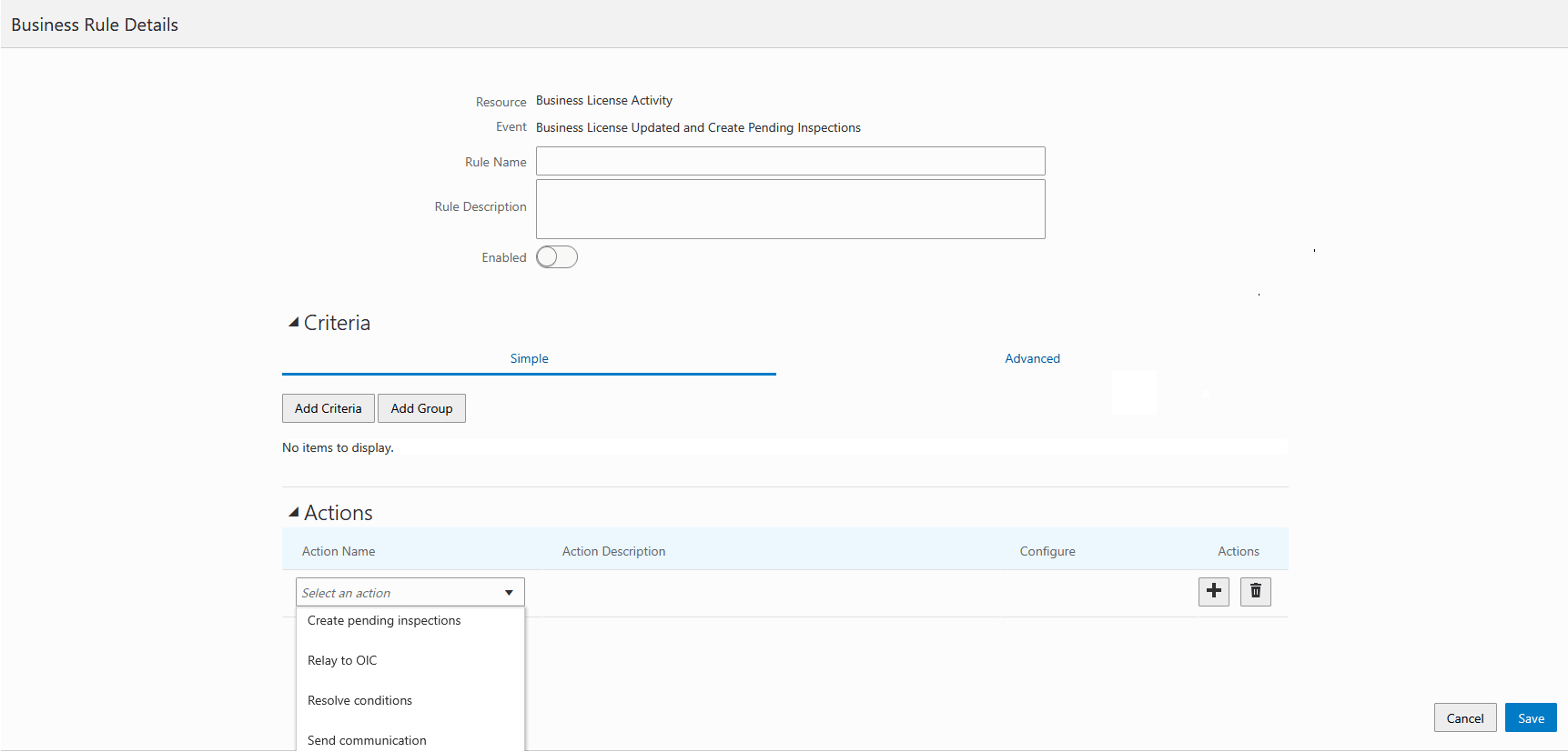

New BRF Action - Create Pending Inspection
When a permit or business license application is submitted, the configured Business Rules Framework rule invokes a backend service that determines the appropriate pending inspections and creates them asynchronously, improving submission performance while maintaining existing inspection creation behavior.

Steps to enable and configure
These default rules are delivered enabled for Permits and Business Licenses. Therefore, there is no setup to create pending inspections. These delivered rules do provide improved performance when the pending inspections are created from:
