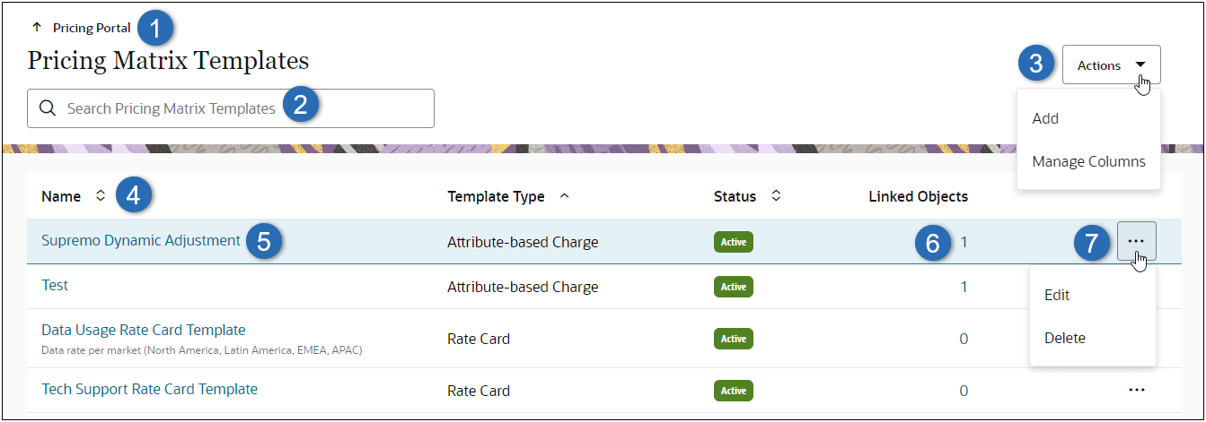

The Pricing Matrix Templates page lists available Attribute-based Charge Templates and Rate Card Templates.
Note: The Rate Card Templates are now supported inside the Pricing Matrix Templates module and are no longer a stand-alone Pricing Portal module. Rate Card Template functionality has not been changed.
Each Attribute-based Charge Pricing Matrix Template can be used to define one or more Charges. Pricing administrators can perform the following tasks from this page:
  1. Navigate to Pricing Portal.
  2. Enter search criteria to filter Pricing Matrix Templates.
  3. Add a new Pricing Matrix Template (Attribute-based Charge or Rate Card) or manage columns.
  4. Sort Pricing Matrix Templates using the Name, Variable Name, Template Type, or Status column headers.
  5. Edit an existing Pricing Matrix Template by clicking on the Name link or selecting Edit from the line ellipsis drop-down.
  6. View linked Price Models or Rate Cards by clicking on the Linked Objects number.
  7. Edit or Delete an existing Pricing Matrix Template by clicking on the line ellipsis.
    • Note: Pricing Matrix Templates with linked Price Models cannot be inactivated or deleted.

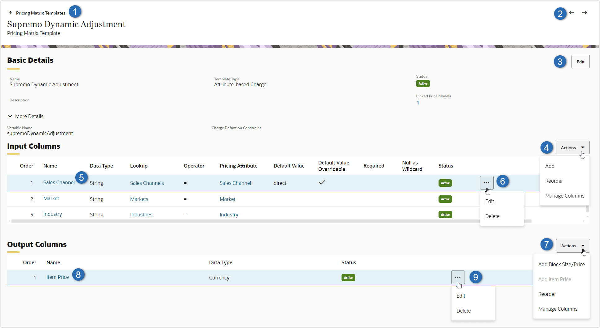

The Pricing Matrix Template page for an Attribute-based Charge type Template shows the basic details. It also lists the Input Columns and Output Columns that define the custom dynamic matrix. Pricing administrators can perform the following tasks from this page:
  1. Navigate to Pricing Matrix Templates list page.
  2. Navigate to Next or Previous Pricing Matrix Template in the Pricing Matrix Template list or filtered Pricing Matrix Template search results list.
  3. Modify the Basic Details for the Attribute-based Charge Template. If applicable, a Charge Definition Constraint can be specified in this section.
  4. Add, Reorder, or Manage Columns for the input column lines.
  5. Edit an existing input column by clicking on the Name link or selecting Edit from the line ellipsis drop-down.
  6. Edit or Delete an existing input column by clicking on the line ellipsis.
  7. Add Block Size/Price attributes, Add an Item Price Attribute, Reorder, or Manage Columns for output columns.
    • Note:  Both Block Size and Block Price attributes are added when Add Block Size/Price is selected. Correspondingly, if the Block Size attribute or the Block Price attribute is deleted, both of these interdependent attributes are also deleted.
  8. Edit an existing output column by clicking on the Name link or selecting Edit from the line ellipsis drop-down.
  9. Edit or Delete an existing output column by clicking on the line ellipsis.

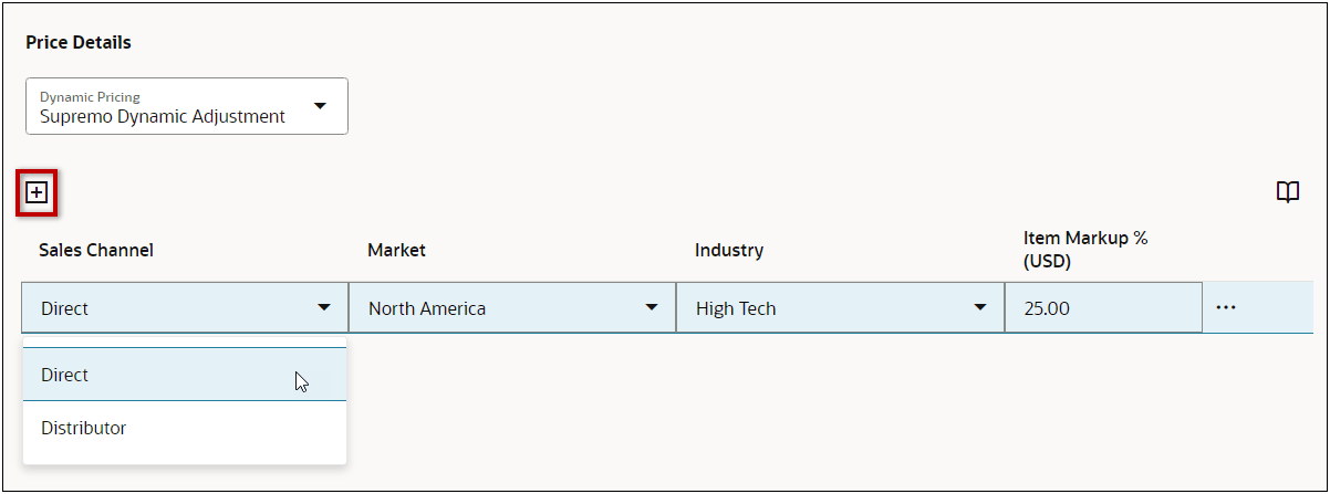

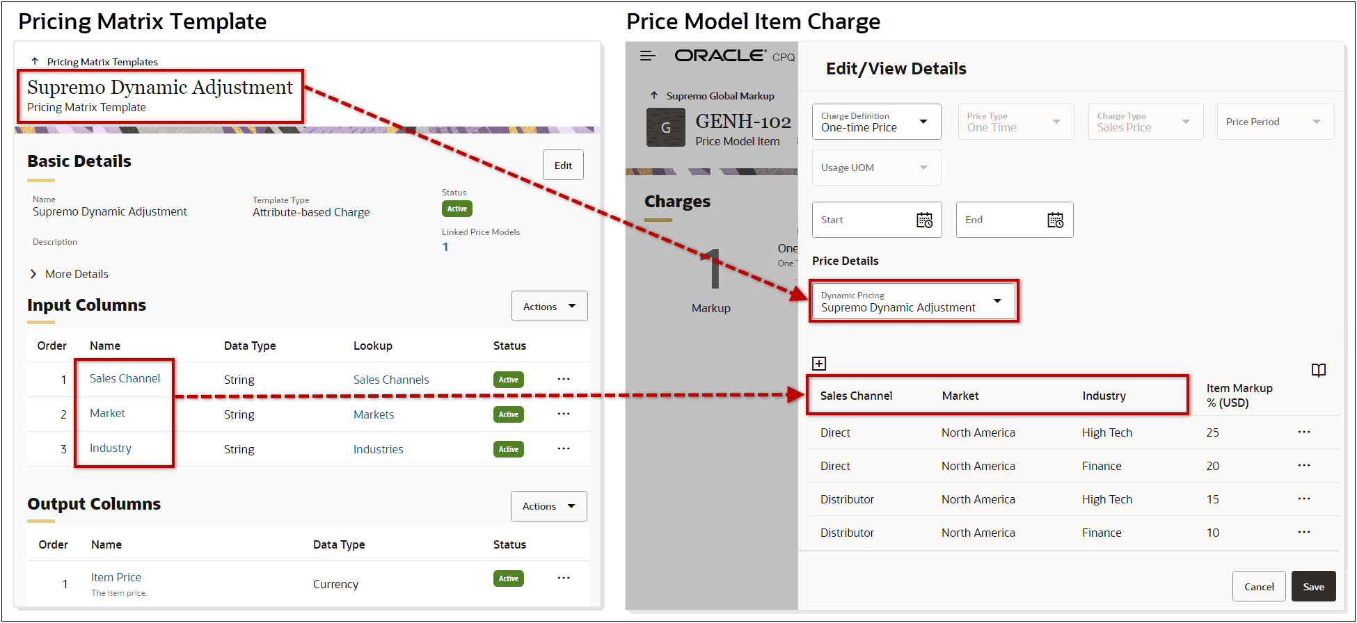

To add dynamic matrix pricing to a Price Model Item charge, the pricing administrator begins by selecting a customer pre-defined Attribute-based Charge Pricing Matrix Template from the charge Dynamic Pricing drop-down.
Add Matrix Pricing to a Charge
After selecting the appropriate Pricing Matrix Template, the pricing administrator clicks the + icon to add a conditional row item to specify conditions and pricing.
  • The column items are determined by the selected Pricing Matrix Template Input Column definitions. In the example below, the selected definitions are Sales Channel, Market, and Industry.
  • The column menu items are defined by the Lookup item selected for the given column in the Pricing Matrix Template. For example, the Sales Channel column from the Supremo Dynamic Adjustment template is linked to a Pricing Lookup that provides the 'Direct' and 'Distributer' values.
  • The item pricing is determined by the parent Price Model's list type and adjustment type (for discount and markup lists). For example, Item Markup % is defined by the parent Markup List type Price Model with a Percent adjustment type. If a customer implementation uses block pricing, Block Size and Block Price attributes can also be added.

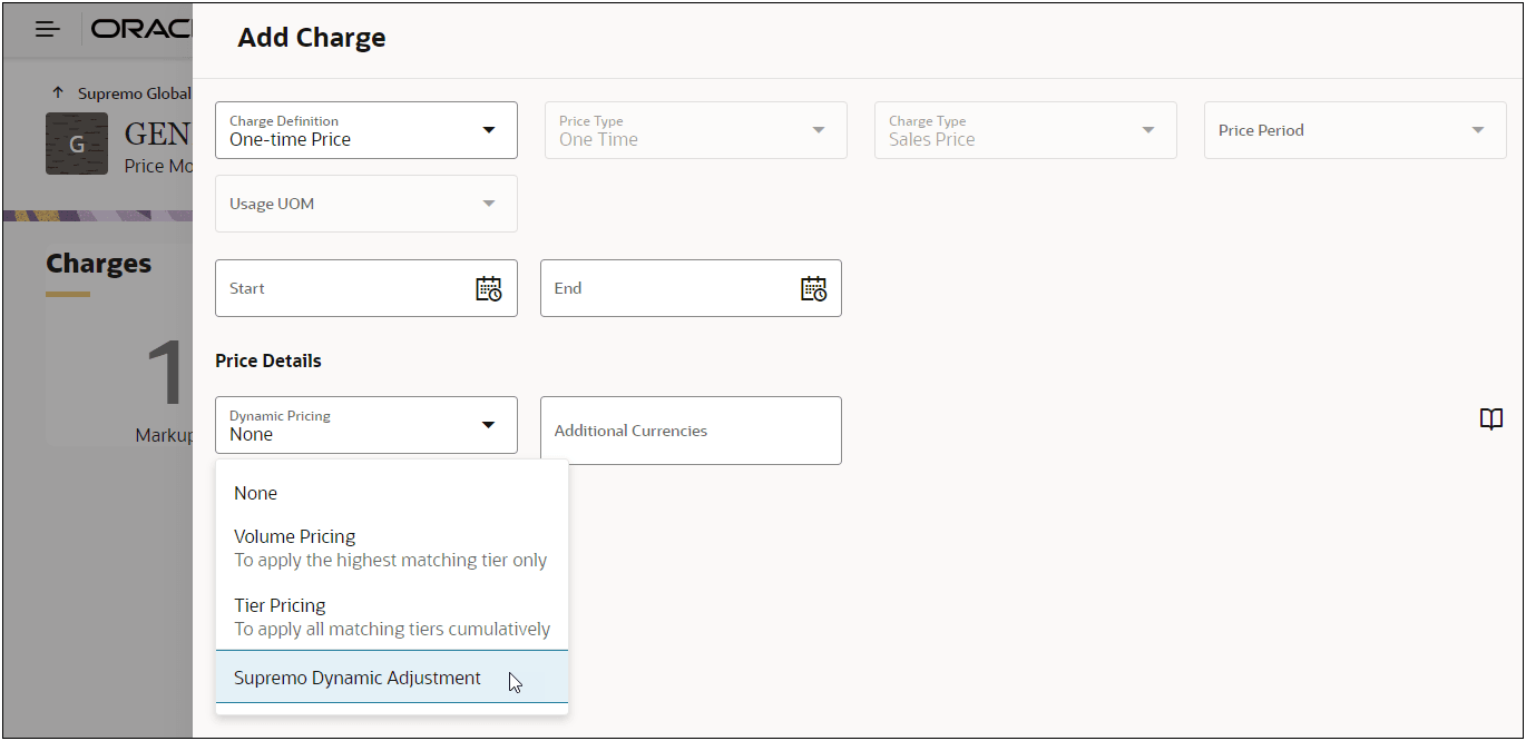

  4. Complete the following steps to add dynamic matrix pricing to a charge item.
    1. Select the appropriate Attribute-based Charge Pricing Matrix Template from the Dynamic Pricing drop-down.
    2. If additional currencies are required in the pricing matrix complete the following steps.
      • Click the 'book' icon.
      • Check the applicable currencies.
      • Click Apply.
    3. Click the + icon to add a conditional row item.
    4. Enter or select the conditional values for each column.
    5. Enter the applicable pricing.
