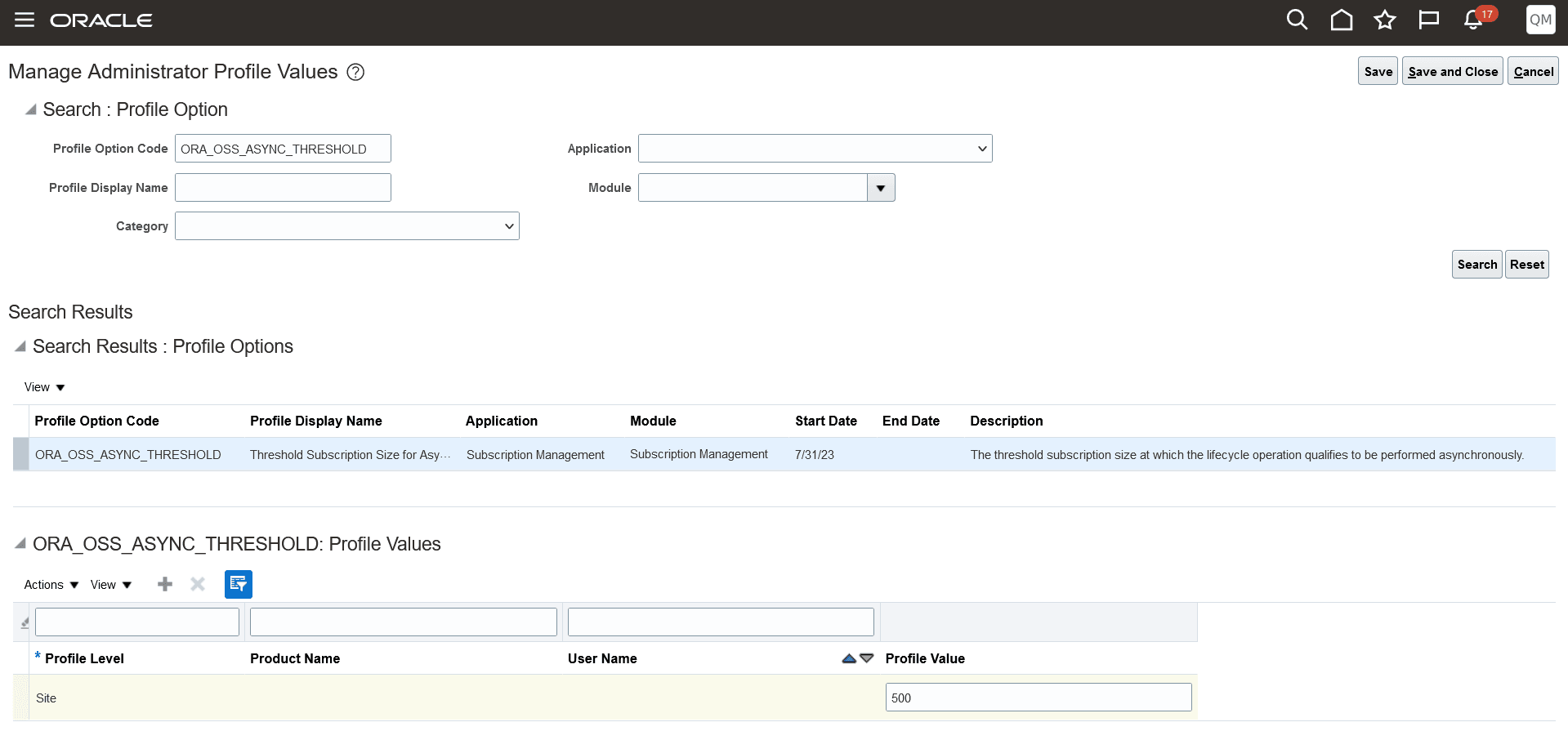

You can decide what qualifies as large volume of data by setting the profile option - Threshold Subscription Size for Asynchronous Lifecycle Operation (ORA_OSS_ASYNC_THRESHOLD)
Profile Option for Subscription Threshold

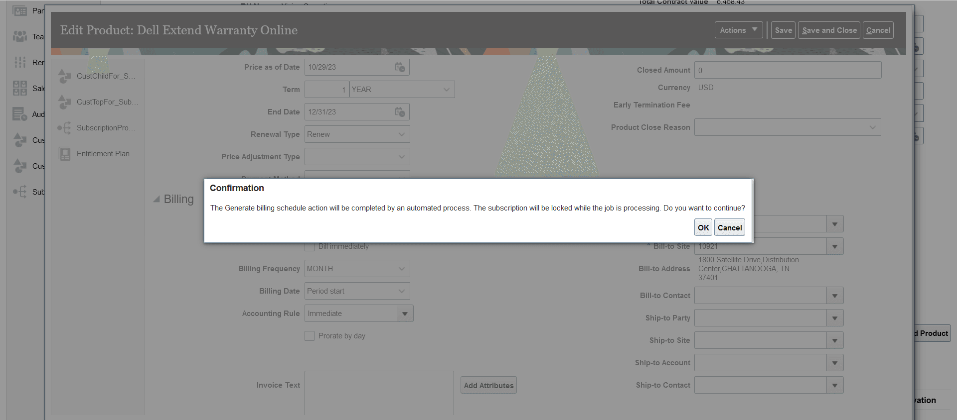

When a subscription qualifies as one with a large volume as per the above threshold setting, application displays a confirmation message asking whether you want to go ahead with asynchronous processing of the transactions such as Generate Billing Schedule or Reprice.
Profile Option for Subscription Threshold Confirmation
Confirmation for Asynchronous Transaction

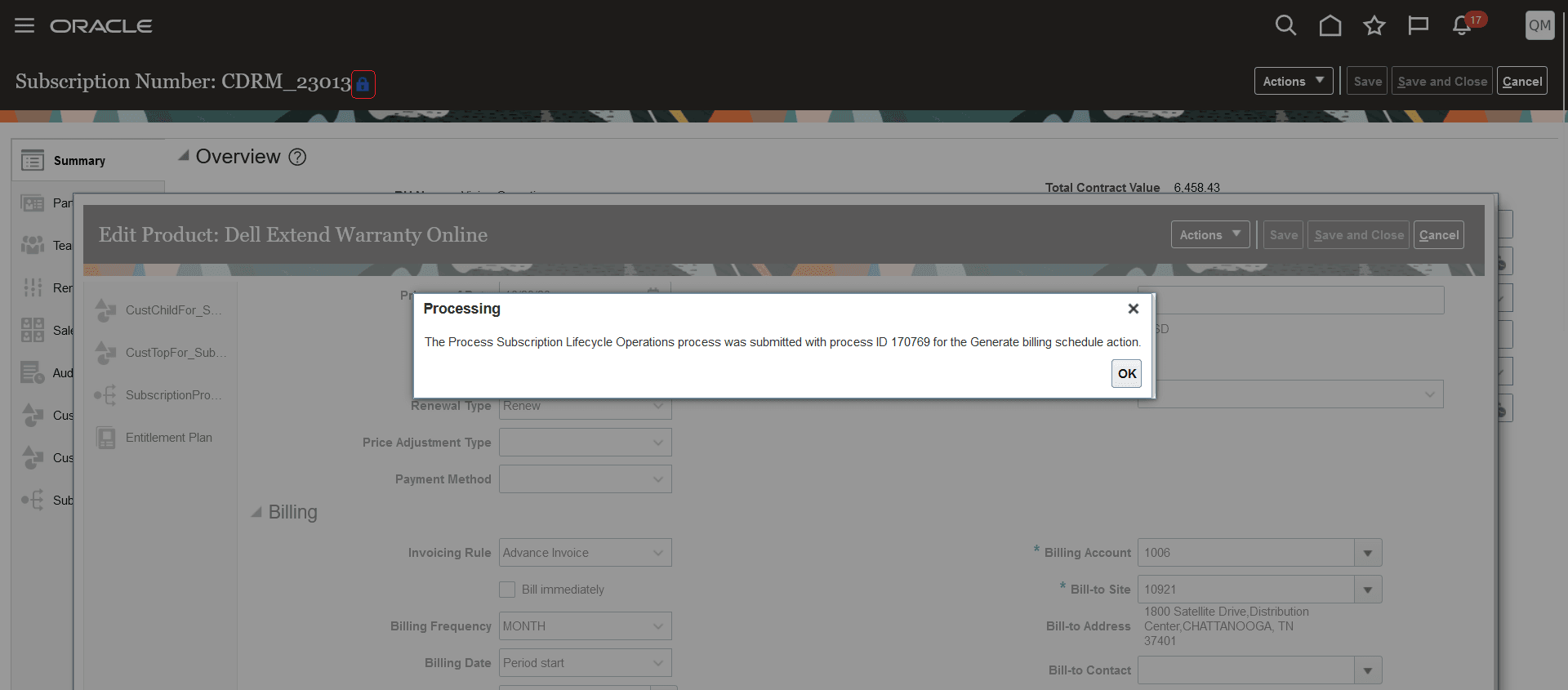

On choosing to proceed with asynchronous processing of the subscription transaction, the following message is displayed and the subscription is placed in a read-only mode by locking it.
Subscription Locked

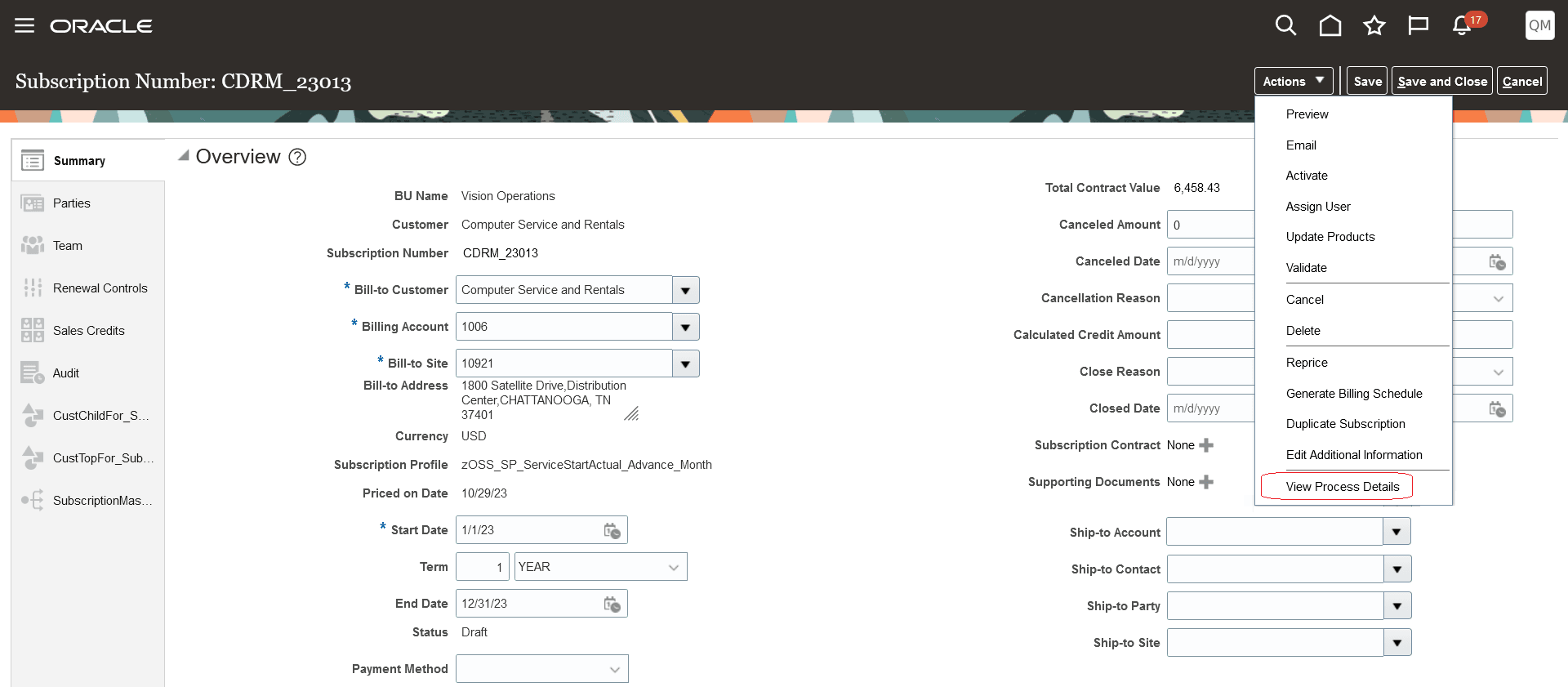

You can find the status of the subscription transaction by using the new action 'View Process Details'.
Subscription Locked

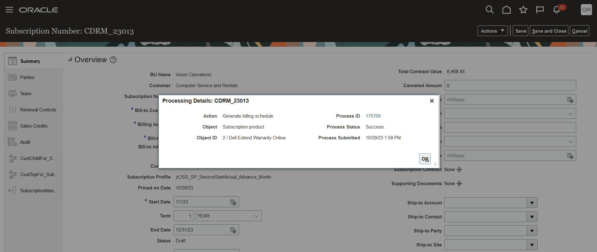

You can view the transaction status as shown below:
Status
