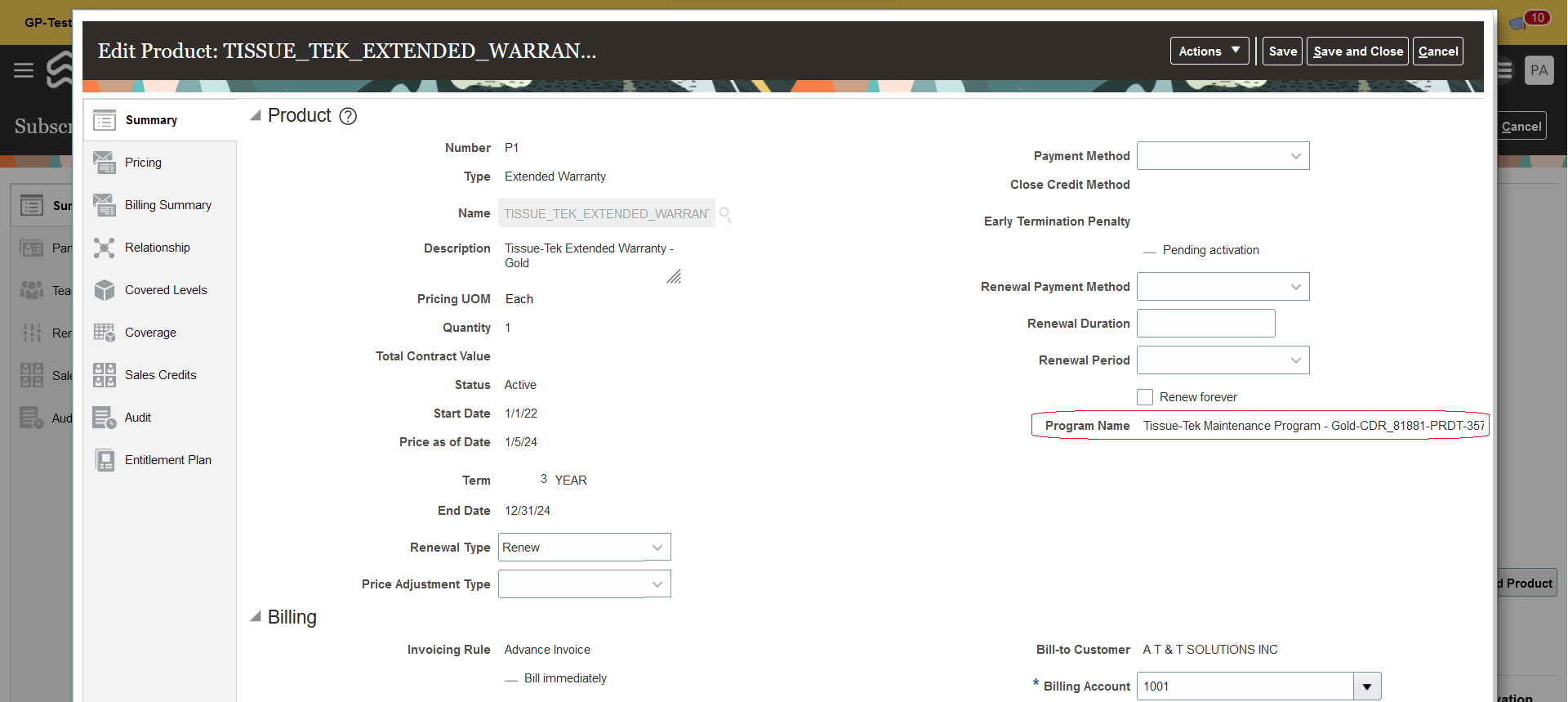

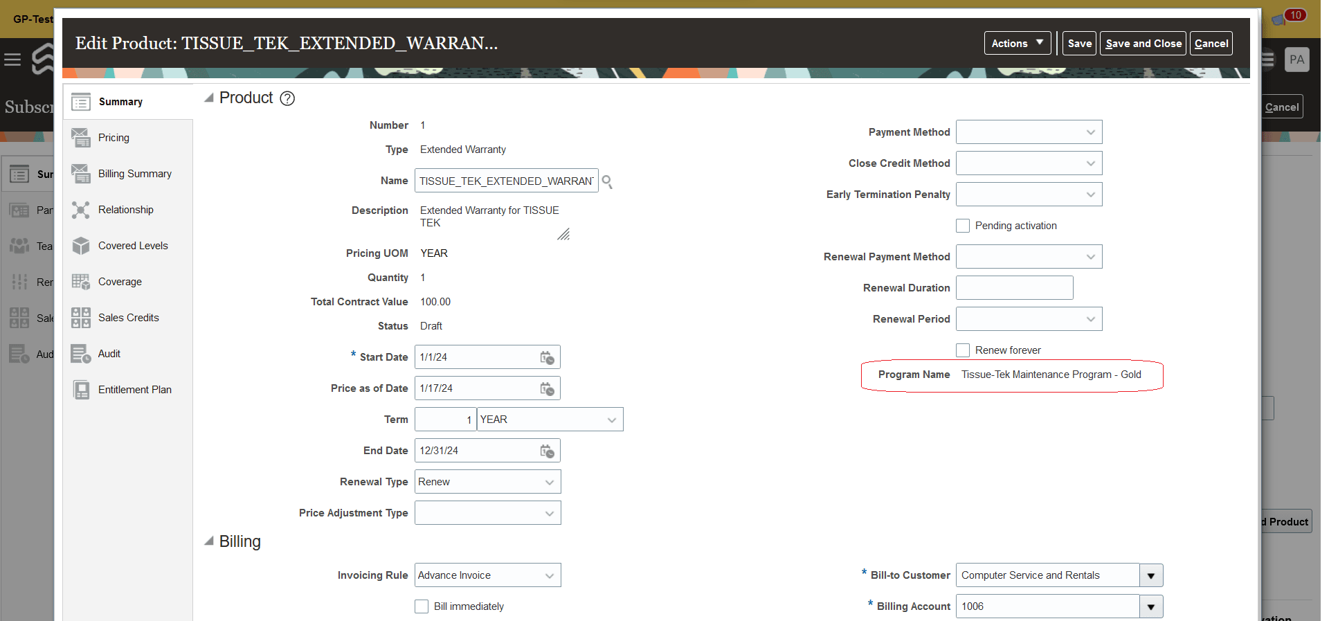

By associating a maintenance program template to the coverage product, create a maintenance program for the covered levels. This maintenance program will be, subsequently, converted to one or more work orders and service requests in the downstream applications to support the preventive maintenance for the covered levels.
Because of the coverage template association, you can see the preventive maintenance program in the Edit Product screen.
Preventive Maintenance Program
You can modify the program by editing the standard coverage or switching to a different standard coverage.
