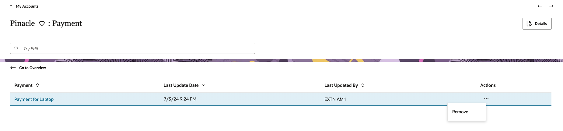

In the 1M related object subview, the “Remove” action is available.
Steps to Enable and Configure
Leverage Application Composer to expose and adjust page layout and attributes. To learn more about extending your application using Application Composer, visit Oracle Help Center > your apps service area of interest > Books > Configuration and Extension.
This action is generated when a subview is created using extension generator. Admin needs to create this action for the existing subview.
Before generating files in Extension Generator, Custom object should be published and enabled for Elastic search or set the  "primaryKey": "Id" for "resource" parameter in cx-subview fragment.
