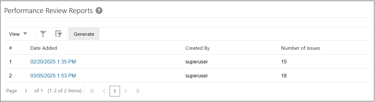

When an administrator navigates to Admin > Developer Tools > Performance Reviewer a list of reports is displayed. They can click Generate to start a new report or click on a report to view the report details.
The report displays the issue location and gives a brief description of the issue. The administrator can click on the location quick link to quickly navigate to the source of the issue.
