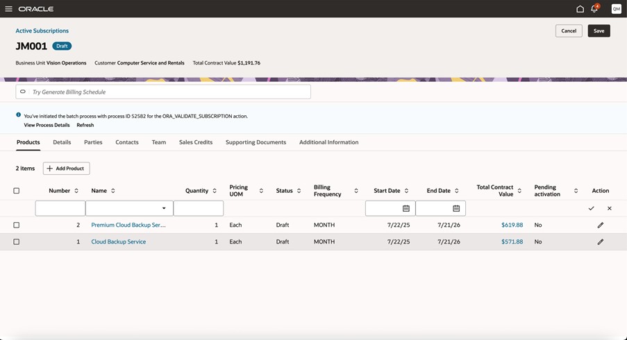

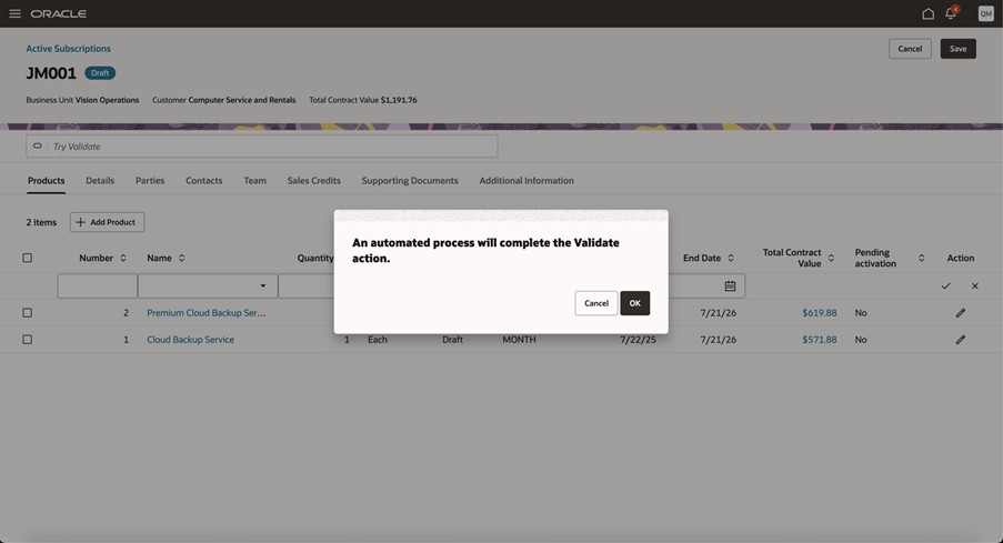

When you click Validate on a subscription, the system checks whether the subscription qualifies for asynchronous processing.
  • If not eligible, validation happens immediately in a synchronous manner, as before.
  • If eligible, the application displays a confirmation message. Upon confirmation, the system submits the validation job to run in the background and displays a message indicating the job has started.
Pop up for Asynchronous Validation
Start of Job for Validation in ADF UI
Start of Job for Validation in Redwood UI
View Process Details in ADF UI
View Process Details in Redwood UI

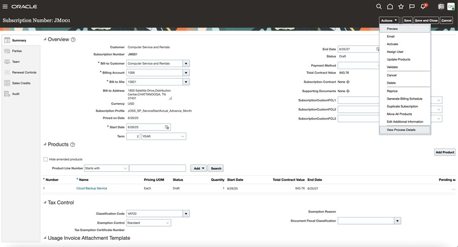

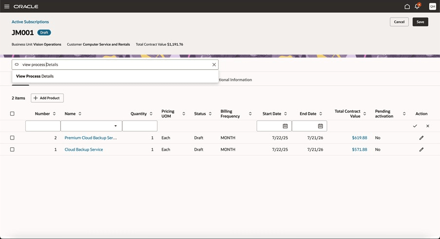

You can view the status of the validation job using the View Process Details option, now available in the Actions menu.
View Process Details after the Validation Job Starts in ADF UI
View Process Details after the Validation Job Starts in in Redwood UI

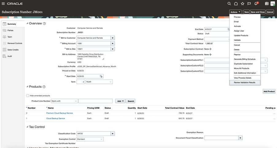

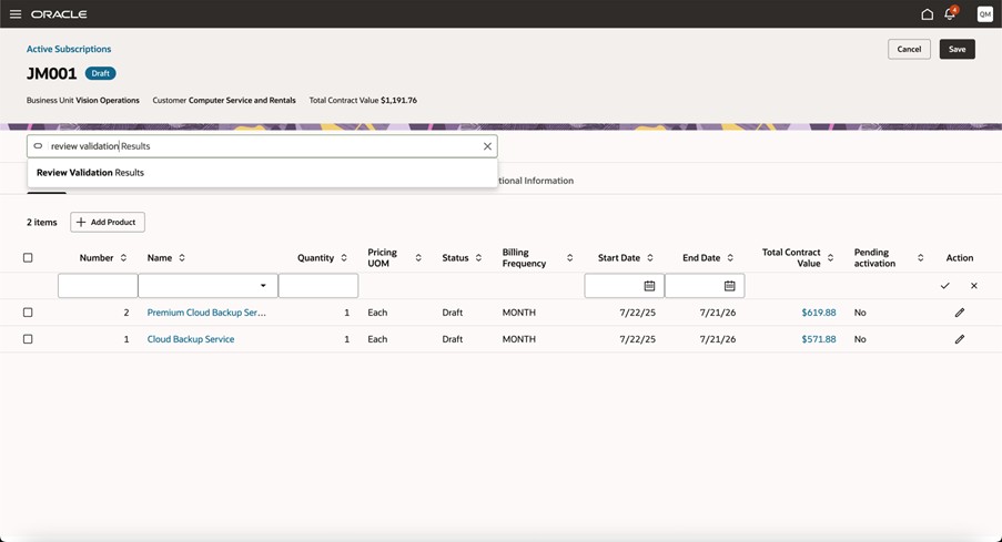

If any validation results are generated, you can view them using the new Review Validation Results menu item. This page shows all validations associated with the subscription. If no validation is found, the system displays a message indicating so.
Review Validation Results Action
Review Validation Results Action in ADF UI
This action will open the Validations UI which shows all the validations that ended in warning or error. You can activate the subscription from here.
Review Validation Results Action in Redwood UI
View Validation Results in Redwood UI

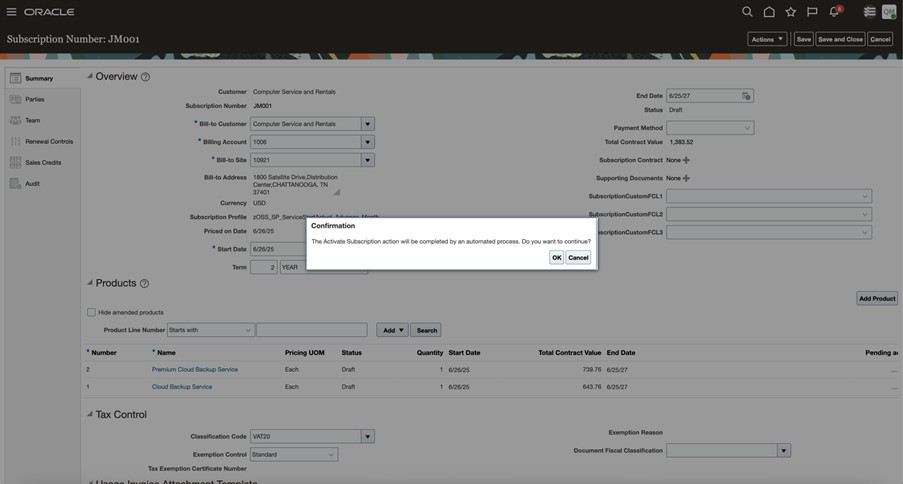

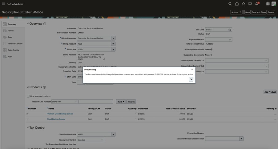

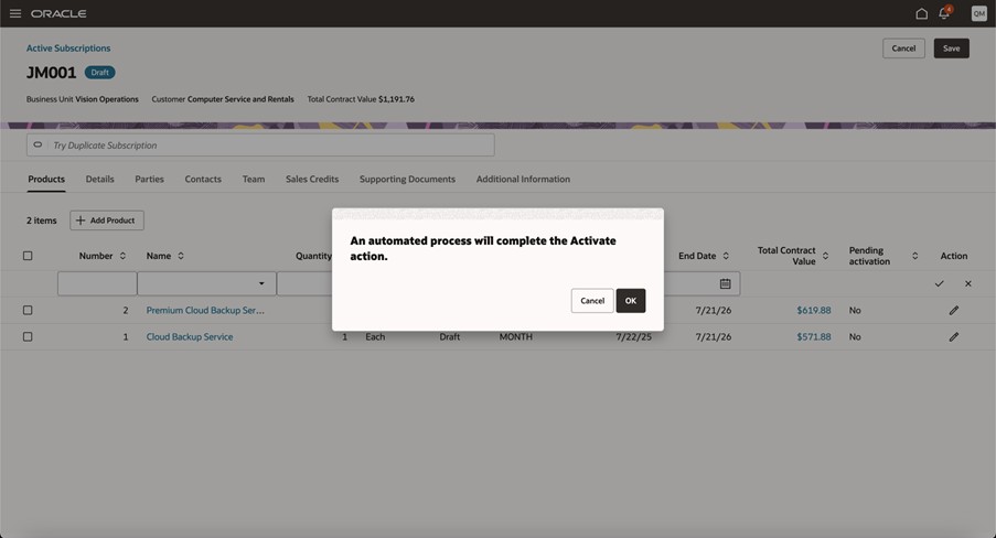

When you click Activate, the system performs the same eligibility check.
•    If the subscription qualifies, a confirmation message is shown.
Asynchronous confirmation after activate
Asynchronous Activation Confirmation after clicking Activate Action in ADF UI
Asynchronous Activation Confirmation after choosing Activate Action in Redwood UI

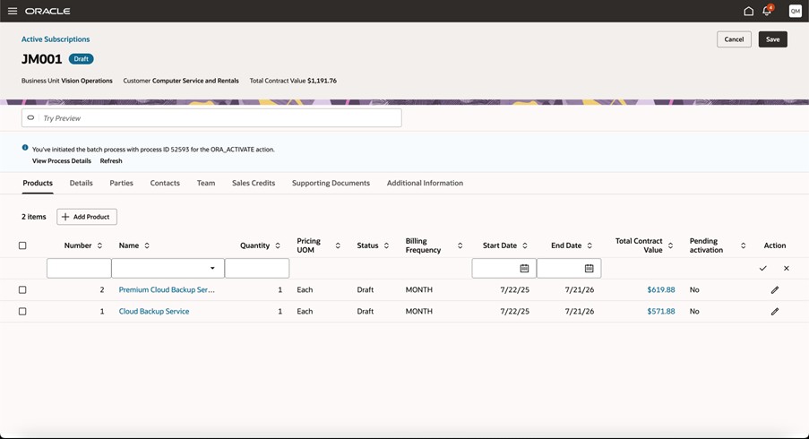

After confirmation, the system re-validates the subscription:
  • If validation is successful, the activation job is submitted.

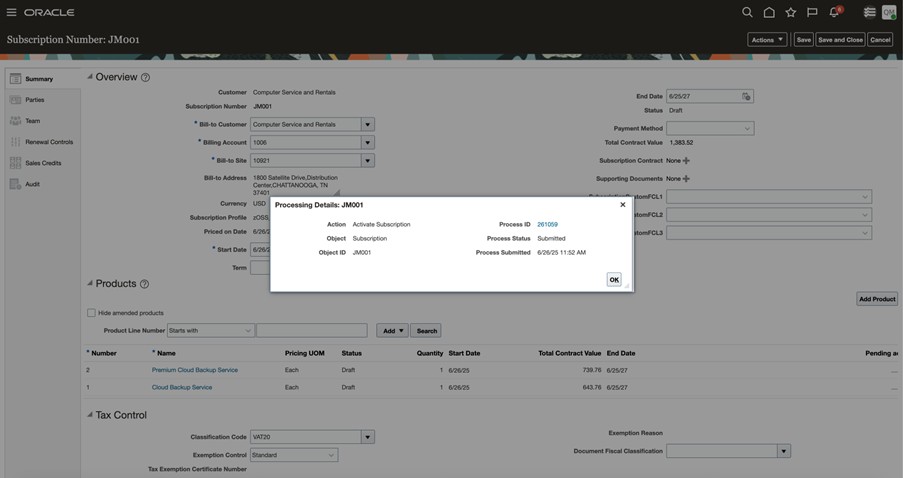

Process Submitted for Activation
Process Submitted for Activation in ADF UI
Process Submitted for Activation in Redwood UI

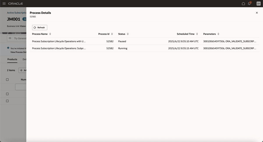

The status of the activation process can be monitored via the View Process Details option.

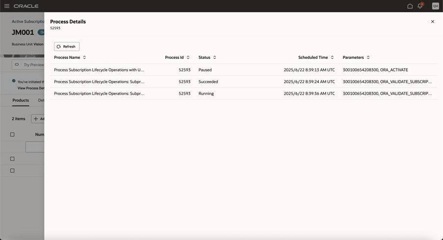

Process Details with Submitted Process
Process Details with Submitted Process in ADF UI
Process Details with Submitted Process in Redwood UI

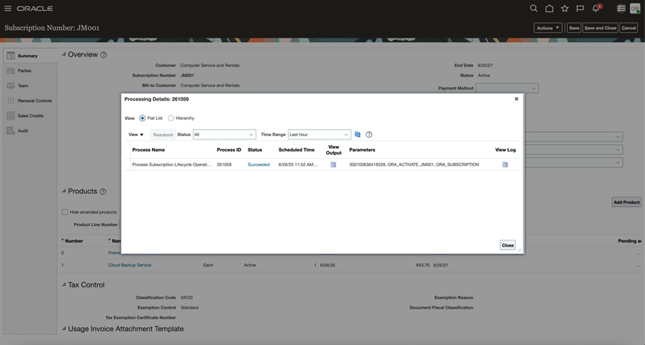

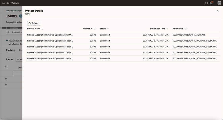

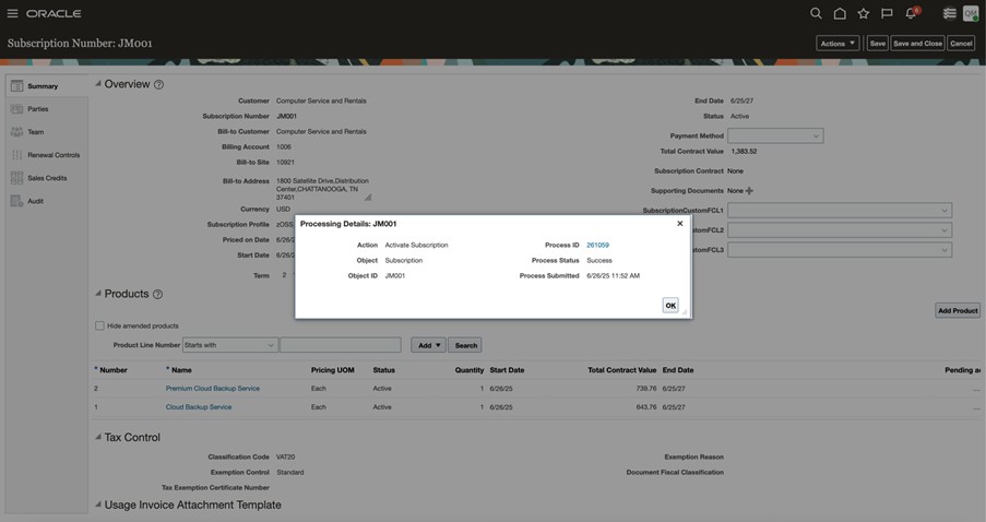

Process Details with Success on Activation
Process Details with Success on Activation in ADF UI
Process Details with Success on Activation in Redwood UI
Process Details pop up from the link on View Process Details
