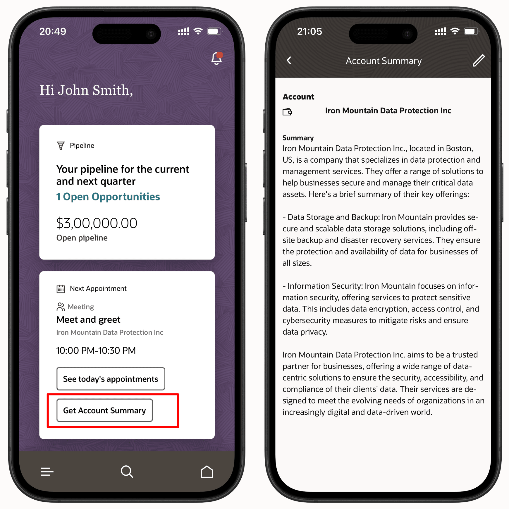

Generate Account Summary using Generative AI
With the CX Sales Mobile Application, sellers can now use Generative AI to get summaries for the accounts they are scheduled to meet with. The AI summary is drawn from public knowledge of the account. Sellers can edit the summary, add their own notes, and save it to the account record for future reference. If a previously generated account summary exists for a specific account, it will be resurfaced when Account Summary is invoked. By default, the summary is saved in the standard Description field; however, there is also an option to use a custom field that supports long text.
This streamlines meeting preparation by providing sellers with AI-generated, concise account summaries, reducing time spent gathering background information.

Steps to Enable and Configure
Leverage Application Composer to expose and adjust page layout and attributes. To learn more about extending your application using Application Composer, visit Oracle Help Center > your apps service area of interest > Books > Configuration and Extension.
  1. In a publishable sandbox, navigate to Application Composer > Mobile Application Setup > CX Sales Mobile Composer > Settings.
  2. In Generative AI Settings, expand Generative AI for Accounts.
  3. Turn on the Account Summary toggle.
  4. Setup access controls Assigned Regions and Assigned Roles based on business need.
  5. Click Save.
