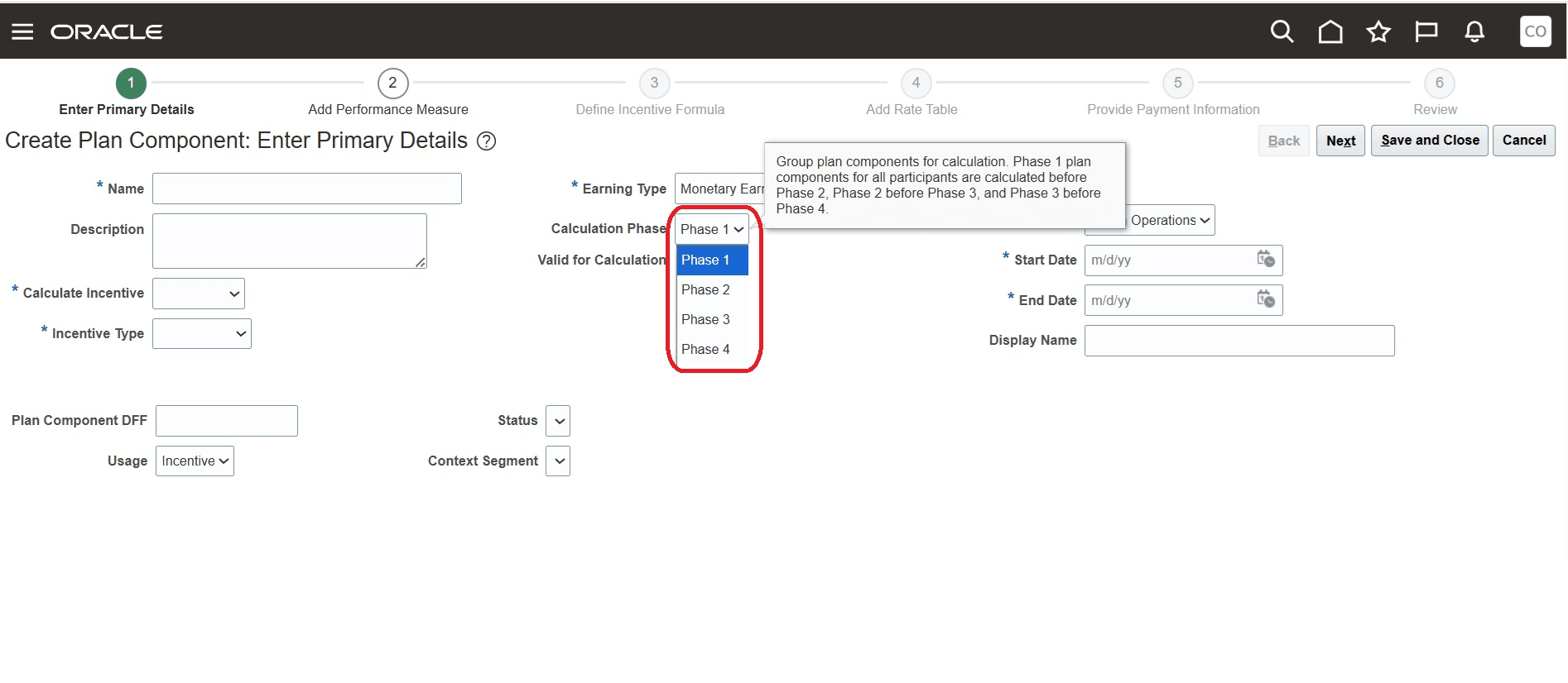

Use up to 4 phases of calculation by defining plan components with phases ranging from phase 1 to phase 4. Depending on the plan components that are being calculated in a specific calculation batch, calculation can run up to 4 phases. Example: If a specific calculation batch includes plan components with calculation phase from phase 1 to Phase 4, the calculation process will include sub-processes which calculate phase 1, phase 2 ,phase 3 and phase 4 components serially. On the other hand, if a specific calculation batch includes only Phase 1 plan components, the calculation will only submit a phase 1 sub-process without any sub-processes being created for phase 2, phase 3 and phase 4.

Configure complex plans where the calculation results of one phase depends on the output of plan components from an earlier phase.
