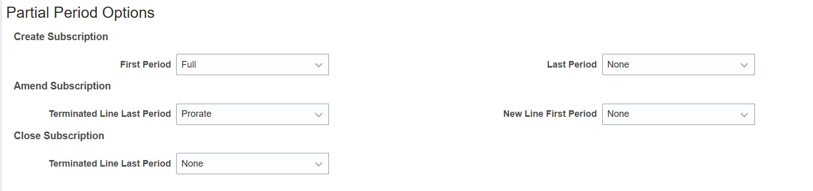

In the Balance Profile a new section Partial Period Options has been introduced. This captures how the first and last period allowance values should be adjusted when creating a subscription, amending a subscription and closing a subscription.
The values above can be overridden at the time of creating a subscription, closing subscription and amending subscription. These values are also defaulted when you add Adjustments for Ballance periods that have not be rated and billed.

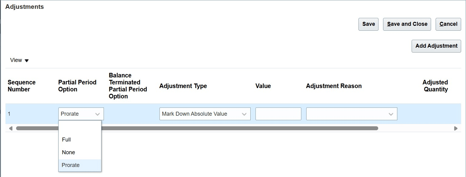

Adjustments in Balance Register

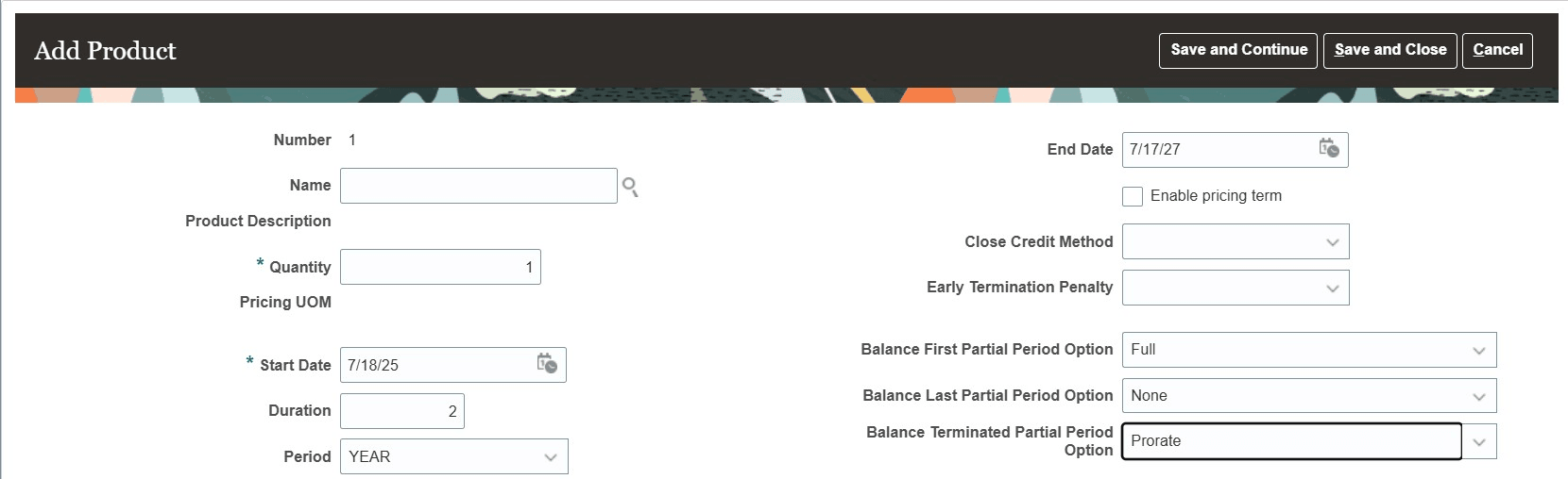

While creating a subscription 3 new attributes are shown (these have to be exposed using Application Composer)- Balance First Partial Period Option, Balance Last Partial Period Option, and Balance Terminated Partial Period Option.
Create Product

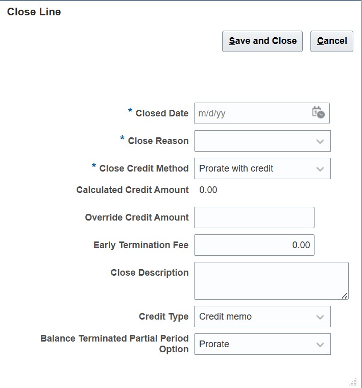

While closing a subscription product a new attribute Balance Terminated Partial Period Option is shown which is defaulted from the Balance profile attribute Terminated Line Last Period.
Close Product

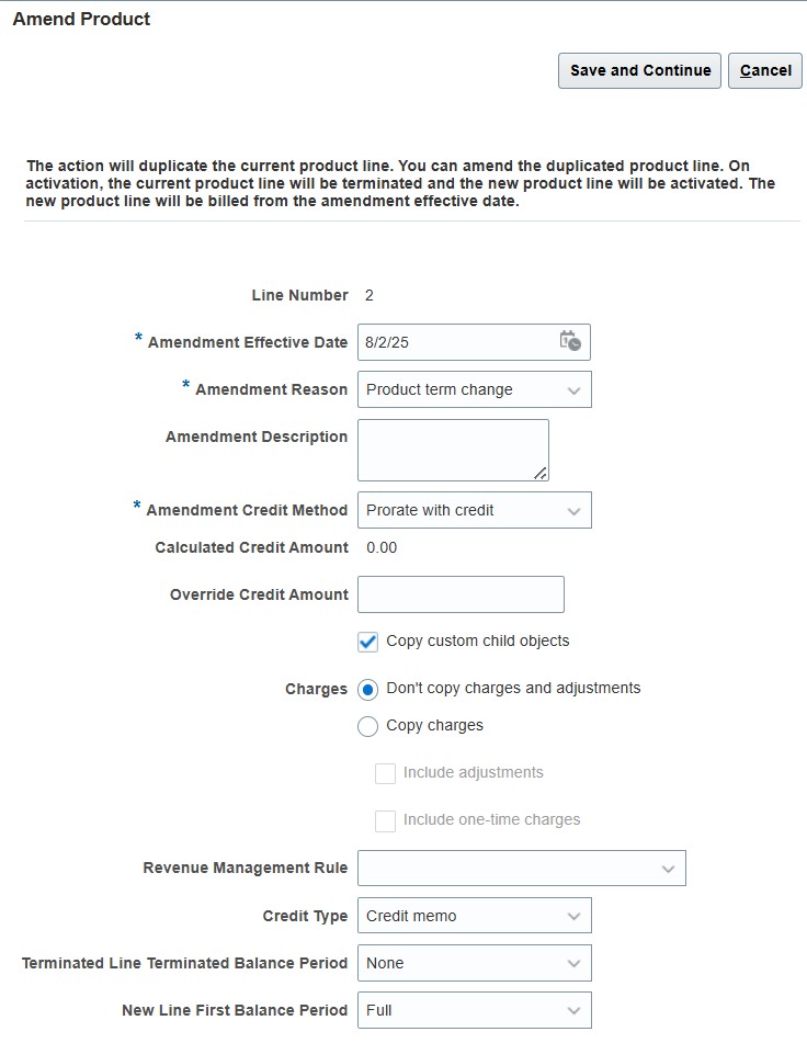

When amending a subscription product 2 new attributes Terminated Line Terminated Balance Period and New Line First Balance Period are shown whose values are defaulted from the Balance profile attributes bearing the same names.
Amend Product

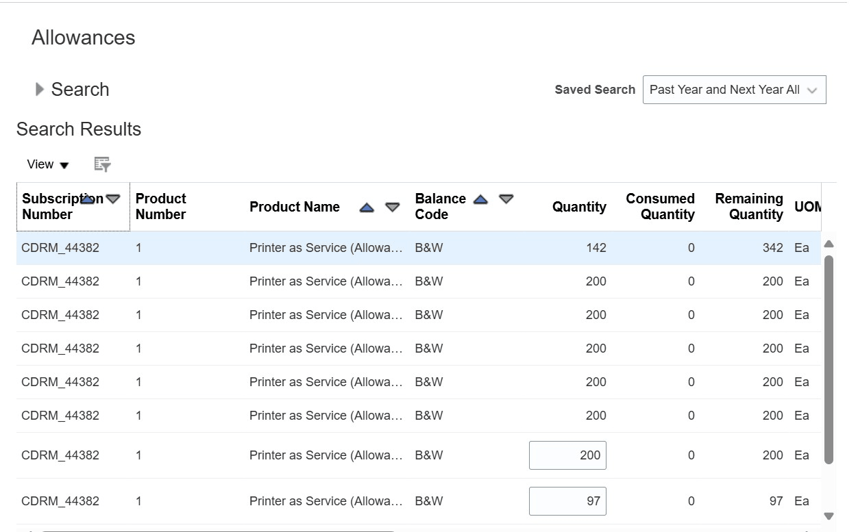

For a subscription product with start date as 10-Jan-2025 and end date 15-Aug-2025, and Balance First Partial Period Option, Balance Last Partial Period Option both as Prorate, the Allowances in the Balance Register shows as follows. The First and last balance periods have the Allowance Quantity of 200 prorated.
Allowance per Period

- Adjustments can be added for both Quantity and Amount based entitlements.
- Adjustment are applied per charge/balance period per subscription product quantity.
- Adjustments can only be added. They cannot be edited or deleted once saved.
- Cumulative adjustments are not supported. That is, second adjustment won't perform on the output of first adjustment. Each adjustment will be performed on top of initial quantity.
- Adjustment resulting in a negative entitlements balance are considered as 0.
