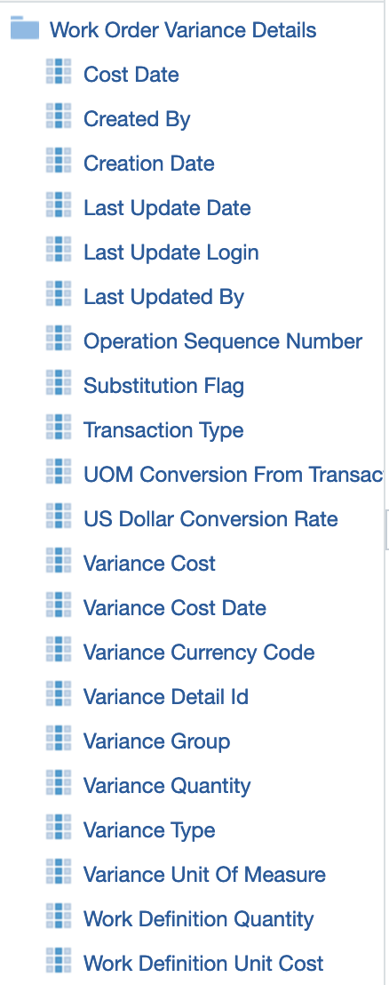

- In the Work Order Costs Real Time subject area, Work Definition Unit Cost attribute is available to analyze variances:
Work Definition Unit Cost - This is the unit cost calculated using the work definition of the product.

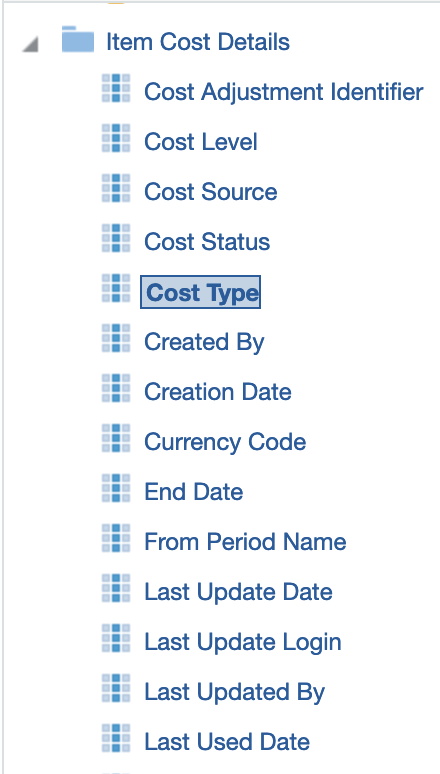

- In the Standard Cost Real Time subject area, the Cost Type attribute is available to track user entered buy cost of component and standard cost of component.
Cost Type - Indicates whether this is the buy cost or standard cost.
Cost Type
