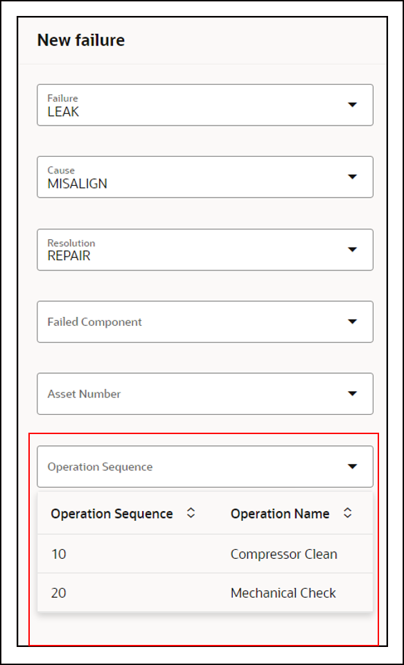

Capturing asset failures, causes, and resolutions helps organizations measure and analyze asset reliability and availability, which also helps assess maintenance effectiveness and efficiency. As part of the manage maintenance work order and the maintenance dispatch list, you can create a failure event and report a failure instance that records the failure code, cause code, resolution code, and the failed component and asset number.
In this update, you can now identify the work order operation using the new field Operation Sequence when creating a new failure instance.
New Failure Instance with Operation Sequence Selection Drop Down
Associating a specific failure instance with a work order operation makes it easier to understand what repair was done for each reported failure.
