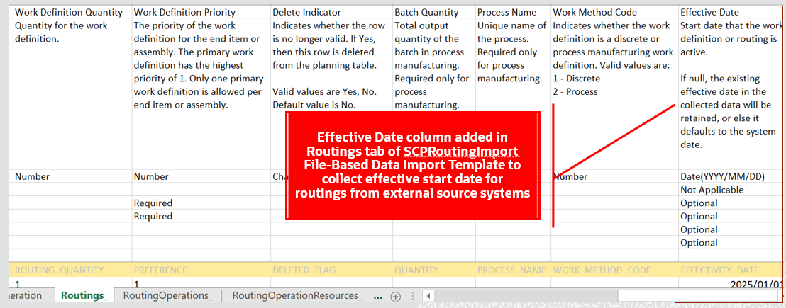

You may have routings with future effective start dates defined in your external manufacturing system of record. With this update, a new Effective Date attribute is added to the import template for Routings, ScpRoutingsImportTemplate, so that you can use the file-based data import process to upload routings with future effective start dates. Both unconstrained and constrained supply plans will honor the effective start dates. This capability enables you to flexibly define manufacturing processes in your systems as they evolve over time and have this evolution be part of the planning calculations.
Example of how you can define an effective start date for a routing in the ScpRoutingsImport file-based data import (FBDI) template:
