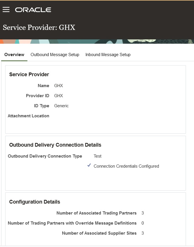

- Select Manage Collaboration Messaging Service Providers from the Tasks panel tab, search for the GHX service provider, and select Actions > Edit.
The overview tab displays the following GHX details:
- Connection type that's configured.
- Check box to indicate whether credentials are configured.
- Number of trading partners configured for GHX.
- Number of trading partners with override message definitions.
- Number of suppliers set up with GHX as the service provider.
Service Provider Overview

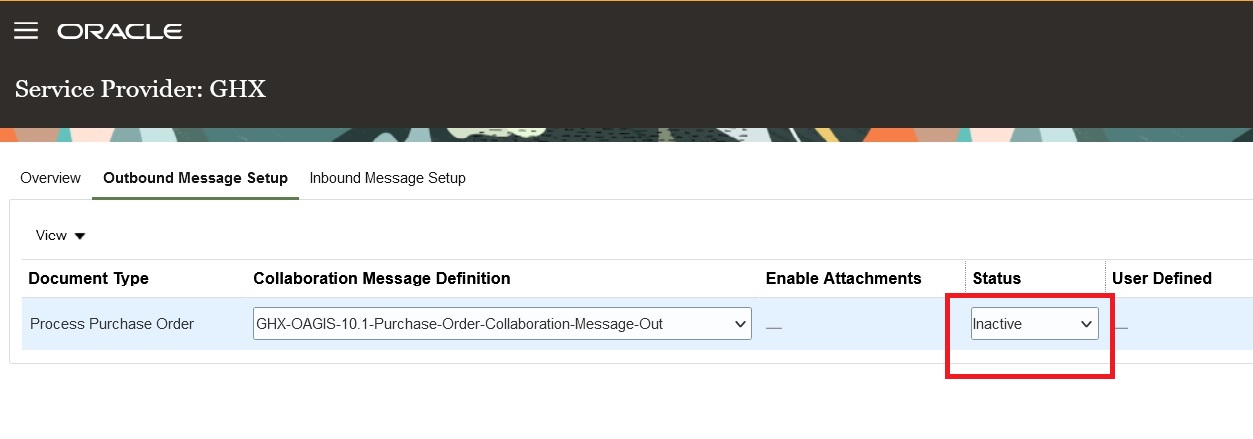

- Select the Outbound Message Setup tab to activate the outbound purchase order message, GHX-OAGIS-10.1-Purchase-Order-Collaboration-Message-Out.
The PO message will be sent as an XML message using the web service delivery method by default. Alternatively, you can conditionally send the PO as a PDF file via email to some suppliers by modifying the XSL associated with this message definition. For example, this can be done when sending bill-only orders.

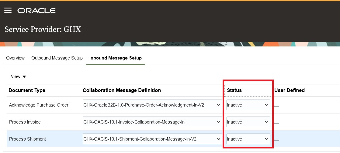

- Select the Inbound Message Setup tab to activate the messages you plan to use. There are three messages available:
- GHX-OracleB2B-1.0-Purchase-Order-Acknowledgment-In-V2
- GHX-OAGIS-10.1-Invoice-Collaboration-Message-In
- GHX-OAGIS-10.1-Shipment-Collaboration-Message-In-V2

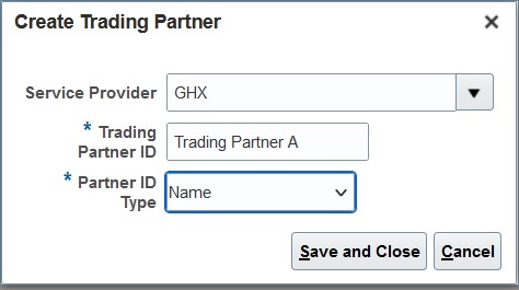

Create Trading Partners
After completing the service provider setup, create your trading partners.
- Select Manage B2B Trading Partners on the Tasks panel tab.
- On the Manage B2B Trading Partners page, select Actions > Create, and add your trading partners.
- Select GHX as the service provider.
Create a Trading Partner

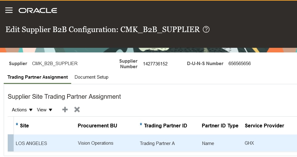

Associate Trading Partners with Your Suppliers
Next, associate the trading partners with your suppliers and select the documents you plan to exchange.
- Select Manage Supplier B2B Configuration on the Tasks panel tab and search for your suppliers.
- Select a supplier and then select Edit Supplier B2B Configuration.
- On the Edit Supplier B2B Configuration page, select the Trading Partner Assignment tab and click Actions > Add Row to add a trading partner and the GHX service provider.
Supplier Trading Partner Assignment

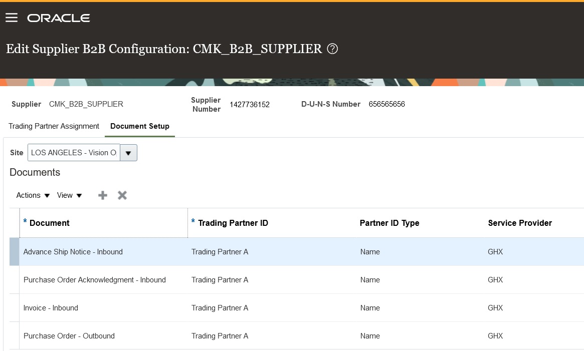

- On the Edit Supplier B2B Configuration page, select the Document Setup tab and add the documents you want to exchange with the selected supplier.
Supplier Document Setup
