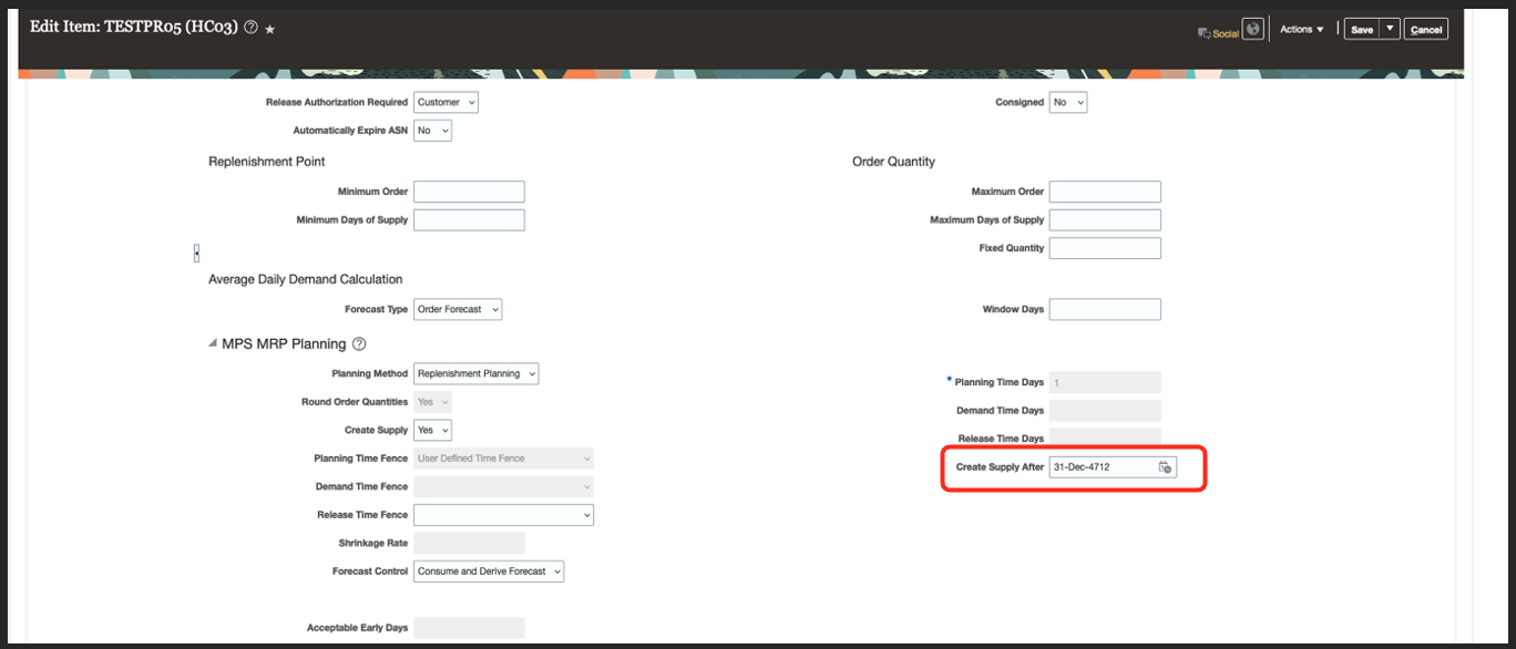

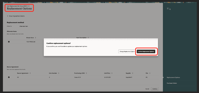

When you confirm the replacement option by selecting the alternate item, a supply hold is created for the disrupted item by populating the planning attribute Create Supply After with a future arbitrary date, if the replacement type is temporary. If the replacement type is permanent, the planning attribute Create Supply will be updated to No for the disrupted item. These updates on the planning attributes prevent further replenishment requests from getting created for the disrupted supplier and item.
Confirm Replacement Options
Planning Attributes
Planning Attributes

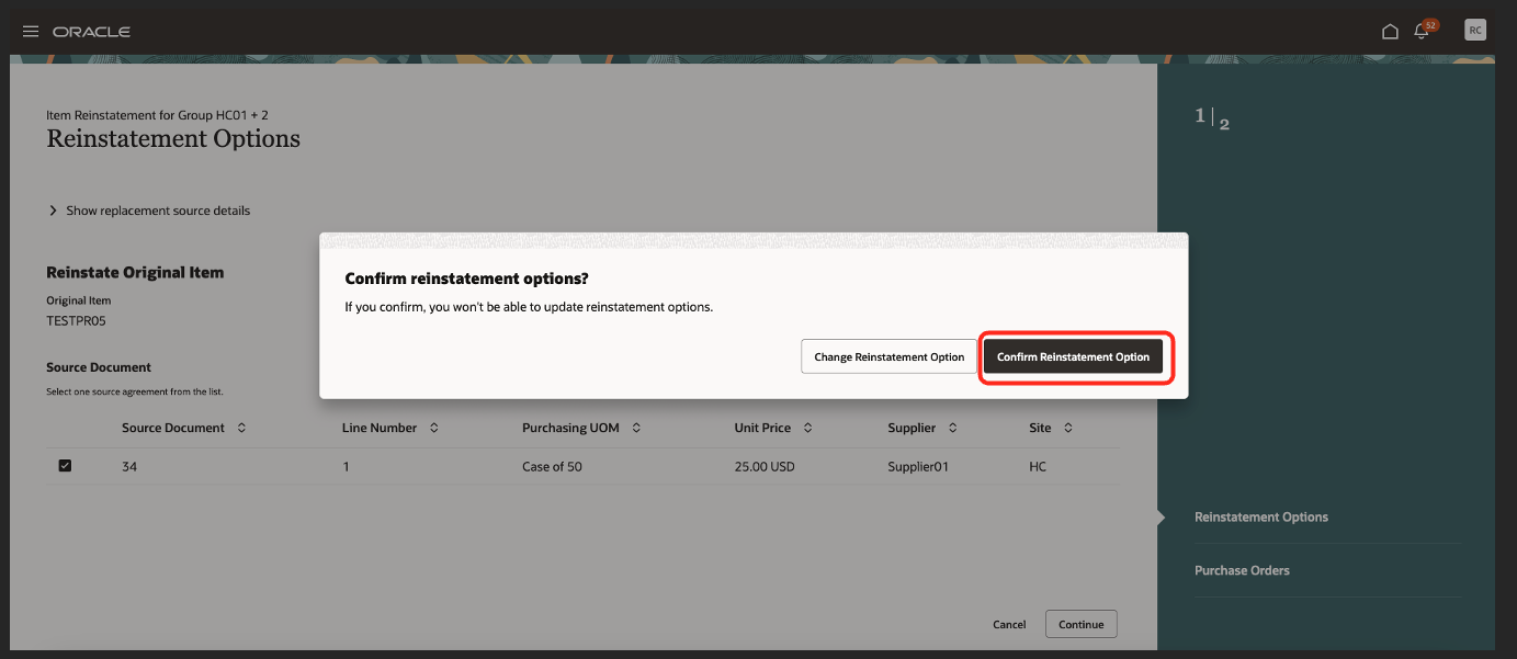

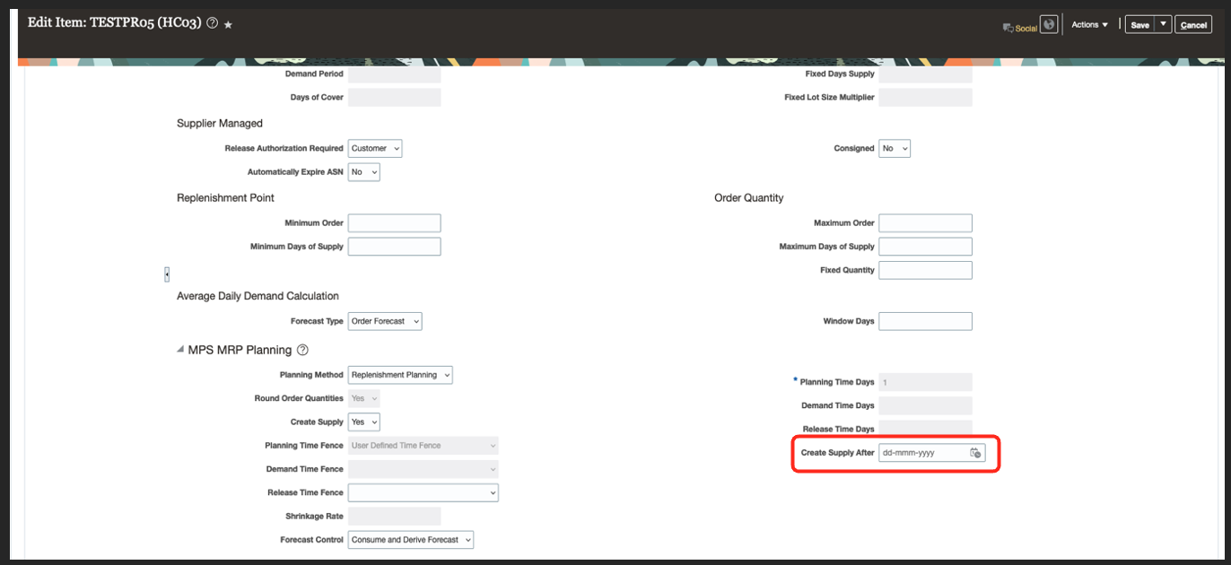

For temporary replacements, on confirming the reinstatement action, the future arbitrary date populated on the Create Supply After attribute will be removed so that new replenishment requests can start getting created for the original item. A notification is sent again informing planners that the replacement period is over and the planning attributes are reinstated.
Confirm Reinstatement Options
Reinstate Planning Attributes
