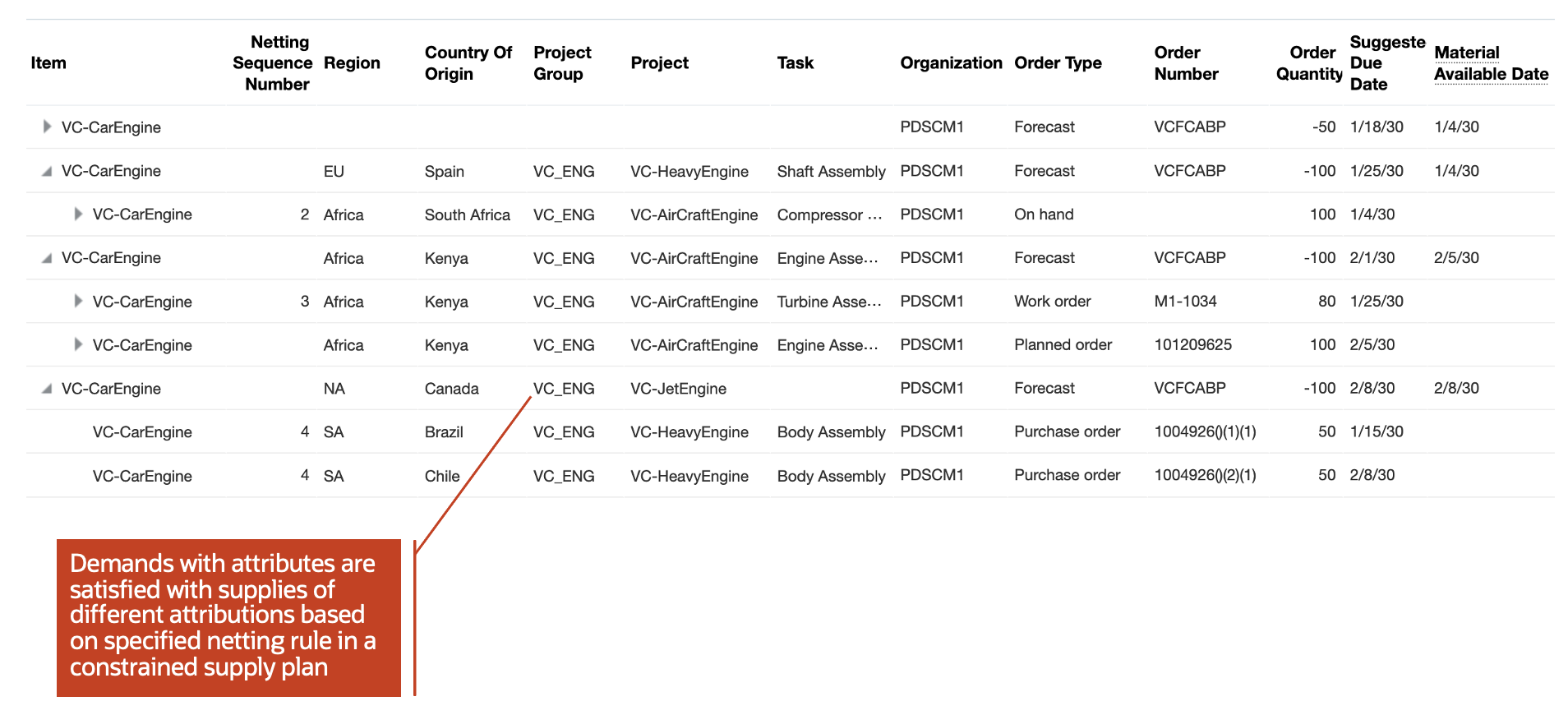

You can configure Oracle Supply Planning to consider rules that govern the supply that's eligible to meet demand based on your configured attributes on supply or demand, which is referred to as attribute-based planning. If you’re in a project-driven supply chain environment, Projects and Tasks are first order attributes that govern the processes to match supply to demand. Previously, when the attribute-based planning mode was enabled, you could run the plan only in the unconstrained mode, so the Supply Planning module wouldn’t evaluate alternate sources, components, or resources.
This update extends the ability to honor material and capacity constraints to fulfill your customer demand on-time by considering the supply to demand matching rules based on configured attributes. The constraints considered include alternate sources, components, and resources. You can now flexibly plan for your supply chain considering many layers of constraints and attribute matching rules to increase your ability to plan accurately and increase fulfillment metrics, even as the complexity of your supply chain increases.
