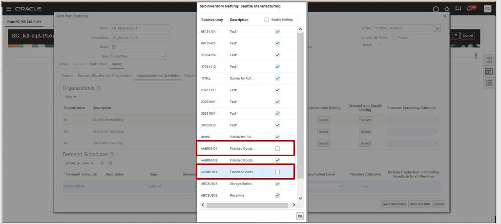

For example, you can now use the Subinventory Netting option in the Organizations and Schedules tab of the Edit Plan Options page to control the nettable status of the work order supplies.
Using the Subinventory Netting option in the Organizations and Schedules tab of the Edit Plan Options page to control the nettable status of the work order supplies.

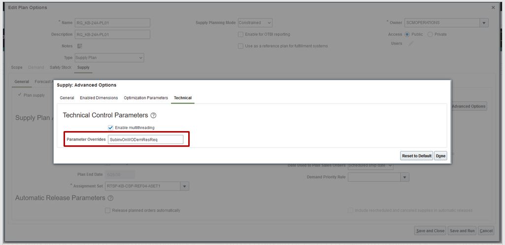

For such nonnettable work orders, the work order supply won't be considered as a valid supply, but the components and resources of that work order will be planned based on the technical parameter, such as SubinvOnWODemResReq.
The work order supply won't be considered as a valid supply, but the components and resources of that work order will be planned based on the technical parameter, such as SubinvOnWODemResReq.
