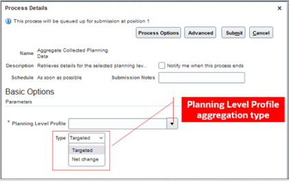

Aggregate Collected Planning Data Page with Choices for the Type Field
Previously the Aggregate Collected Planning Data scheduled process always ran in Targeted mode. This meant than when new measure data was collected, the process reaggregated all existing collected data, not just the newly collected data.
The process has been enhanced to allow the selection of Targeted or Net change mode. The default is Targeted.
Now, when the Aggregate Collected Planning Data process is run in Net change mode, it will reaggregate only measure data that has changed since the last time the process was run.
In the case of incremental collection of measure data, running the Aggregate Collected Planning Data process in Net change mode will result in shorter run times as compared to running in Targeted mode.
