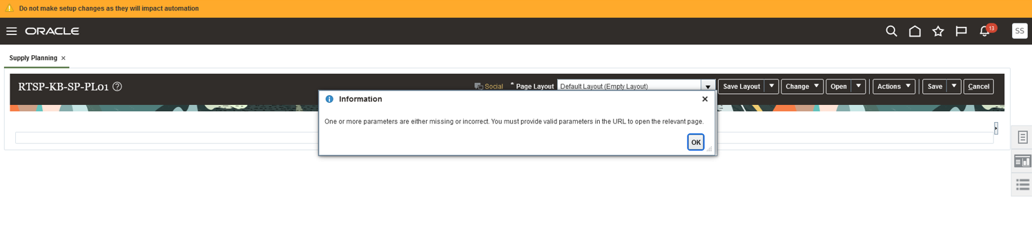

If any of the parameters are missing or incorrectly passed, the following error is displayed.
Error_Message
