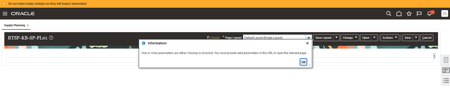

The Supplies and Demand page and the Exceptions page in their respective work areas support only the Item and Organization dimensions. However, it's important to note that this feature isn’t supported for Tiles and Tile sets within Graph sections.
If any of the parameters are missing or incorrectly passed, the following error is displayed.
