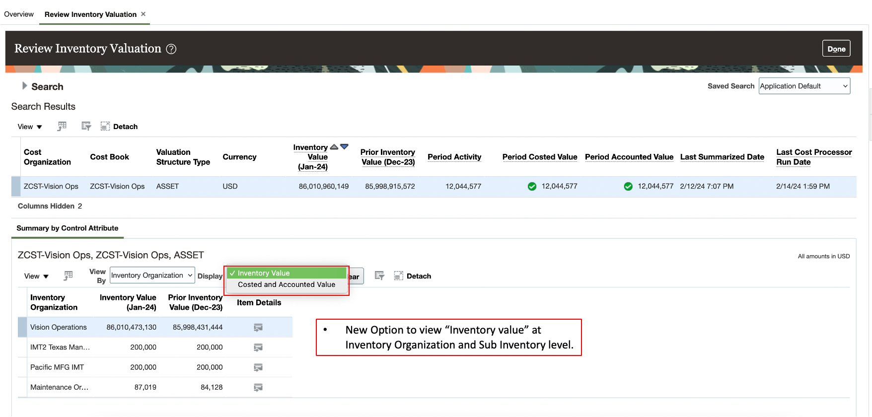

You can now review and analyze inventory value at the inventory organization and subinventory level, where the on-hand quantity and unit cost at that level is used to determine the inventory value. The Inventory infolets have been enhanced to also display the Inventory Value instead of the Costed Value.

- Prior to this update, inventory value was only displayed at the valuation unit level. Costed and accounted value was displayed when viewing valuation information by inventory organization and sub inventory. From this update, the Review Inventory Valuation page will by default display inventory value when viewing data by inventory organization and subinventory at summary level and for each individual item when you drill down to the item level details.

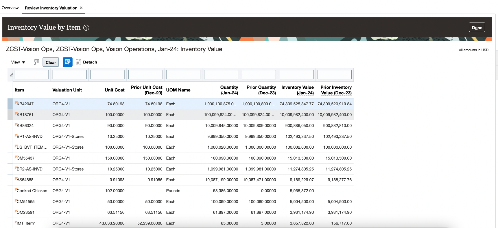

Item Level Inventory Value by Inventory Organization and Subinventory

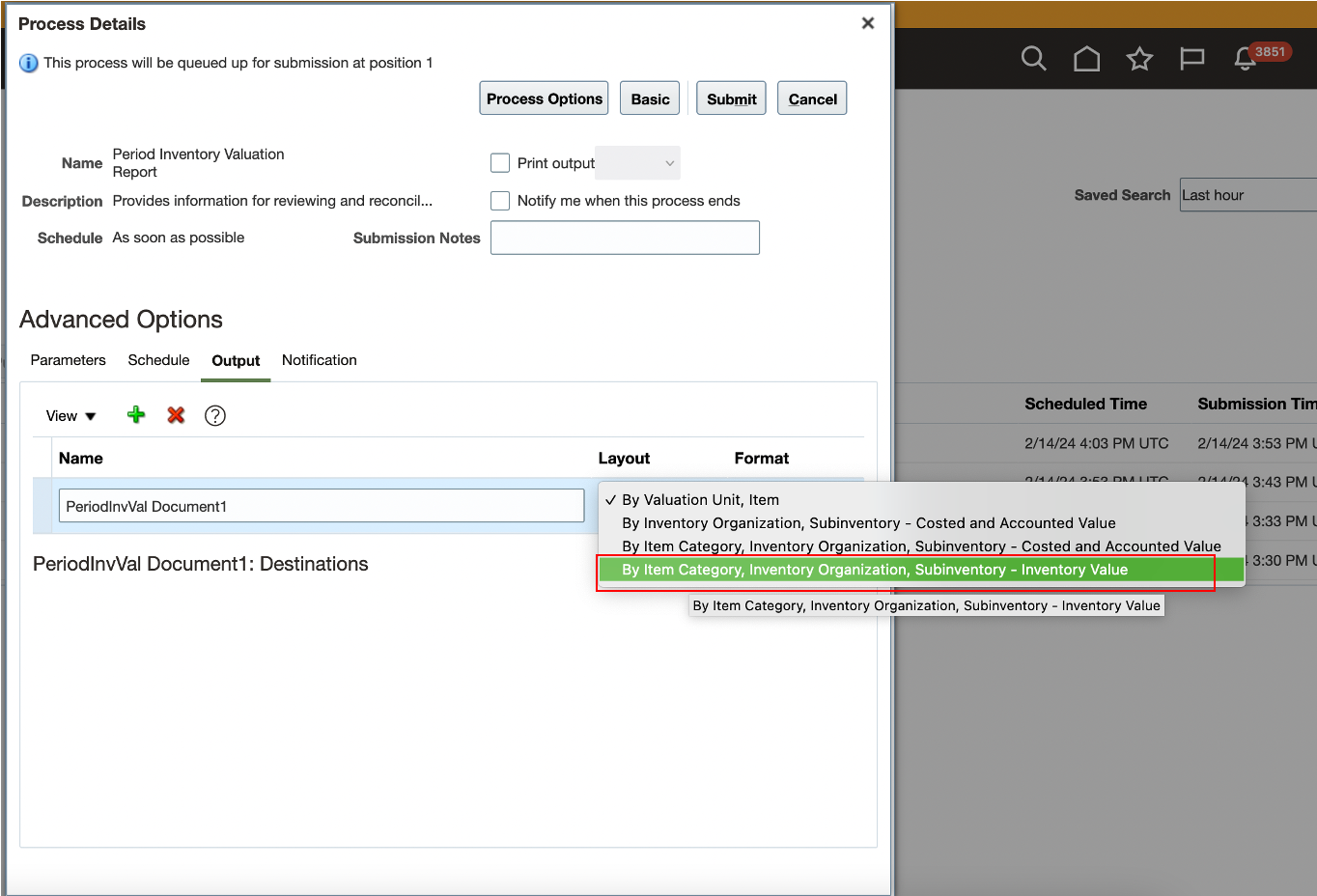

- The Period Inventory Valuation Report has also been enhanced and a new inventory valuation template has been introduced to view inventory value by item category, inventory organization, and subinventory.
New Template for Viewing Inventory Value by Item Category, Inventory Organization, Subinventory
