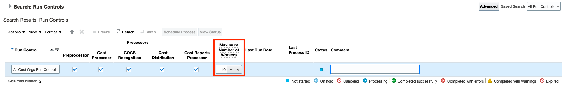

After you opt in to the feature, you will see a new column Maximum Number of Workers indicating the maximum number of subprocesses that would be used by the Create Cost Accounting Distributions process. You can enter a value between 2 and 20 to indicate that you want to use parallel processing.

To ensure that the Create Cost Accounting Distributions process doesn't consume a lot of resources that will otherwise be required for other processing elsewhere in the system, some restrictions are placed on the number of workers that will be launched by the system. Regardless of the value for maximum workers set in the run control parameter, during runtime, the system dynamically reduces the number of concurrent workers that are run based on the data volume being processed to ensure that the processing times are optimized. Currently, the threshold is set to 100,000 distribution lines and a maximum of 20 workers.
The table shows how the system decides on the number of workers dynamically during processing.
| Cost Layers | Maximum Number of Workers |
Actual Number of Subprocesses Launched (including the parent process) |
| 1000 | 10 | 1 |
| 100,000 | 10 | 1 |
| 400,000 | 10 | 4* |
| 1,000,000 | 10 | 10* |
| 2,000,000 | 10 | 10* |
* - Actual subprocesses may vary slightly from the number indicated based on actual volume and mix of transactions processed.
