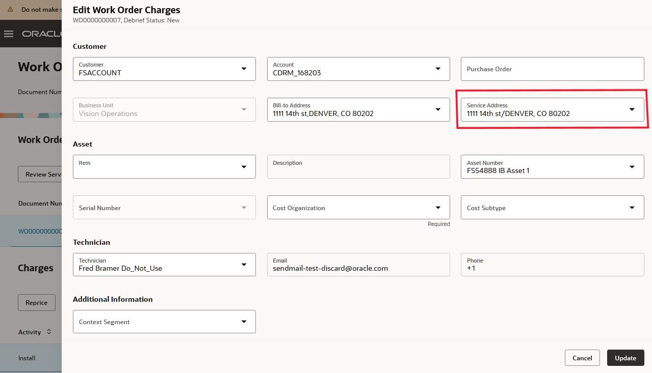

The Redwood Edit Work Order Charges page now captures the service address in the debrief header. The service address defaults from the associated service work order, but you can select any one of the customer's ship-to addresses to use as the service address. Service Logistics uses the service address to calculate sales taxes when pricing field service charges, so changing the service address results in repricing of the charge lines. When you post the charge lines, the sales order ship-to address is populated with this service address so that Accounts Receivable can accurately re-calculate the sales taxes. Charge lines are also repriced when the asset on debrief headers is updated as it may have a different subscription coverage.
Edit Work Order Charges Page with Service Address
