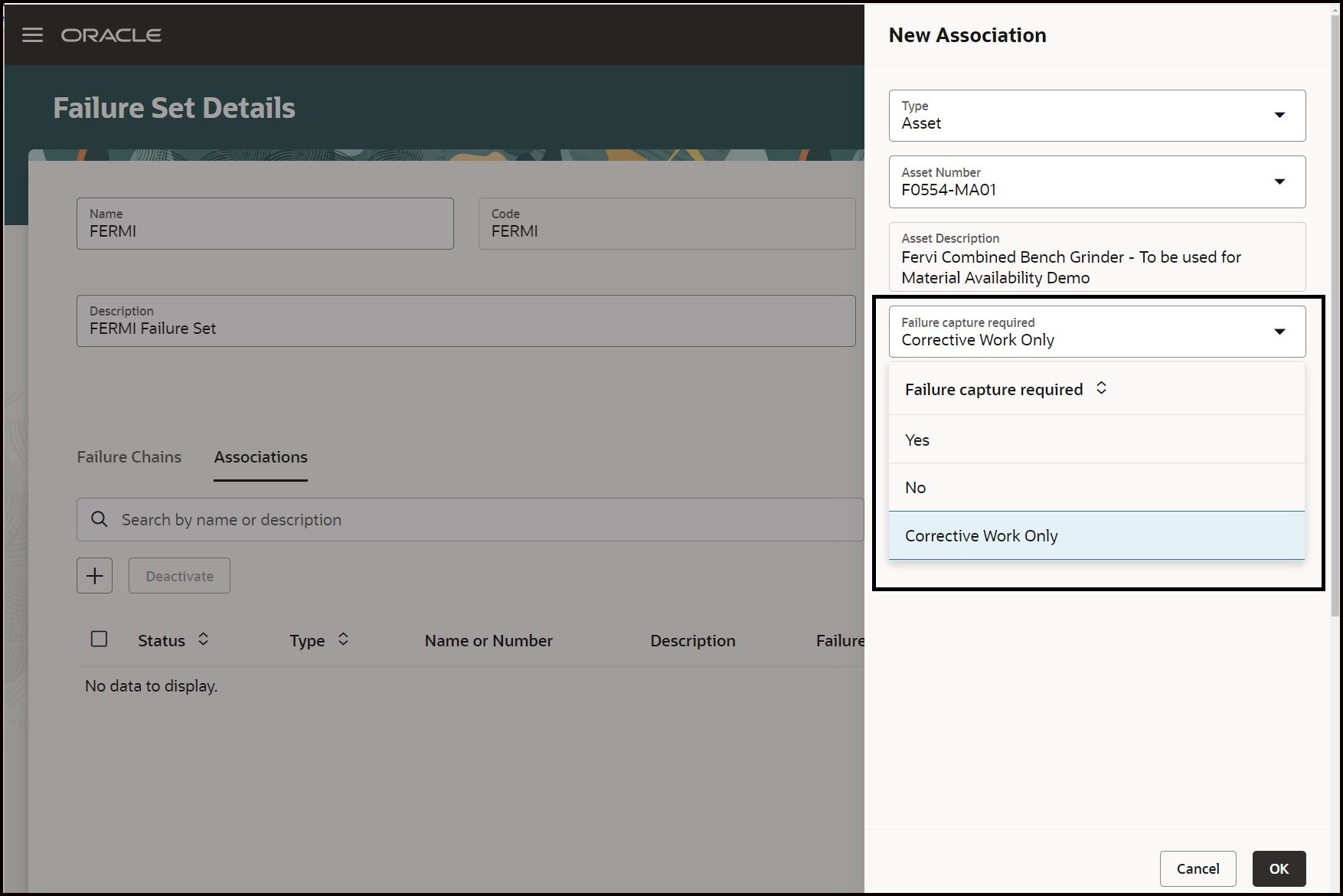

On the Failure Set Details page, you can select any of these options:
- Failure Capture Required - Yes: When you select Yes, your users must capture asset failure before completing a work order that's associated with a relevant item, item category, or asset.
- Failure Capture Required - No: When you select No, it's optional for your users to capture asset failure before completing a work order that's associated with a relevant item, item category, or asset.
- Failure Capture Required: Corrective Work Only: When you select this option, your users must capture asset failure before completing a Corrective work order that's associated with a relevant item, item category, or asset. Failure capture is optional for a Preventive work order with a similar association. For instance, if an asset is associated with a Preventive work order, a user can complete the work order without entering the failure data. But, if the same asset is associated with a Corrective work order, the user will need to enter the capture the failure data.
Here's a screenshot of the Failure Set Details page that highlights Failure Capture options you can select when creating a new association:
Screenshot of the Failure Set Details Page that Highlights Failure Capture Options You Can Select When Creating a New Association
