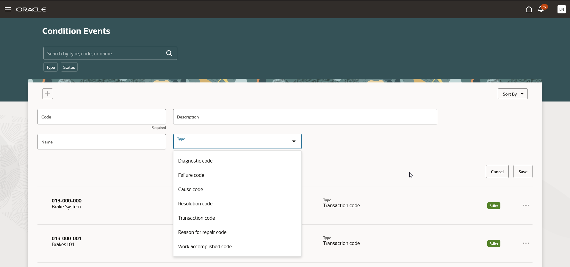

The new Condition Events Redwood page shows all the active and inactive condition events along with their code, name, description, and type.
On this Redwood page, you can create, edit, and deactivate condition event codes. All the fields except the condition event code, which is a unique identifier, are editable. After you create a condition event code, it's automatically synchronized with IoT using a REST service.
Here's a screenshot of the Condition Events Redwood page that shows the types of condition event codes you can select. They're Diagnostic code, Failure code, Cause code, Resolution code, Transaction Code, Reason for repair code, and Work accomplished code.
The Condition Events Redwood Page Shows Types of Condition Event CodesA
